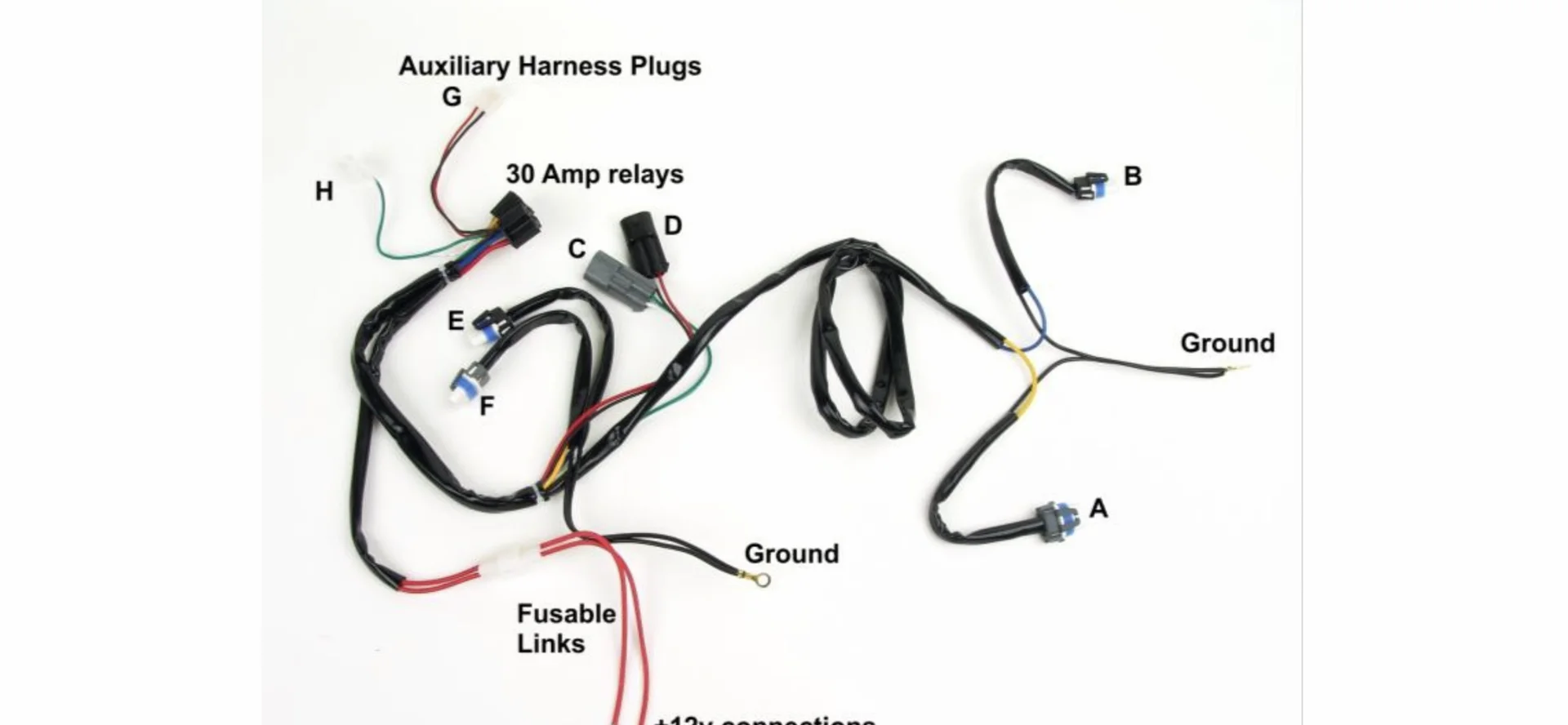

In this case though, I think my low voltage triggers are coming from the slee harness connectors g (low beams) and h (hi beams).
This is the main slee harness.

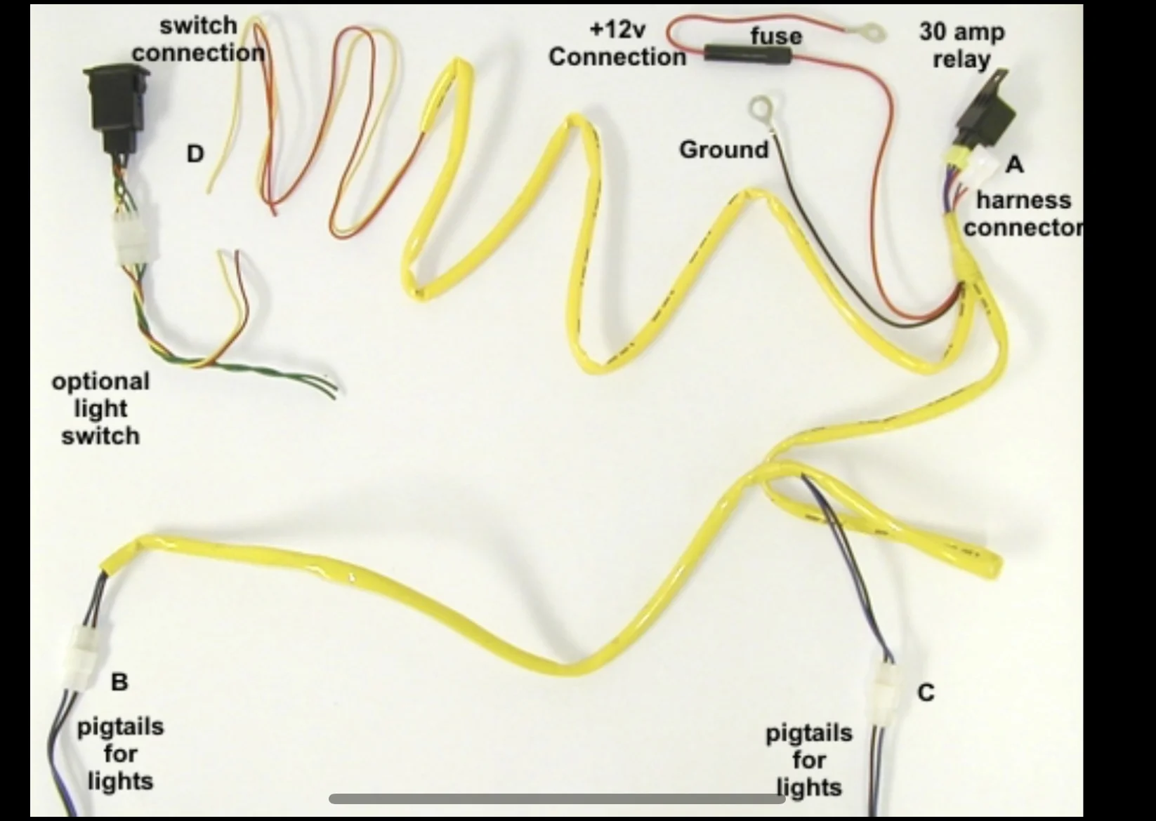

This is the aux slee harness. Basically need to replicate connector A on the new harness.
The harness is a a two part upgrade, the first supplies currently directly from the battery to the hi and low beam bulbs, supposedly improving headlight performance.
The second aux harness(es) jump off the main harness and allow your auxiliary lights to be switch with you hi and low beams.
-the low beams also trigger my fog lights so they can be on whenever the lows are on.
-the second powers my driving lights so the turn on/off when the hi beams are on.
Both have independent switches on the dash too.

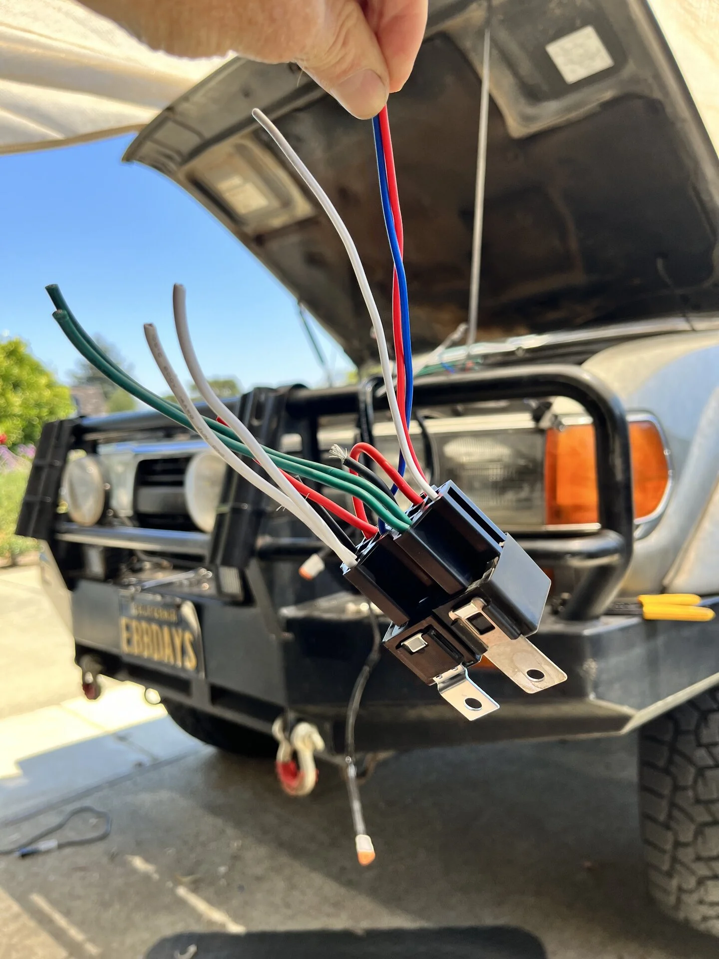

Meh. Turns out easier solution was to bypass the Hella harness altogether. See ya!
