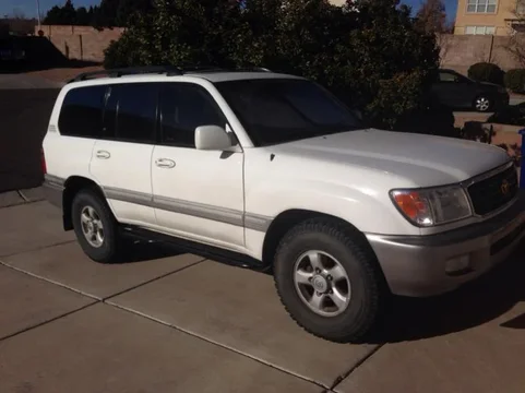

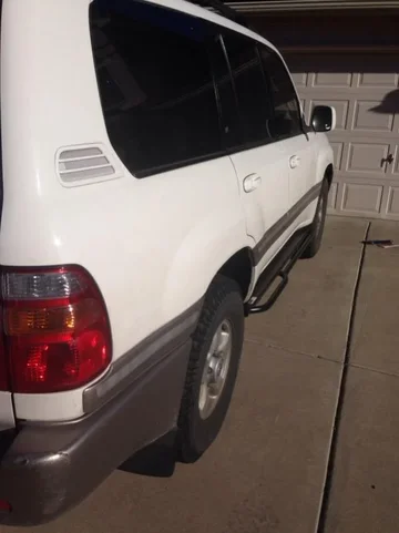

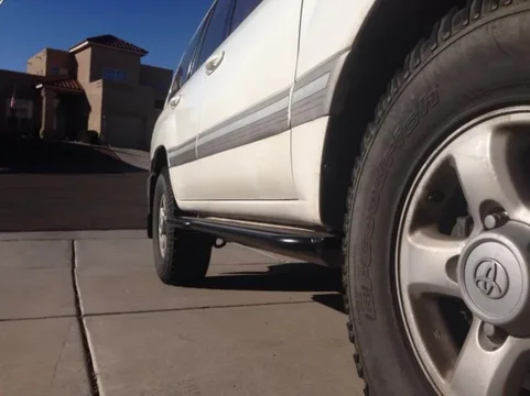

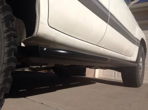

I need to take a few photos. The job turned out to be more difficult that I had planned because the quality control on the mounting u-bolts that MT sent me was not good. I had to chase the threads on 3 of the 6 U-bolts with a die in order to get the nuts on them. Stupid threads turned out to be 7/16-20, which I don't have any SAE taps or dies. Off to Harbor freight to get a marginal set. One of the 12 nuts they sent me needed to be tapped so it would thread onto the u-bolts as well. I still need to do a little work on the brake lines that had to be unclipped so they don't rub on the u-bolts they cross over.
Huge thanks to Evan for coming all the way from Tijeras to my house to help me get them safely mounted.
Photos
Marc -
They look great and will be excellent protection on the trail. I was very impressed with the quality of the sliders themselves, and not so impressed with the hardware. As you mentioned, that greatly increased the install time.
