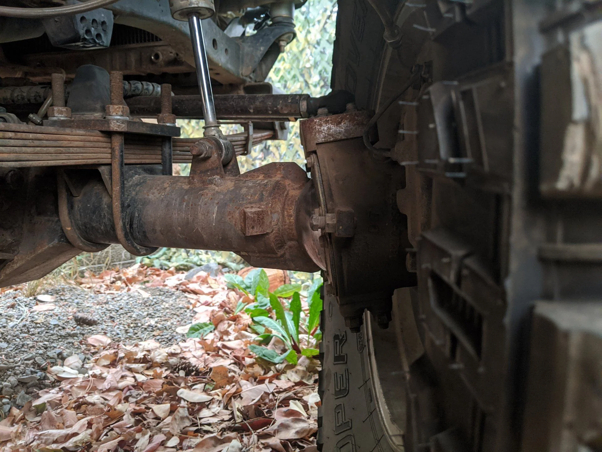

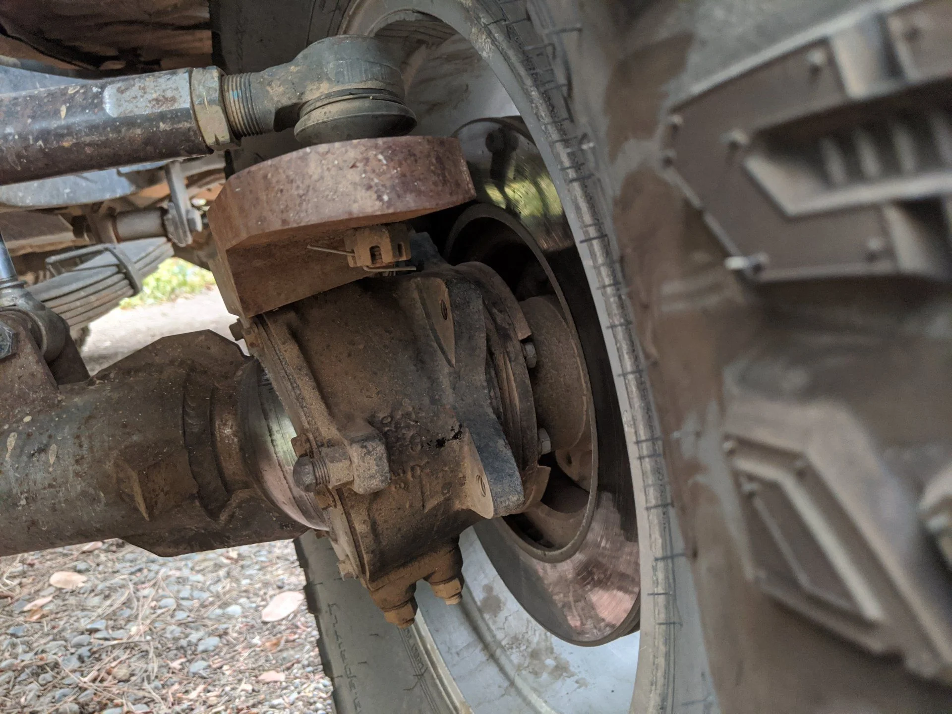

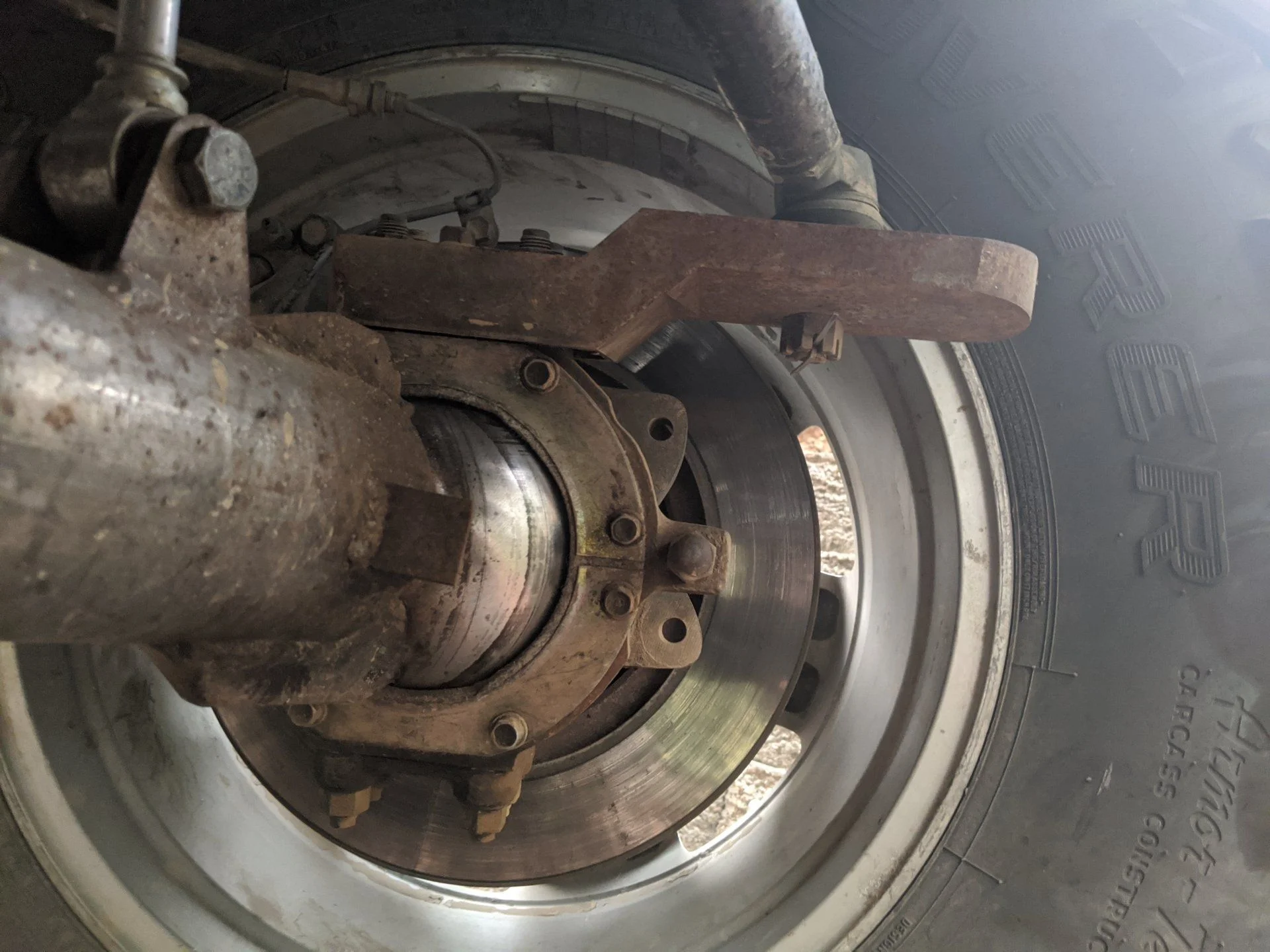

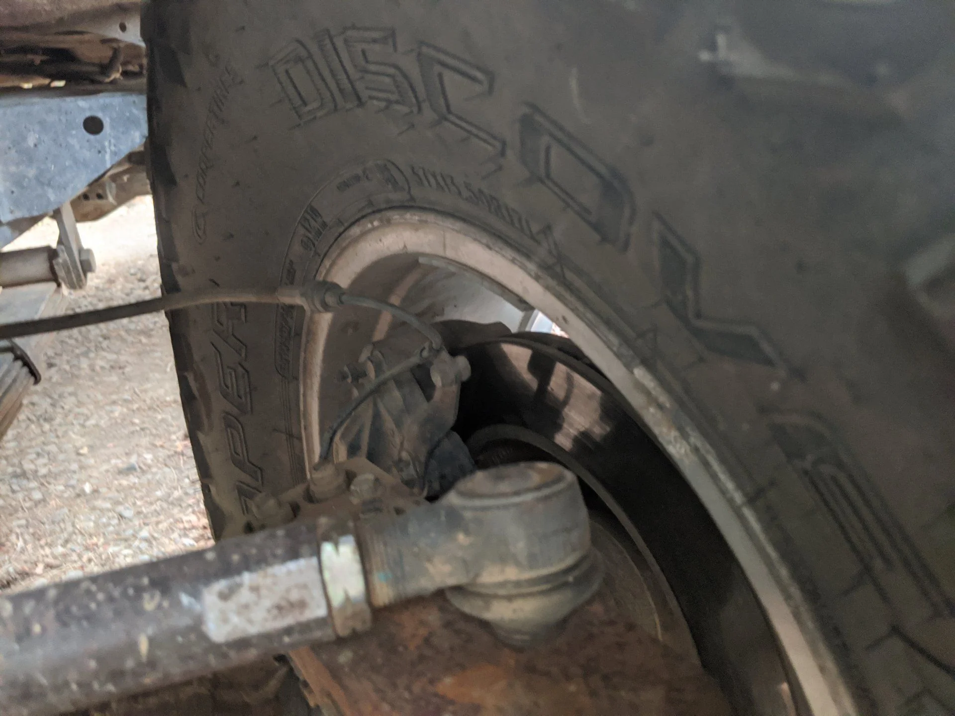

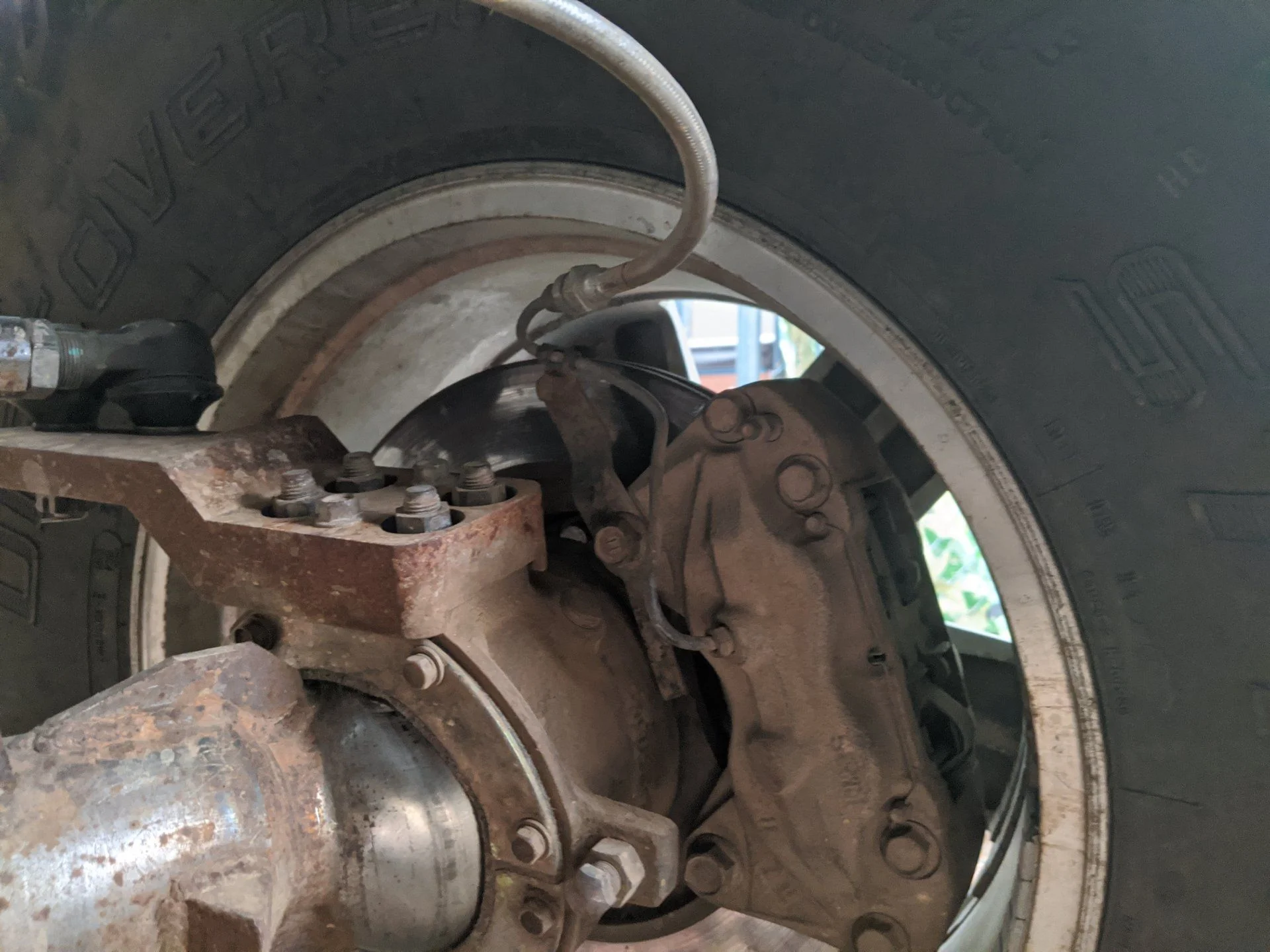

Pics for the sake of later.
FROR brake kit. FROR hysteer arms. 3rd gen 4runner 12" rotor/caliper. 17" fjc alloy.
