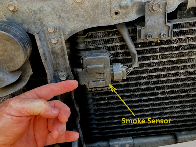

It’s right in the front of the radiator, you can just unplug it, I removed mine to investigate it, but you can leave it mounted.
Unfortunately I don’t have the LX anymore, more unrelated problems occurred. Here is a picture of the module. It’s on the outer side of
radiator.
It is in front of the condenser.
It is mounted right in front of the Transmission oil cooler. I'll post a pic later.
The transmission Oil Cooler is the outermost cooler, then the A/C Condenser and lastly the Radiator.
The purpose of the Smoke Sensor (which is an Air Quality Sensor) is to detect smoke/smog/poor air quality and then switch the HVAC system from Outside Air (if currently selected) to Recirculate.
