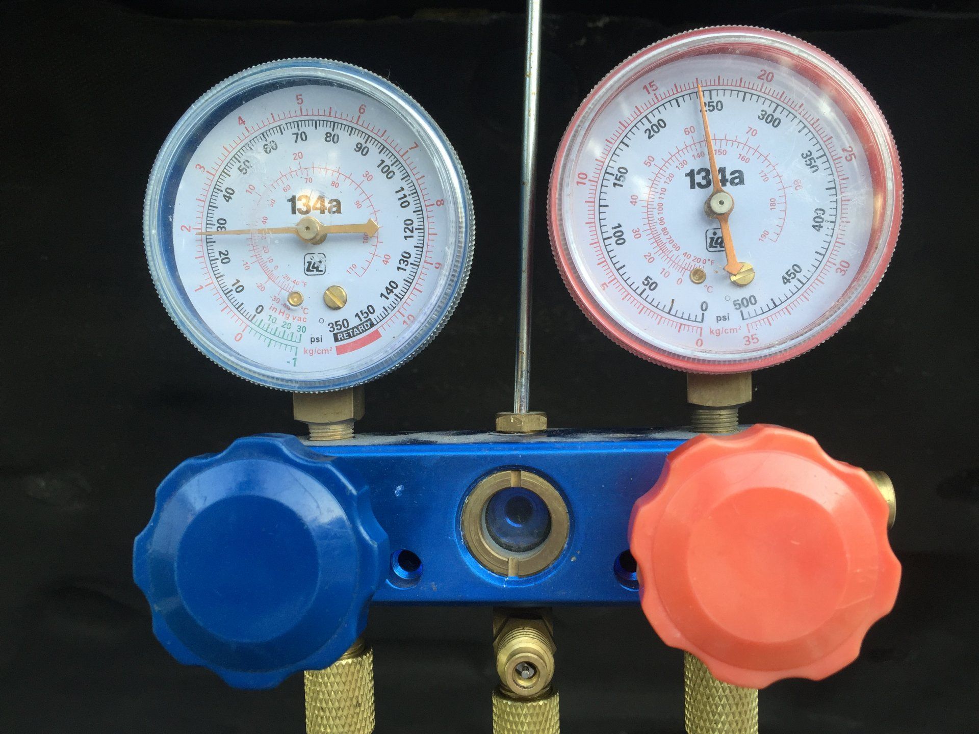

Take it to a shop and they will put gauges on it - need to know charge level.
AC has a high pressure side so unless you know what your doing it is job for a Technician.
I did when it was all dead. Coolant volume/pressure was not the issue. They wanted $160 for further diagnosis and keep it for a few days. Needed vehicle...
