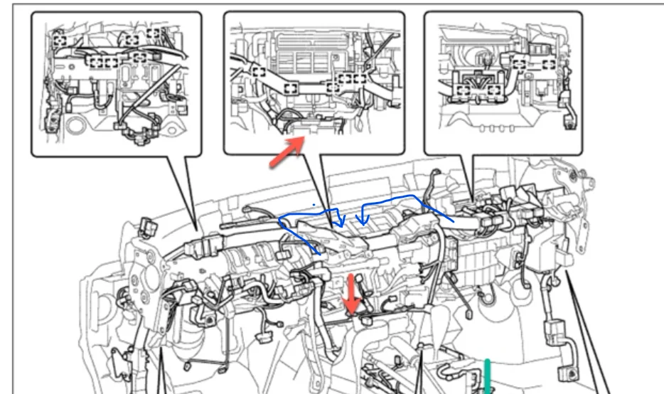

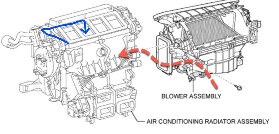

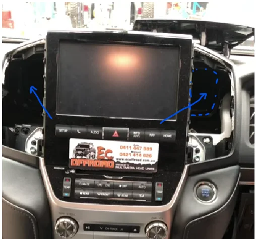

Alternatively I am considering removing a center vent (or both) and put a hose to foam via the top. Below some info I have found which suggests that maybe feasible. Has anybody tried it this way? Any thoughts?
1) Removing the vents
Per videos of opening up the dash seems to be 1) pop off the speaker grill and set aside and then 2) from the top unclip each vent and pull them out. Next you have access to the ducts (recessed about 6 inch or so) which you probably can reach with a flexible hose and access the evaporator box and coil from the top (going in turning left and then down...).
2) Evaporator Access
Looks like the inner two "ports" are the once ducted to the center vents and provide access from the top, with the ability to foam the evaporator using a small diameter flexible hose.

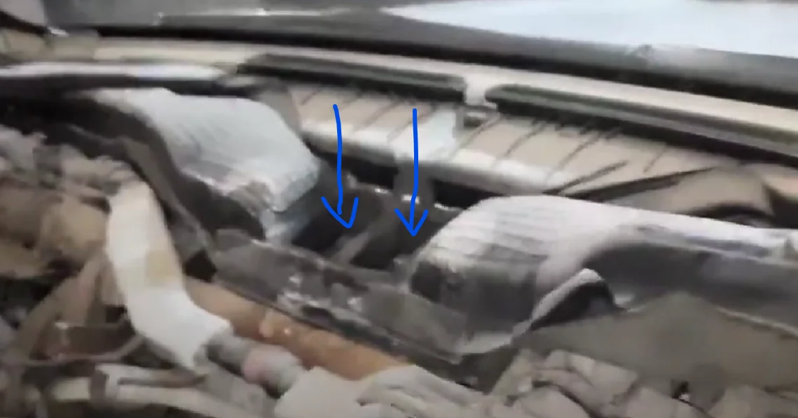

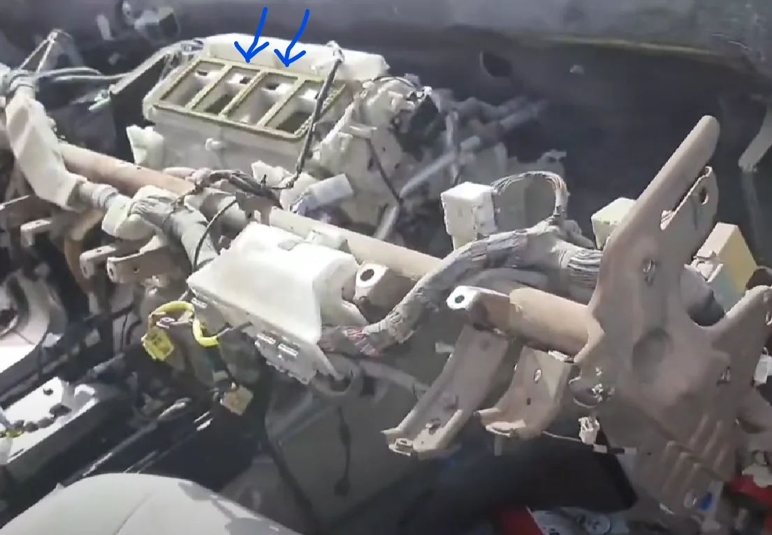

Next two snapshots are from a video removing the entire dash and evaporator box.
Looks like those ports in the evaporator box have flaps (black) which need to be in the open position for this. I would think they are open on my vehicle as i always get AC out of the center vents in auto mode. Otherwise I may manually control and put the fan in the lowest position. It can also be that the dials at the vent close of these ducts and there are no flaps in the evaporator box at the position shown. Anybody who knows?

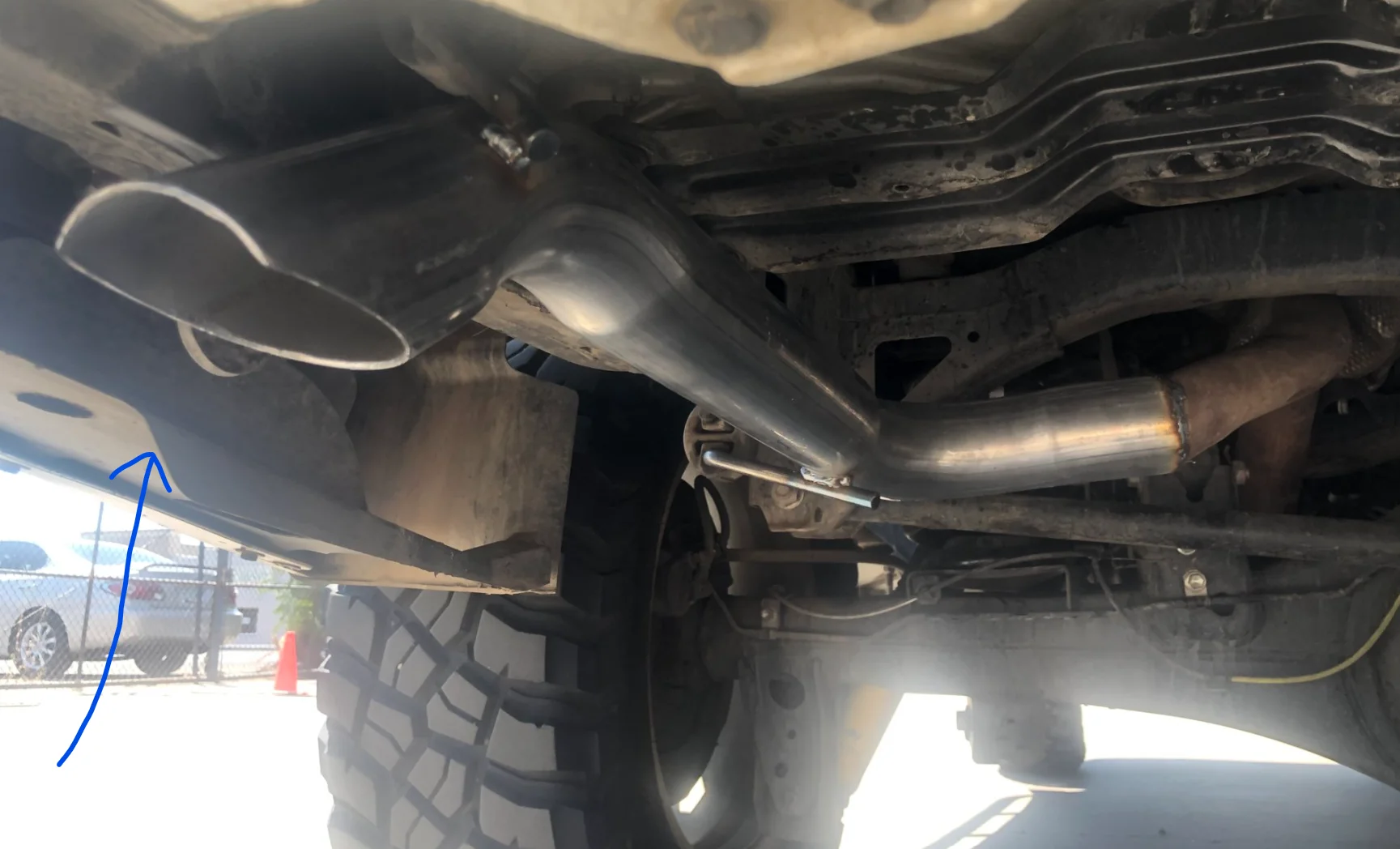

I understand you can apply foam through the rear evaporator drain which is accessible behind the bumper, by removing the mudflap and adjacent panel driver side.
Plastic black panel to be removed for access to the drain (picture of another LC200). Maybe able to leave the mudflap on.
