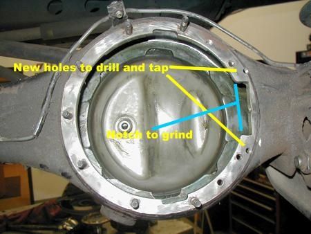

You can trim the housing. You need elocker and axle shafts. I've posted pic of what to trim and will post it later tonight.
Here's the pic of what to trim

That picture is for retrofitting an 8" locker, not the 9.5". The 9.5" requires very minor grinding compared to the 8". You'll need a few longer studs and the passenger side axle shaft... the shaft could probably be sourced cheap enough through a salvage yard.
