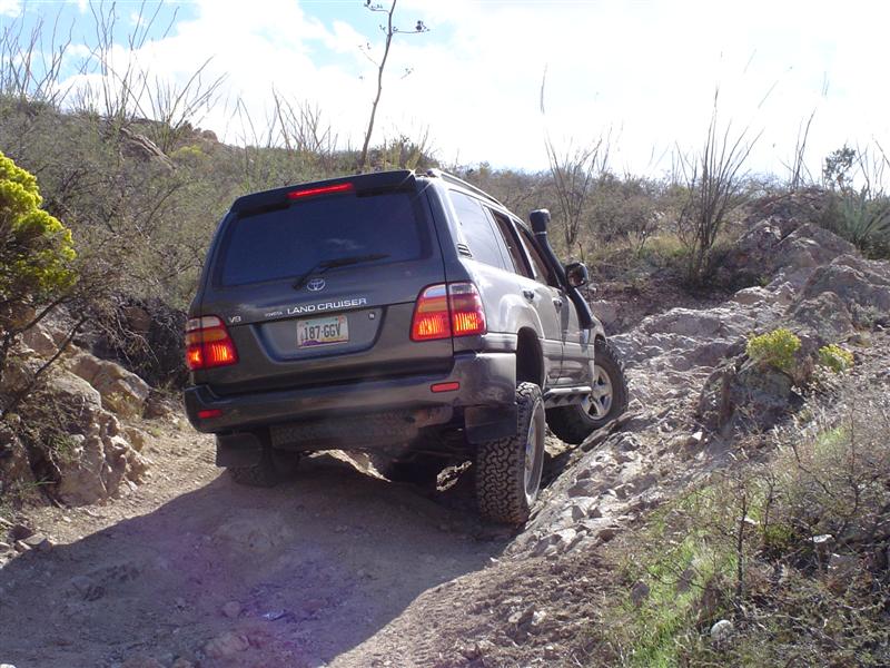

Yes....though at only 2" lift, with or without wheel spacers, on compression and turned sharply (common off-road) the tire's top will catch the top of the body (the wheelwell) and it can dent it....pull it away from the rest of the truck as the tire turns forward snagging the metal. Here was a pic I found quickly...I'm sure I have better. Even at 2.75" and the fact I'm not fully compressed front passenger...look how close the wheel is to dragging the fender with it.
So you'll see....at 2" and fully compressed you risk damage to that well.
Thanks, this is what I was looking for. I thought 2 inches was the 'reasonable' upper limit for the front suspension. I guess another .75 is necessary to keep the tire out of the sheetmetal?
