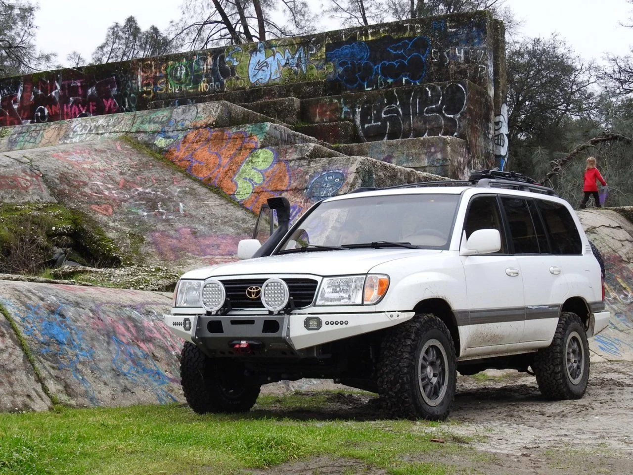

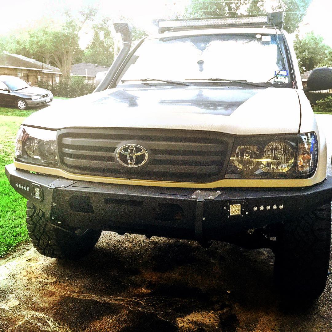

'98 to 06+ headlight/grill conversion complete w/a couple pics
Do I have to upgrade to the newer one piece lights if I just want the 06+ grill? I was hoping to just replace the old one piece sub panel trim with the new bracket and 2 piece sub panel trims under my old lights with the new taller grill. Will the new two piece sub panels work under my old 2 piece lights?
I think they will but it’s better if you change to the 1pc headlight as well. They won’t match if you will only replace the grille, but that’s just my opinion.
Is that a arb bumper?

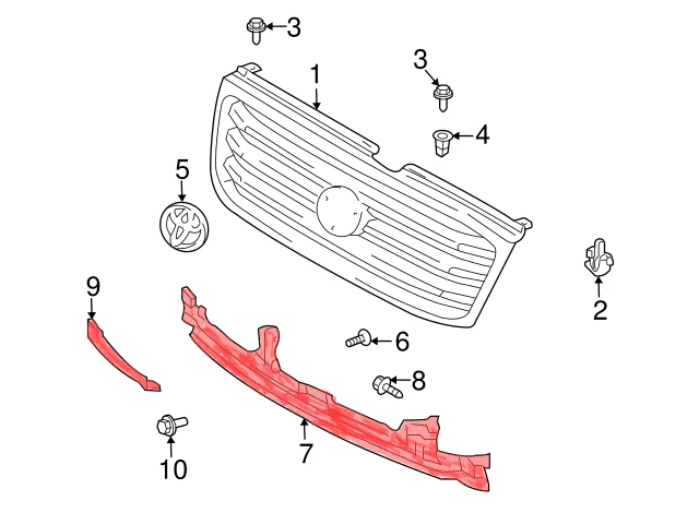

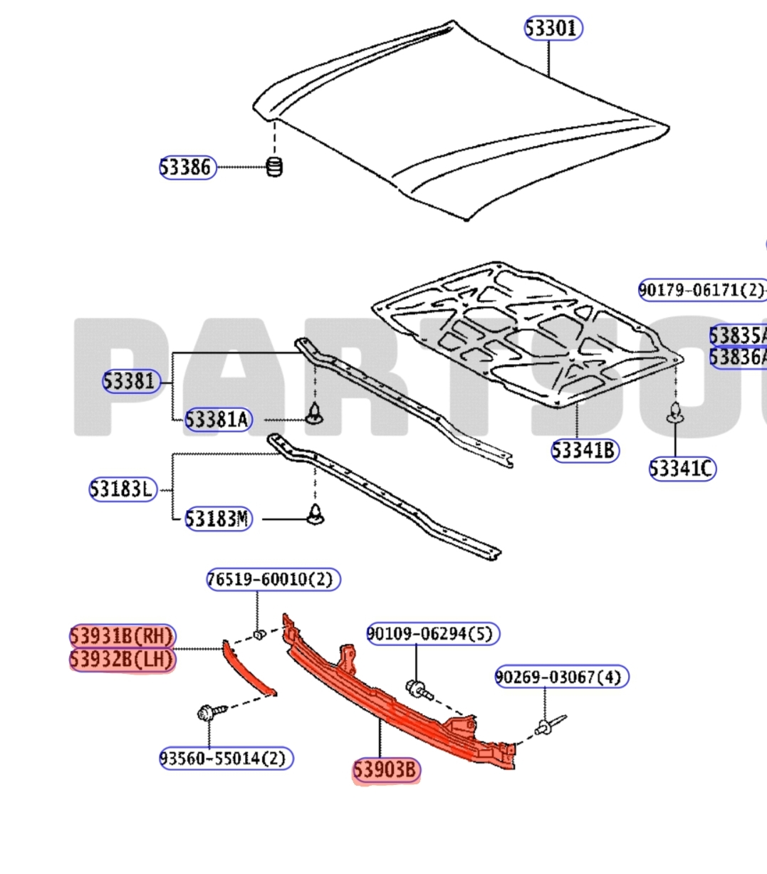

Does anyone have info on what all parts are needed to facelift a 2002 land cruiser to the 2003 - 2005 grill?
I know that the two sub assembly panels are needed for below the lights, but will I need to order the long mounting bracket that goes behind them as well, or will the 2 panels that go under the lights mount to my existing 2002 bracket?
(Parts being referenced are highlighted in red)

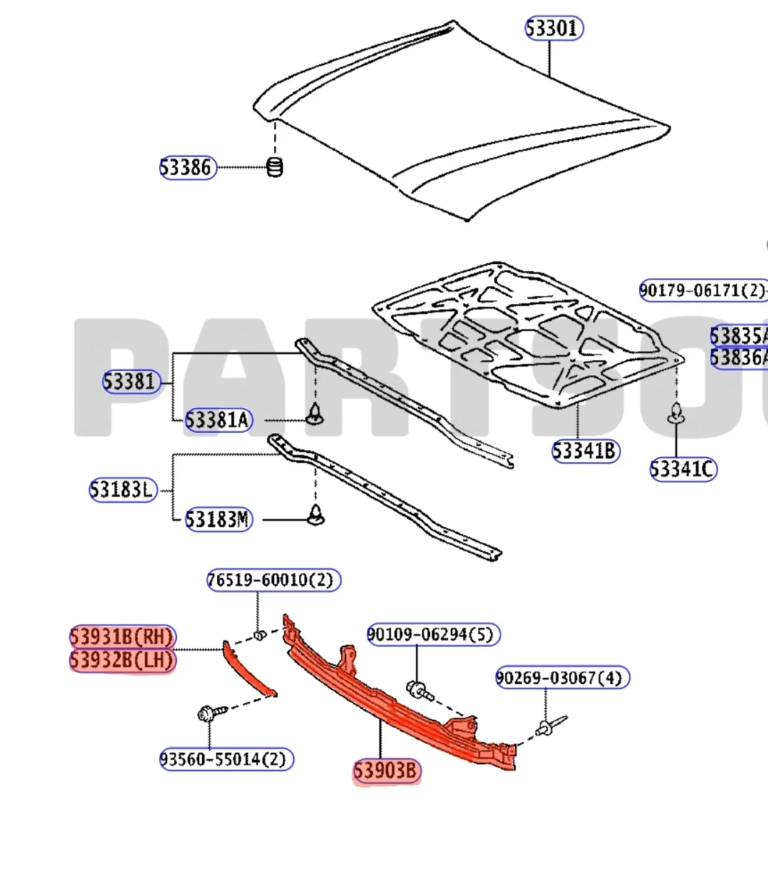

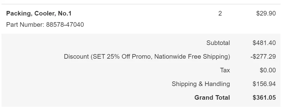

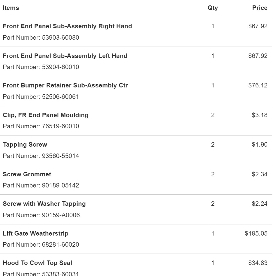

Also - Serra Toyota of Decatur's sale can't be beat - blew partsouq out of the water. I just ordered all the items needed other than the grille and headlight housings (already have) - here's how that priced out:
I've had this link bookmarked for quite some time, but it only gives details on the 2006+ facelift.
The only info it provides about a '03 - '05 facelift is:
"If you have a 2002 or older you could easily update to the 2003 grill and keep your existing headlamps." and nothing else.
I'm trying to figure out the parts list needed for going to the 03 - 05 grill.
