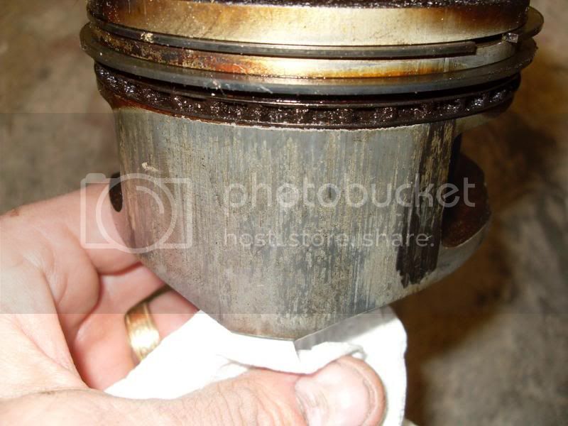

Sorry for the long delay, but I was involved in a serious motorcycle accident on my way to work on 1/25/10 and have been trying to heal. The noise was caused by 2 faulty pistons, here is the worst one.
Most likely the previous owner overheated the thing and didn't know he/she had damaged the pistons. After having the heads and gaskets replaced for $2,500, the motor started making noises after they resumed driving it and they decided to cut their losses and trade it in. The used car lot I bought it from said they purchased at an auction and couldn't hear the engine noise until after they bought it. I got a screaming deal on the thing, but since I'm laid up for a while, its gonna sit until I'm well enough to get back on it.
Considering the cost of parts for the 5vz engine, I think I will look for a used engine to install and keep the rebuilt heads as spares or sell the rebuilt heads to recoup some $.

Randy...sorry to hear about the accident. Hope all is mending well. Somebody cut you off? That used to p%$& me off as some car driver could be looking square at you and not see ya and pull out...
At any rate thanks for posting up the pic of that ugly looking slug. Sort of makes me worry about my engine as I think it was heated up when the previous owner had a small garage do the timing belt and perhaps failed to refill and bleed the coolant or something.
Did this engine just tick or did it use any oil, foul plugs in the 2 bad holes??
Thanks also for the comment that the parts to rebuild $ would be better spent buying a used engine. Too much to even do a cheap rebuild on replacing 2 pistons, rings and sleeves/liner or can a guy replace them in the 5vz?

Sorry to hear about your accident. I hope you are doing better. Also, thanks for posting the pic and your findings. It does make me worry about my ticking noise now. I hope it's nothing like that!

mine was a very loud tick/light knock sound and would go away if I put it in gear and applied a load. These complicated little motors are very well built, I doubt yours is hurt this bad. You will really need to pin down the source/general area of the noise to properly diagnose.
I was bummed to find out a quality gasket set is almost $500 alone, plus TTY head bolts are $125. Now add the cost of boring the block, new pistons and rings, machining the deck and having the heads checked out now pushes the cost into the $1,500+ range. A rebuilt long block will probably be in the $2,000 range when all is said and done. A used motor is about $1,000.
Don't panic, these are very bomb proof motors that will live a very long life unless they are completely neglected. Your motor is fine, just try to get to the bottom of the source and fix it if its an issue. Most times its either nothing or a minor issue. Keep us posted.
