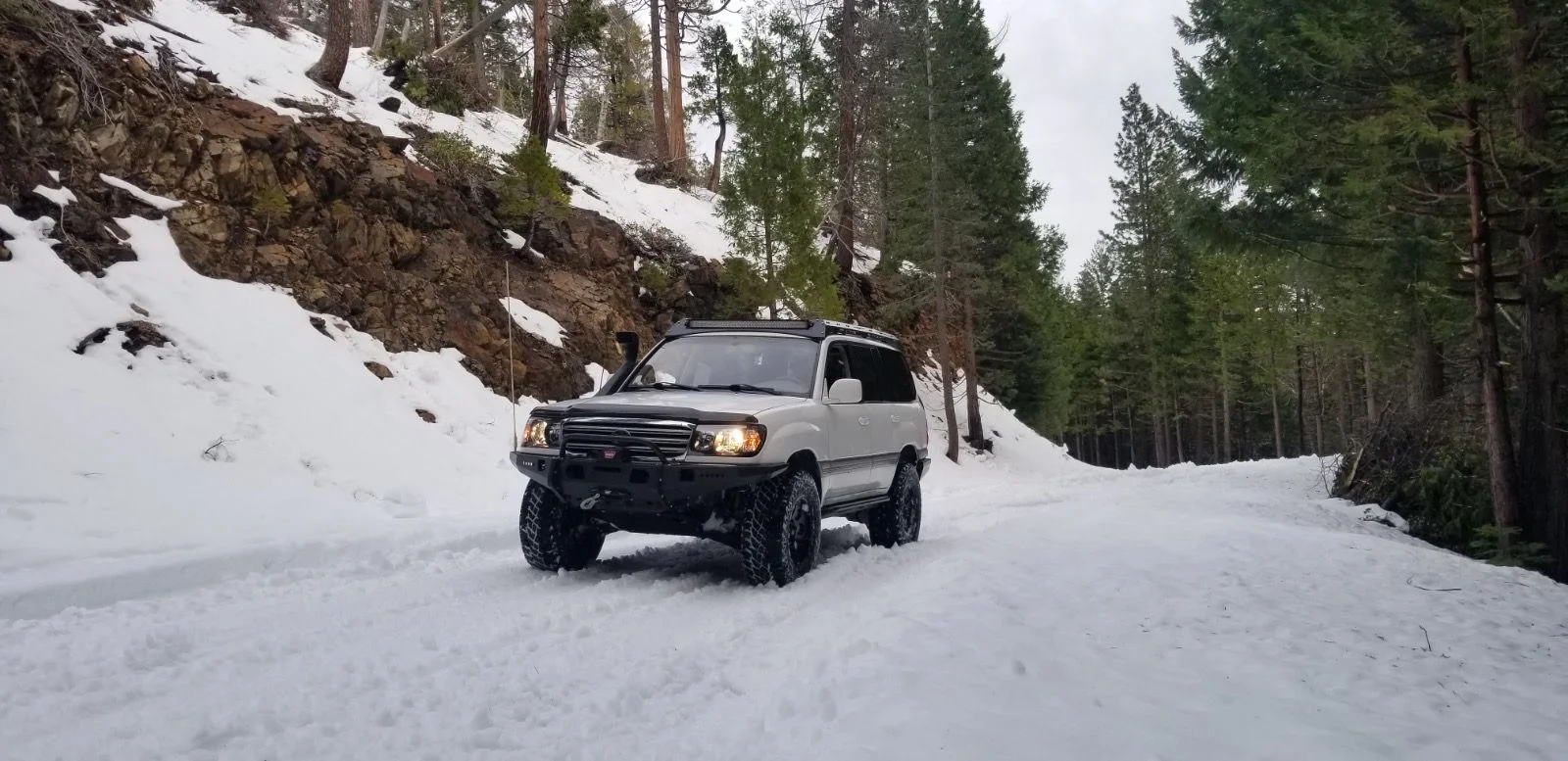

I have! My 1999 LandCruiser was a bone-stock basically bone stock "mall mom" car when I bought it a few years ago, EXCEPT it had Denso Headlights installed. I understand it had been in a minor fender bender and these are just what was randomly installed by the bodyshop, probably because of their price. Since then I've built the truck into an expedition-worthy family adventuremobile. But the lighting, even with expensive halogen bulbs was always insufficient and too widely diffused for my tastes.
I ended up installing LEDs into the Low, High, and marker light positions. The big LED bulbs just barely fit and required some modifications, plus larger rubber bulb caps/dust covers. Here's what I ended up buying and installing:
Low Beams LED bulbs
High Beam LED bulbs
Marker bulbs
Dust Covers
Having said all that, and spent about $200 on LED bulbs, and after also experimenting extensively with HID lighting set ups in my Densos, I remain dissatisfied with my lighting! In addition to all this, there are some fitment issues on the driver's side between the headlight housing and the battery -- LED lights are simply really really big where they stick out of the back of your headlights, and I did do some modification to make it all fit..

One happy customer here. Gave the front end a nice aggressive facelift.
