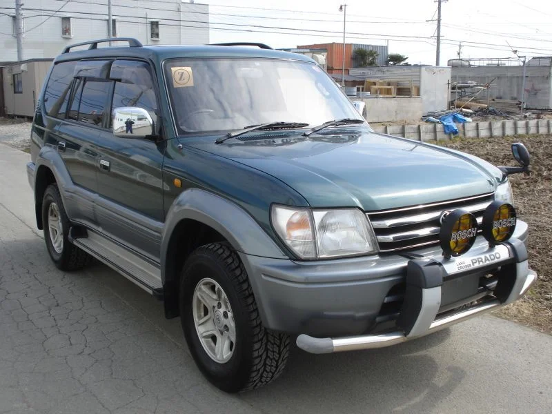

A 1998 with 106,000km - 5VZ-FE - Blue and other than aftermarket wheels and stereo appears stock.

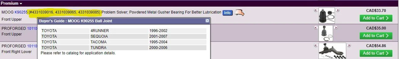

Here is the page from the Toyo-parts lookup for the upper ball joint.
It returns part number 43324-39016 for left-hand. Right-hand returns 43310-39015.
Rock Auto has reference to the Left (ending in 16) but not the right (ending in 15).
I can not see an obvious reason for the two-part unique numbers from the drawings.
Plugging the part ending into Rock shows a bevy of choices, this one being most compelling...
Both the grease nipple and the (attempt?) of rustproofing look compelling. If they are indeed interchangeable (15 and 16) I will go for this option for the uppers.

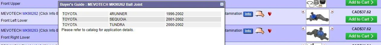

For the lower Toyo - part lookup shows this..
These return with Toyo part numbers LH 43340-39325 & RH 43330-39415
At Rock, again there is a bevy of choices with this Mevotech option with grease nipple, being most compelling. It does not have any reference to corrosion resistance

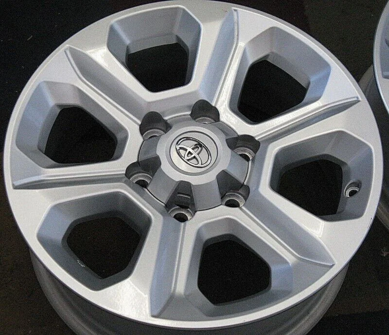

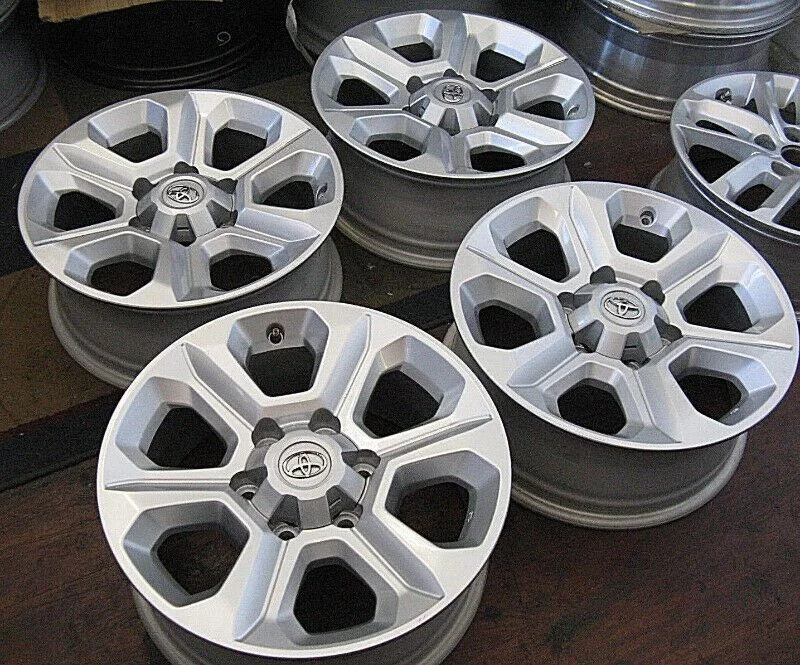

So I was going to stick with the rims supplied with the truck for the initial run of tires. While they do not look _bad_ they are definitely not my style.
But I really wanted the OEM look - Some rims were on the Canadian equivalent of Craigslist (Kijiji) but all had some really good battle scars or showed heavy winter use.
I expanded the search criteria to all of Ontario and a tire dealer in Ottawa (about 7 hours away) popped up. They had 16 (4 sets) new "Pulls" from the southern US where a Yota dealer was upselling rims on a feverish pace. The dealer was to sell 100 sets to him which lead him to price them at $125 each. Well, the dealer in the US only sent up a little over 25 sets, but the pricing was set in their advertising.
Then there was the 7-hour ride west to pick them up . Well it looks he has a friend who was up in Ottawa for the week from London (adout an hour and a half east of me) who was willing to drop them off on the way home for $40. I am about 10km away from the main connecting highway from Ottawa to London
So a new set of 4 center caps ($10 ea) and Yota OEM nuts are thrown in as goodwill - $650CDN inc tax (He is a retail outlet) to my door. $162.50 Hudsons bay pesos each.
Still need one for the spare, but being the 2014 - 2017 series I have a better chance of getting a nice wheel #5

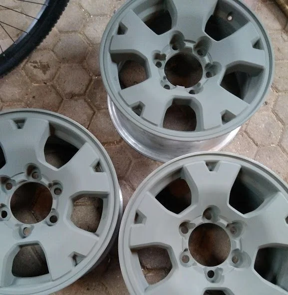

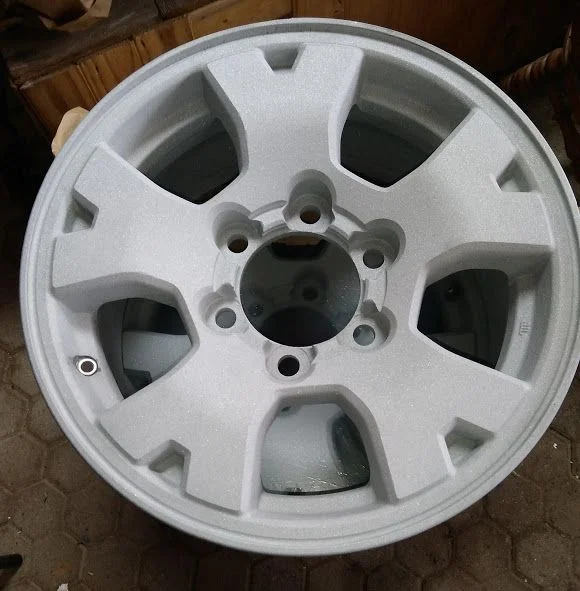

16" 6 bolt Tacoma rims were purchased and they were already sanded and ready for clear coat - I will give it a once over with 200 grit and IPA to be sure if any oxidation has sprung up since the fellow that had them cleaned them up. They also have the TPMS sensors which I will remove..

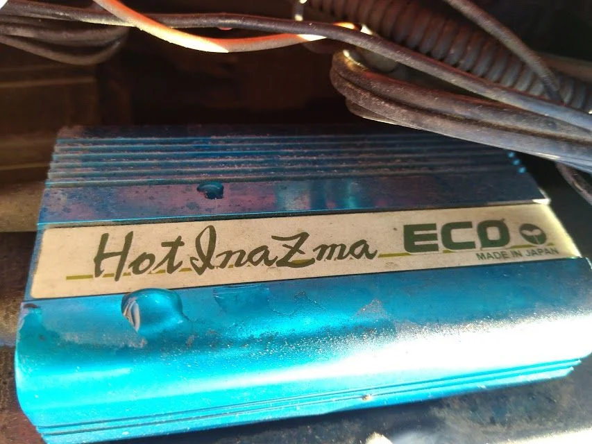

petrol one so none of the above - At least from the photos - There is a mysterious blue box to the right of the battery though ...

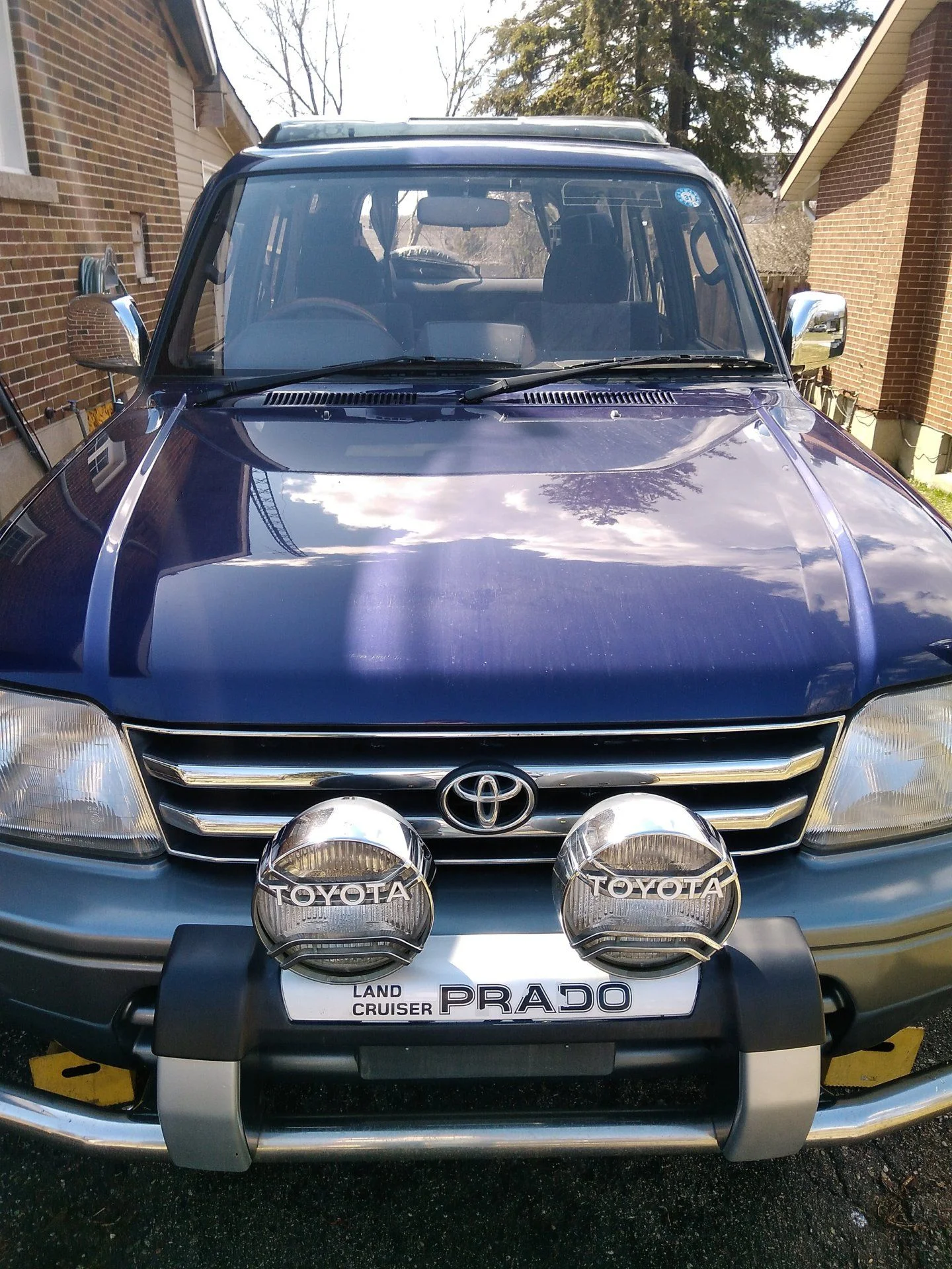

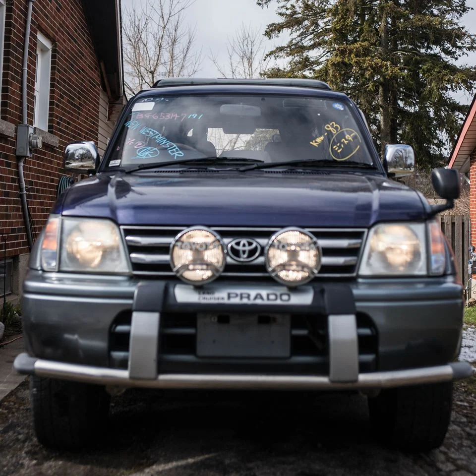

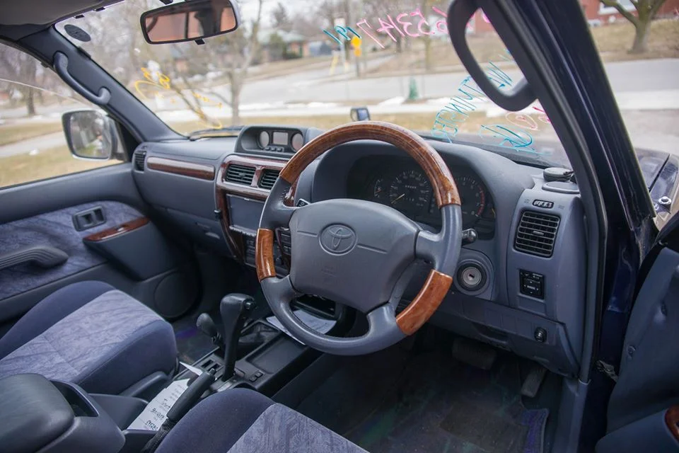

Well, she arrived this morning while I was on a short shift at work.
Needs a real good cleaning and the remote start module installed (Not HID) has to go.

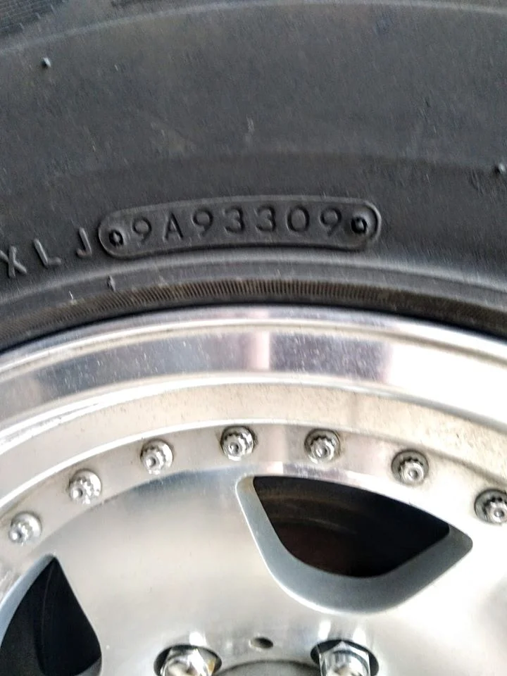

As expected the Toyo's are older than allowed for safety in Ontario so I am torn between a set of Yokokama Geolanders @ just over 900CDN and what looks like a good deal on a set of Kumho's Venture AT51s at a little over 700CDN. Both 3 peak rated
The mystery of the blue box is solved...
So it looks like there are smake oil salesmen for autos on every continent. This box is just connected between live and common and nothing else. A quick google shows it improves, power, fuel economy and idle. It is ...... A capacitor... and in 2003 it was $460 US - Out she comes.

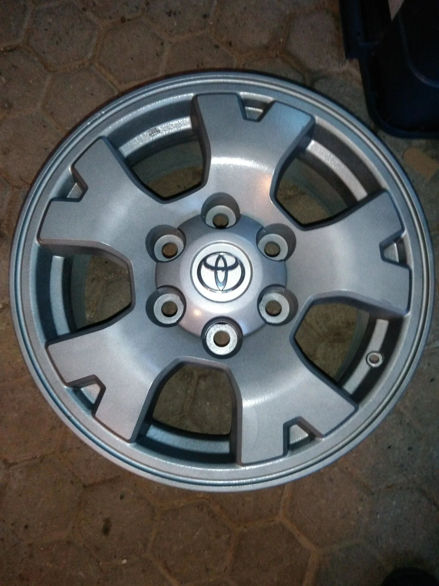

Wheels from a '10 taco were sourced - The last owner worked in a machine shop and sanded them down real good.
Etching primer, then Hammercoat pewter. Tomorrow clear coat and mask off the toyo logo on the center caps and paint up the same.
Geolanders are on order and should be here Tuesday or Wed.
And this is the result - Maybe a 5 to 10' paint job
Managed to get all of the wax/grease pen off of the windshield the yellow text took a hell of a lot of elbow (de)greas(er)
Now Day time Running light controller and clamps to hold the lights to the bull bar is on order. It looks like it is required for Ontario safety for anything made after 1989, and my old Pajero was an 88 so it never came to my attention at that time I wanted them overnight via Amazon but suddenly delivery is Apr 25 <shrug> Looks like Amazon is feeling the border slowdown. Hope they come sooner
