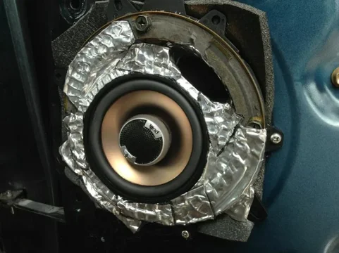

The bass port I added in at the top right made the sound so much fuller when compared to without. Again, this utilized the cage of the old speaker for mounting and a foam speaker enclosure. It also allowed for the speaker to be aimed upward and rearward.
