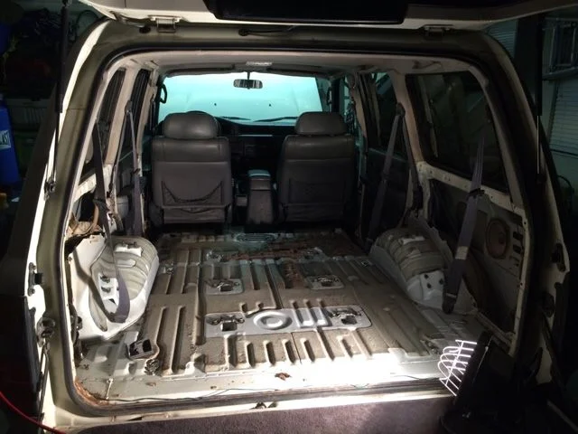

Worked all day today so very limited time to work on the cruiser. Pulled the remaining carpet and took her down to the car wash to power wash all the carpet pieces. I think someone dropped or spilled an entire 2 liter of coke between the front and middle seats. Hopefully I got it all out.

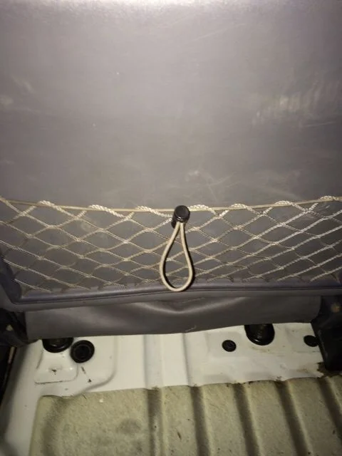

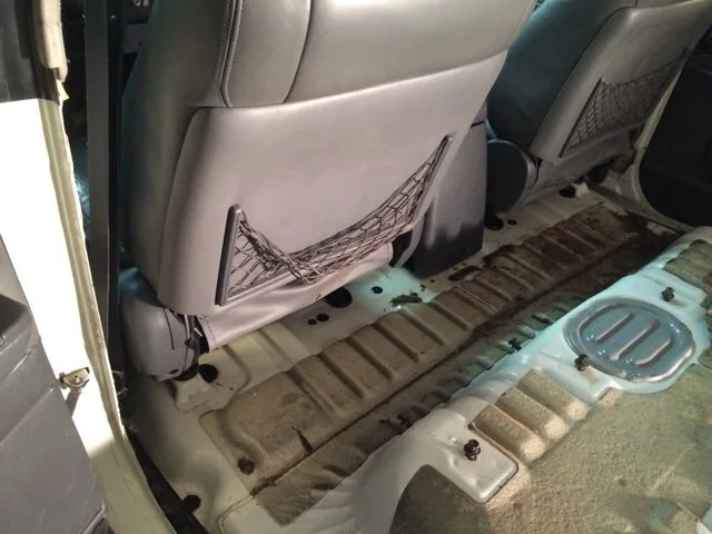

Anyone improved these strings on the back of the drivers seat?
After pulling the panels in the back I noticed what appeared to be a lot of dirt/mud in the rear quarter panel area. Any ideas how this would happen? As I looked closer at it it appears there is an air intake behind the rear windows. Does it just vent into the cab?

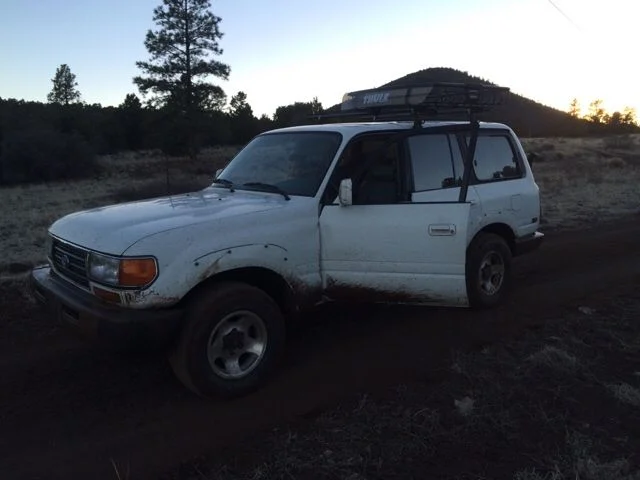

Took the cruiser out on some back roads last night. I still haven't installed the carpet (still drying) but the kids were begging me to go for a ride. We bolts the middle bench in and went out to begin making memories. It was so great to take it out.

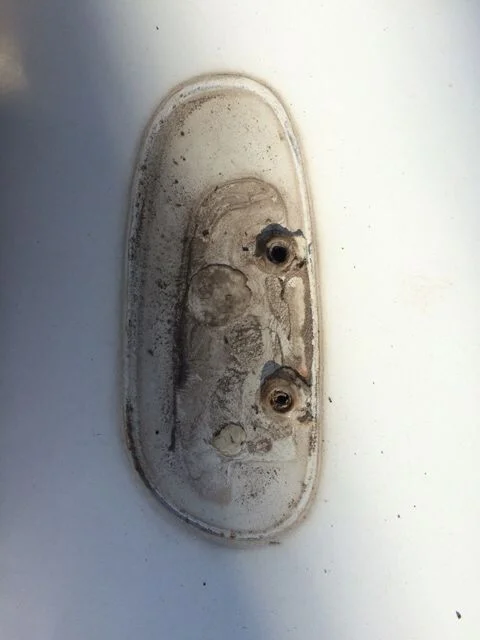

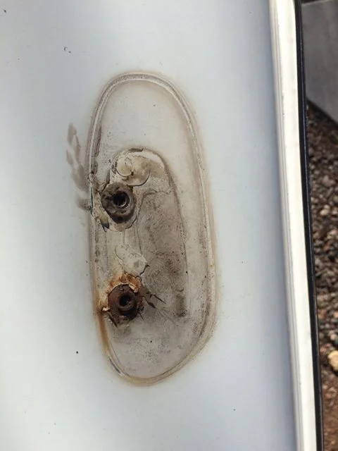

After reading the roof rack and rust post I decide to just pull mine since it was falling apart anyway. Fortunately none of the bolts spun and I was able to get it off. I found some rust though.

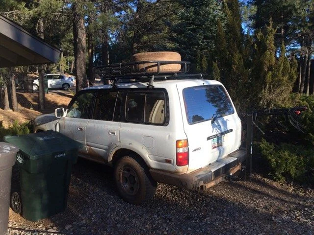

Once I got the rack off I mounted the yakima bars I picked up for $5. Then on top of them I put the thule basket I picked up for $35 at a yard sale. Score on both!! I'm thinking I'll put the spare in the basket a long with a shovel, an axe, and possibly a high lift jack.

Started off by sealing the holes from the factory rack with JB Weld. I read a post where a guy said it worked great and hasn't leaked. Here's hoping I have the same results.

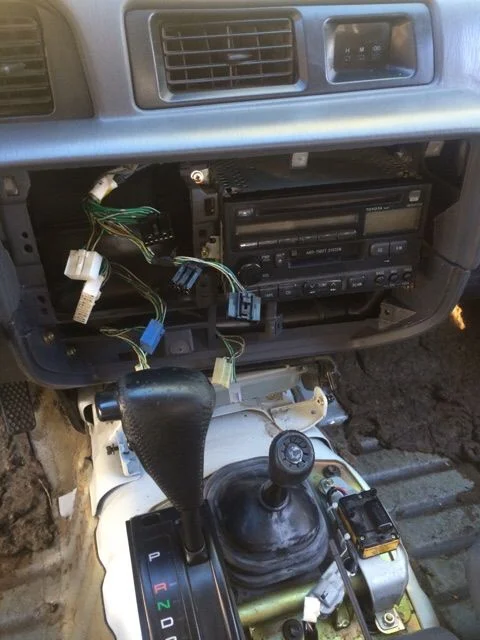

While that was setting I focused on the area around the radio. The cigarette lighter socket is loose so it needed attention. So did the ash try. Decided to tackle all of it and install the CDL button (repurposed hazard switch). It all came apart and went back together nicely.

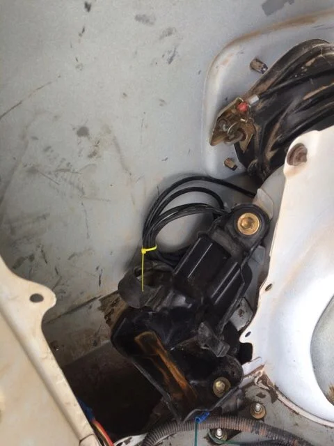

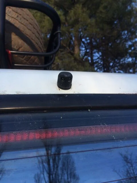

I took the rear door apart and worked on the rear latch and key hole. It seemed really stiff. I lubed it up and worked it free. It works a ton better now.
I also worked on the rear wiper and wiper fluid sprayers. The wiper was hanging really low when it was turned off so I pulled it and realigned it. I'm a little nervous about it because the threads were stripped. I'll have to essentially not use it on heavy snow. I also found the fluid sprayer wasn't working. I pulled the hose under the hood where it splits to the rear. The pump was working so I tried to blow air through it. Nothing moved so I started in the back and disconnected the hose. I was then able to move air through it which lead me to believe the sprayer itself was clogged. I hooked a pressurized air hose to it and couldn't move air. I used a small needle to free up the holes then blew air through it again. Worked great. Now I get full stream of fluid out the back.

I also moved the rack back a little and then figured out how to mount the spare up top. I'm pretty happy with it. I'd like to add a shovel and high lift jack up there. Not bad for how cheap I acquired the stuff.

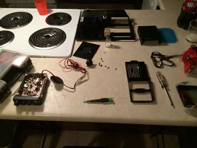

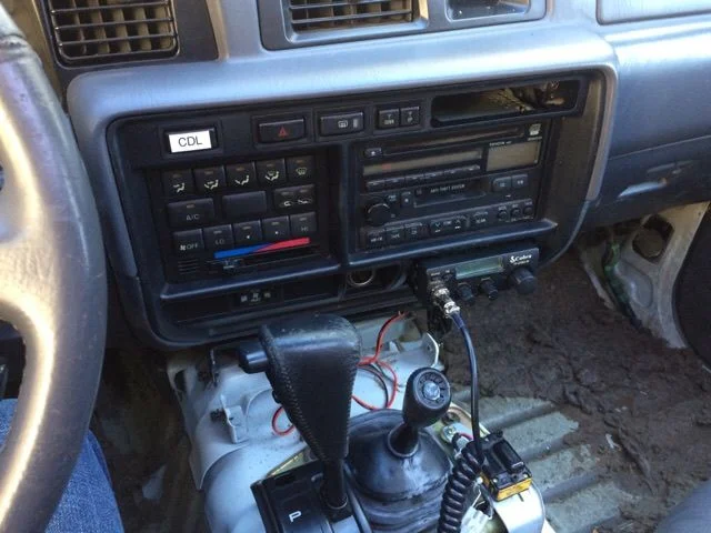

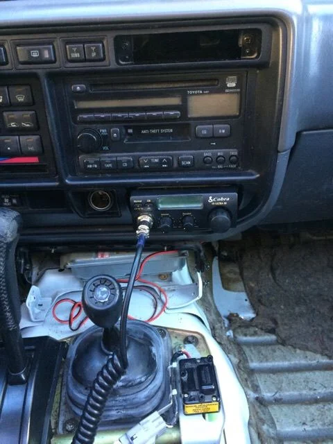

Waiting for Blackstone so I've started working on other stuff. I found a nice Cobra CB at the pawn shop over the weekend and negotiated for it. I paid $15 for it. Tonight I also worked on installing it where the ash tray was.i had to disassemble the CB and make some slight mods to get it to fit but I'm thrilled with how it turned out in the dash. Now I've got to get it all together and back in the truck.

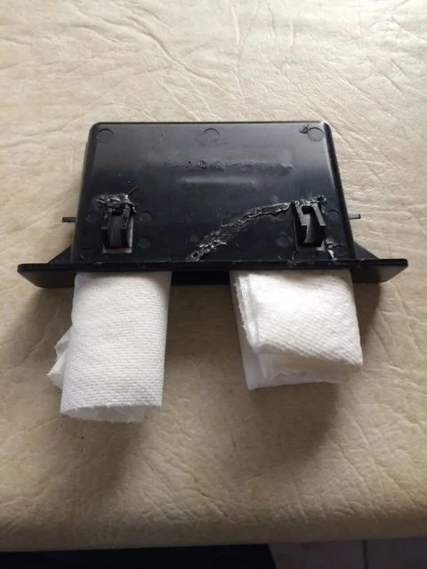

Here's the final dash put back together. I'm missing the small little piece on the top. When I pried it out it shattered into a bunch of pieces. That's the thing about working with this old brittle plastic.
Here's a picture of my attempt to repair it with JB Weld

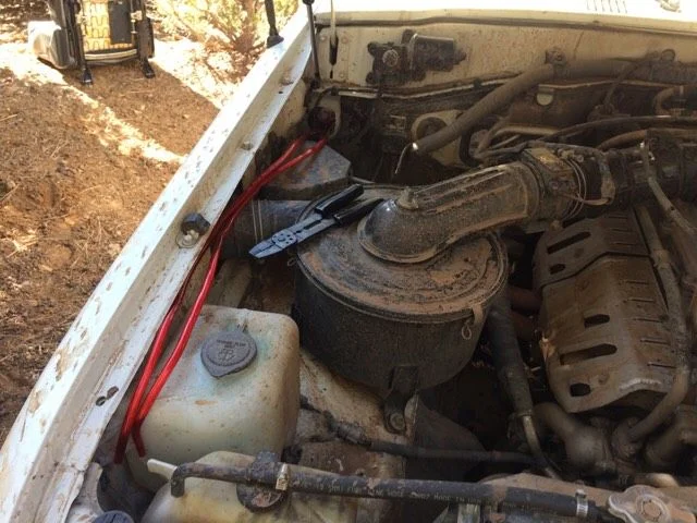

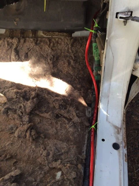

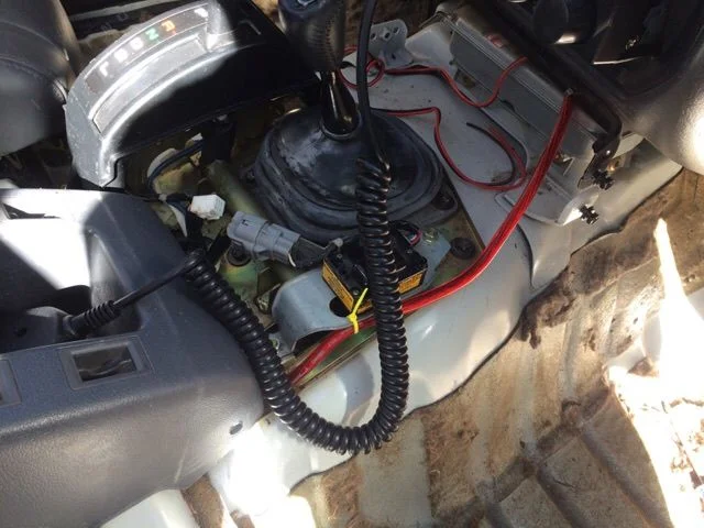

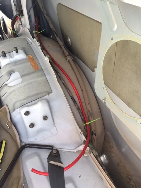

I'm pretty proud of how this turned out. Ordered 4G wire and installed it today. One runs on the passenger side all the way to the rear. I plan to add a fuse box and run 12v and 5v set ups back there.
Ran another one to the center console so I can set up a fuse box there. I'll power my ham, cb, 12v and 5v from there.

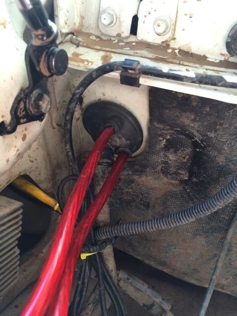

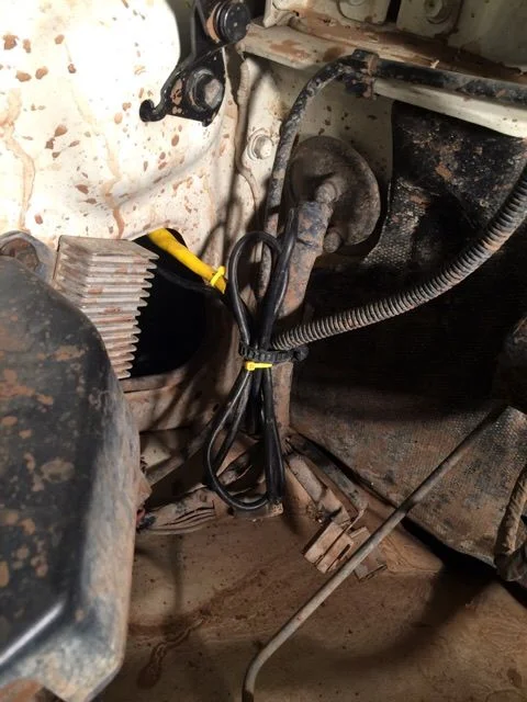

I ran the wires through the firewall on the passenger side to where the 2nd battery will eventually be. I'm so excited about how clean the wires came through the firewall. It almost looks like it was meant for that.
