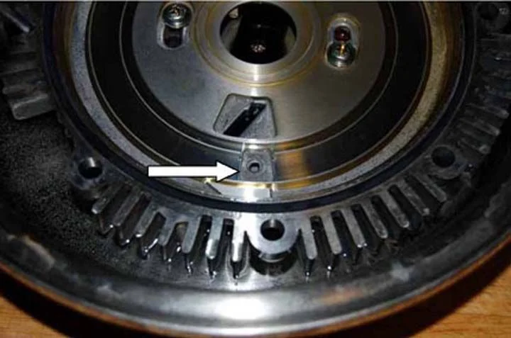

I did not measure the fully open/fully closed temps so I don't have an answer for that question. To which holes are you referring, the small round hole (arrow below) or the large parallelogram closer to the hub centerline (above it)? I set it for small holes half open at ~95˚F; IIRC it was previously half open ~110˚F in the water bath (and pulling only a modest amount of air).
I use first opening and fully open, but don't use water bath anymore. Found warm air (heat gun, hair dryer) and measuring the actual spring temp to be quicker, more accurate/repeatable.
