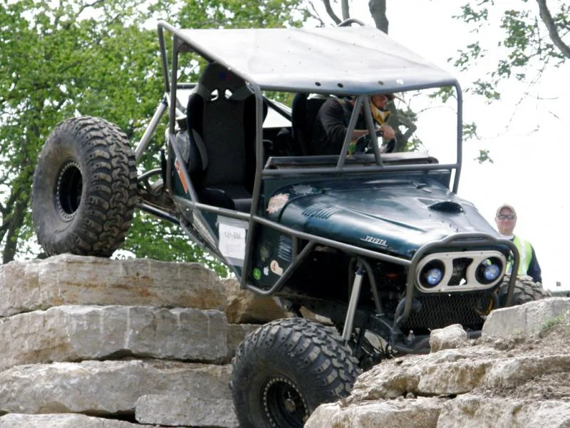

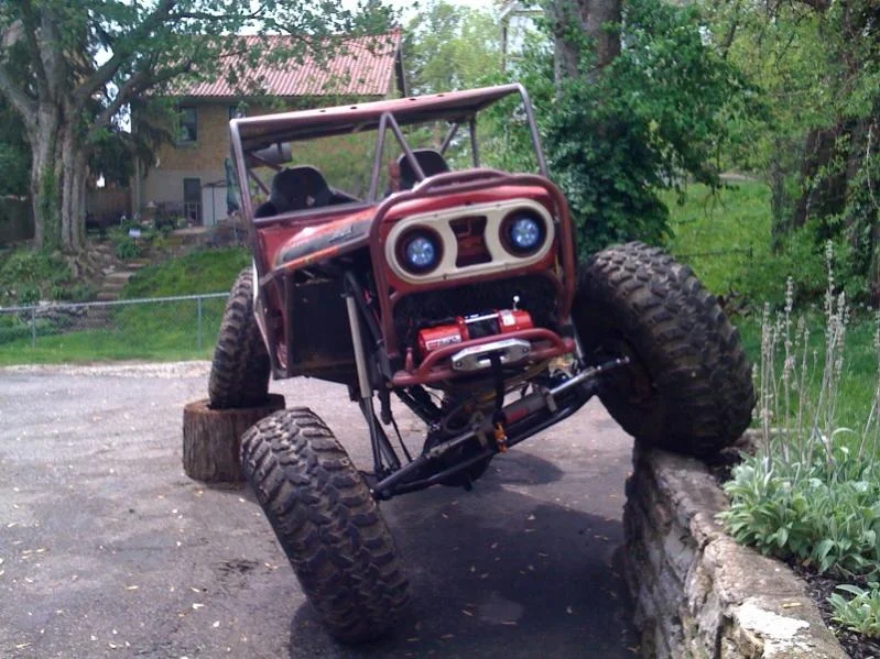

on the hunt for 97 vette motor to put in cruiser lets hear some what kind of trans you think i should run i am useing an atlas four speed behind it what gearing you think i should get. here is a pick of cruiser selling old drivetrail in parts sect

first of all that mall queen has a 2f in it and enough flex to make it up the right side of rattle rock ie 8' boulders thanks for the advice thow sounds like you are the expert
Sheesh..............wake up your sense of humor!!! Does that look like a "Mall Queen" to ANYONE???????

I am not mad just wanted to prove it had a motor. My current motor is the stock 2f which I have prodly ran for years and most people loved the fact that such a buggy still had a stock motor. But lately it has been holding me back switch ring and pinon to 4:56 just to spin irock's at a decent speed. So I started doing some research on motors. And the 97 vette motor is about the newest Ls motor that is kinda affordalbe. I have also heard the Lt versions are a pain. So selling 2f with 4:70 rockbox served me well but need some more Getty up for the slick rock.but I have no idea what trans to run and was curios what people thought of gearing I should go with in atlas. I think you are mistaken about parts deal. I have bought and sold many parts on this site thow. My name is dave. Did not mean to come off like a d##k but I see alot of slams on this site.
