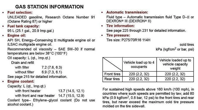

Bear80 - I got the following from Lexus's website. As a Lexus owner, we can register our rigs on their site -- it's under the Owners section of their home page. When you do (you'll need the VIN to do this) you get access to some cool stuff online. One thing you can do is to search the owner's guide online or download it in PDF format. You can also order free replacement Owners manuals if you don't have one.
The following image is from the Lexus site. I although I have the entire manual on my PC, I downloaded this specific section and converted the PDF into JPG so I could post it here. Choose to believe or not -- it's your call -- but as Beowulf, myself and others have said -- the 450 takes 87 octane (you can put premium in if you so choose -- it's your cash your blowing)
