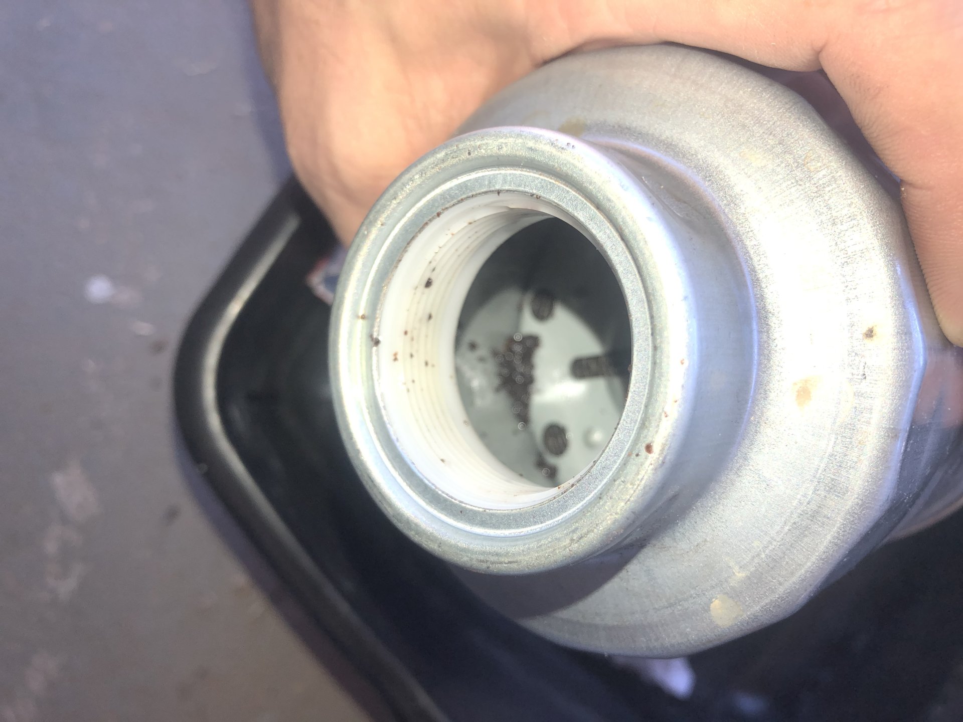

Sorry I couldn’t really get the camera to focus
inside any better. But I’m pretty sure that sediment wasn’t helping fuel flow at all, lol.

The sediment is not good, and could be a good reason to look inside your fuel tank for rust, but that small amount of stuff is not affecting the flow of fuel with any significance. You could cut the filter open if you wanted to see how the actual filter media looks though.
