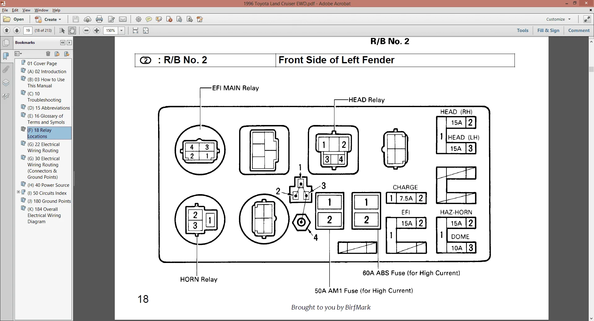

Under the hood, on PASSENGER side (left side) is the fuse block. (Edited due to being RHD)
Open it and pull the fuse marked "EFI". It is in the lower right of the box as you see it in the diagram below.
Pull it out and keep it out for 5 minutes.
This will clear all stored codes and will force the engine to "relearn" all of it's stored parameters.
Reinstall the fuse, then do the following:
1) Turn the key to the "run" position, leave it for 10 seconds, then turn back to off.
2) repeat step 1 three times.
3) Start the truck. You may find that as soon as it starts, it revs way up, then back down, then back up and it may do this 4-5 times, then it will settle down. Doing the key sequence above helps alleviate some of that.
You have now cleared all stored codes and your truck will start to learn your driving style, throttle position, acceleration and braking habits and will adjust fuel consumption accordingly.

OK.
Under the hood, on driver's side (left side) is the fuse block.
This helps you "start fresh" to see if there are thins you are unaware of.
As a suggestion, when you do start replacing parts and doing your own work, use Toyota parts when possible. This is not because we're purists, it's because we have seen where problems persist. There are some things you can get by with, but you'll figure these out.
Read a LOT on this forum, as every question you have about your truck has been answered at least once here. Use the search function. Ask when you don't know. Diagnose BEFORE replacement. Don't just throw the parts cannon at it. That's REALLY expensive.

Other than removing the 15 amp EFI fuse, nothing else is needed.
Not sure anything is gained by switching the ignition on and off 3 times other than exercising the ignition cylinder.
Typically the idle speed will increase for the first few drive cycles, but I have never had one cycle up and down after a reboot.
I know it doesn't state that.
I did this just for the heck of it one time because I've had other vehicles state to do that after a battery swap.
When I did it on my LC, it started right up, did not hunt for RPM, and was smooth from the get-go.
It kinda surprised me, so now I do it every time. It takes out some of the anxiety for me of the RPM up and down and worrying it won't settle.
