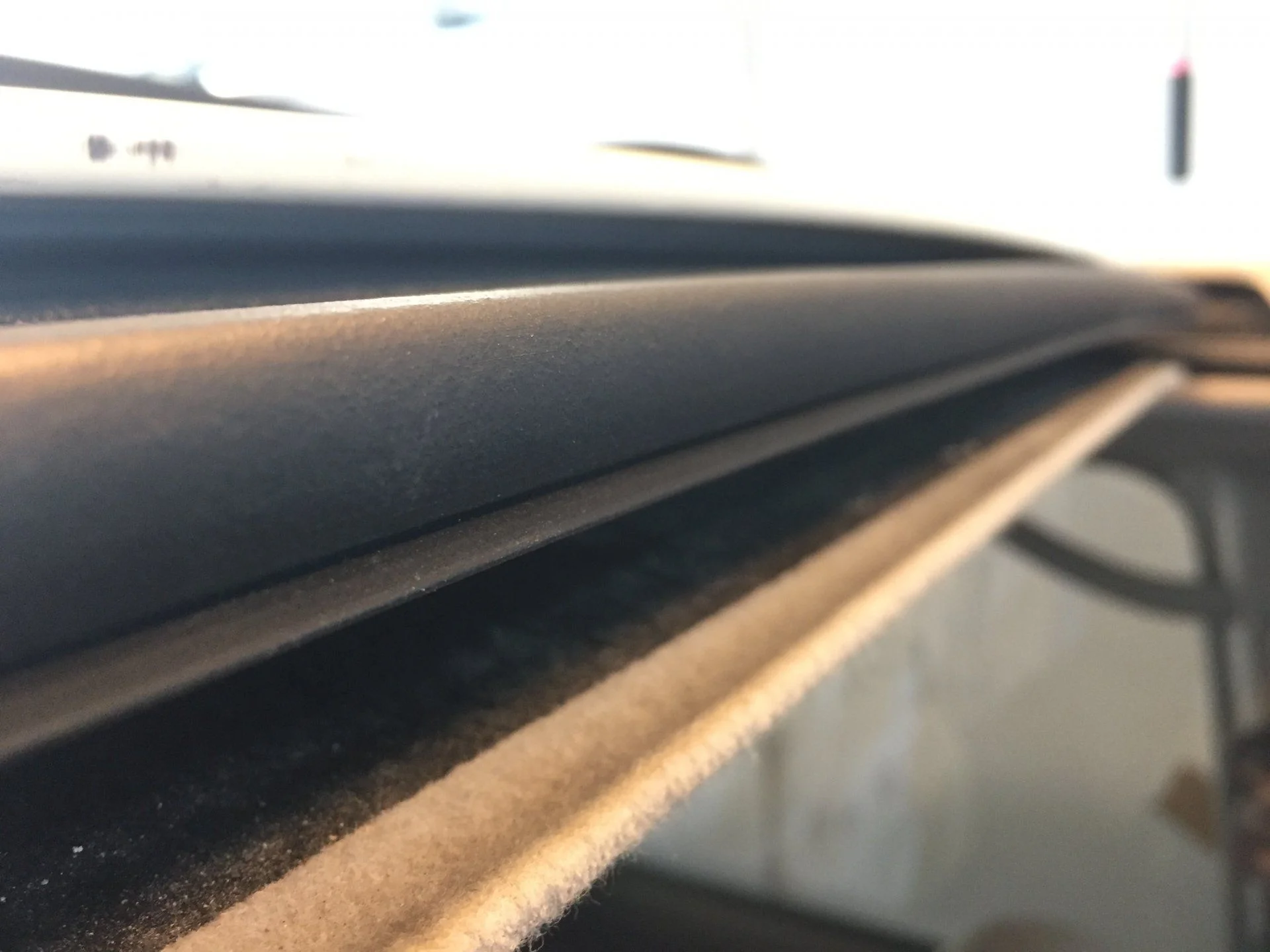

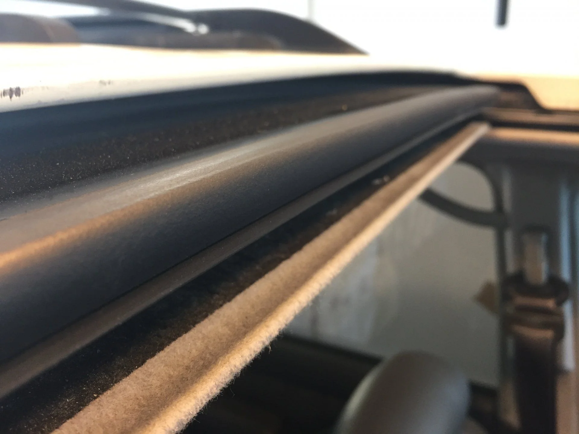

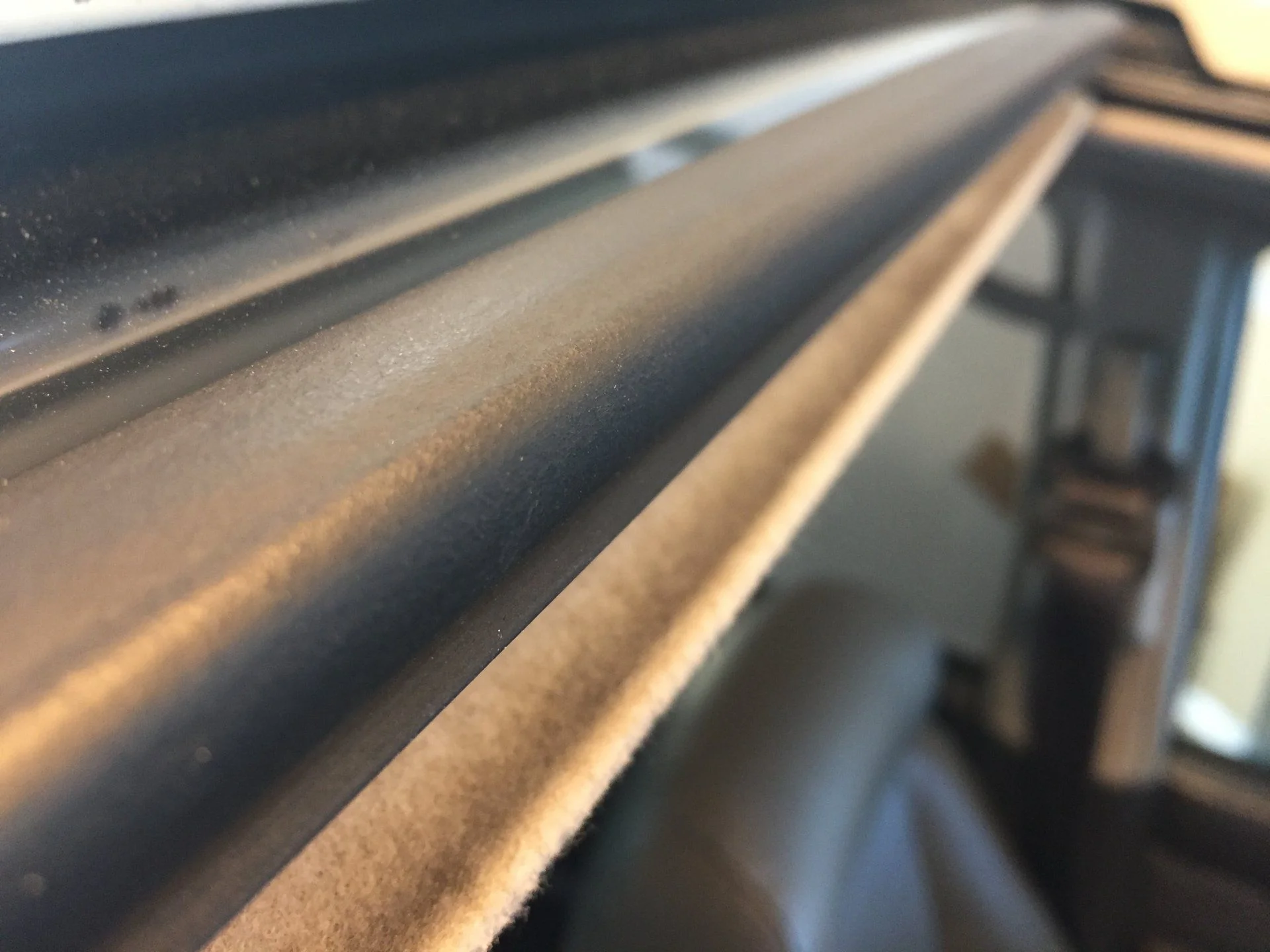

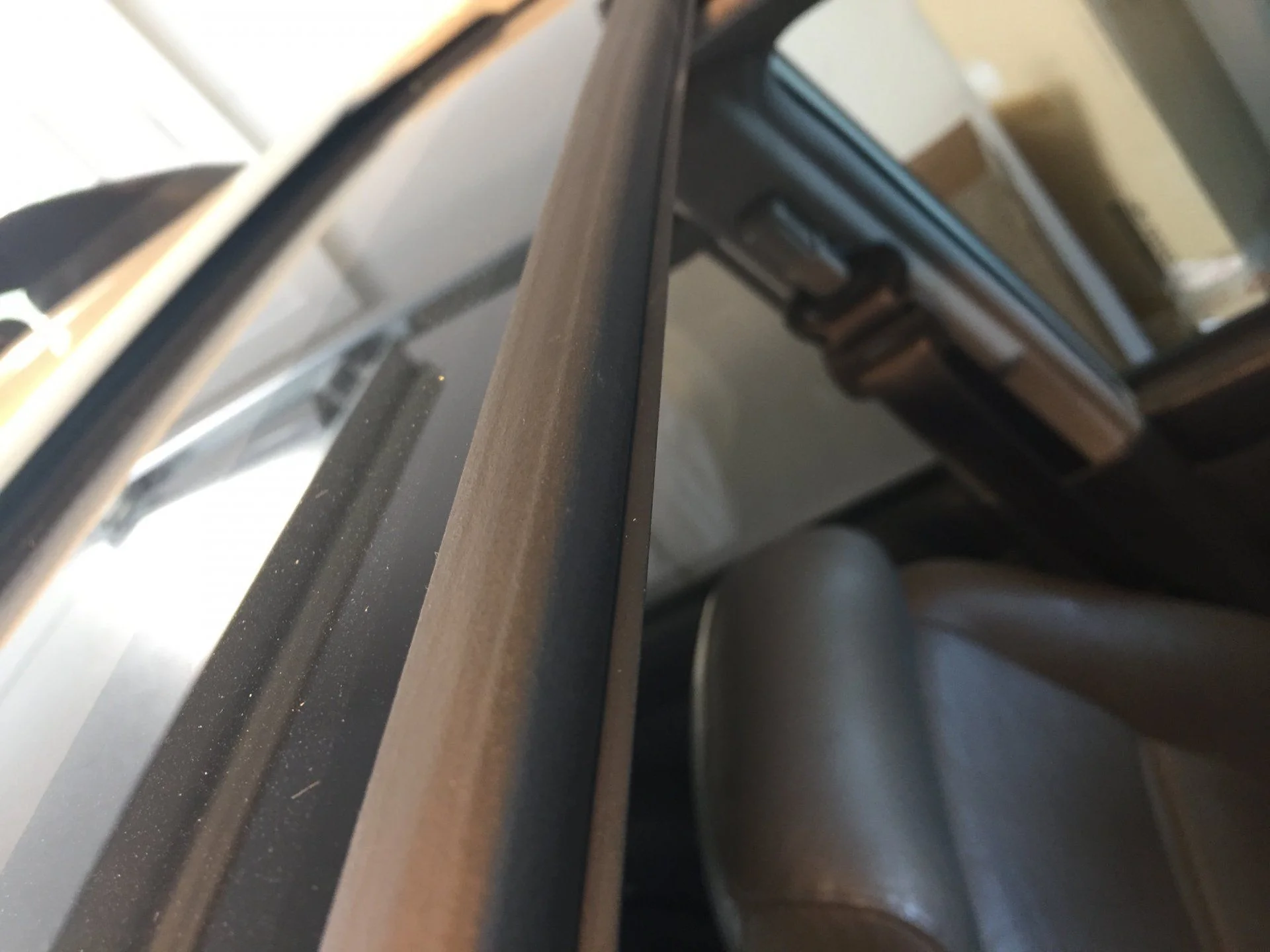

The pic I posted is of the original '95. The corner tri pieces are a solid polymer, not a cellular foam. I exhausted all options in chasing my leak but in the end replacing the entire glass/seal component was the only thing that solved it. The sun-baked integrated seal was allowing more water than what the drains were designed to handle. Not fun spending that amount on a stupid sunroof. The seal on the new part is a different design of closed cell urethane (foam type) in a bulbous form similar to the front inner door seals...versus the felt/rubber combo of the original.
Did you get any pics of the new seal? I may consider finding something to work as a replacement, but knowing what they came out with would help as a starting point.
I'm with @BILT4ME, if the new seal isn't the same as the old one, I might try to find a stock extruded profile somewhere. It's hard to believe someone's making a custom profile for Toyota for these replacement parts, especially since they're 20+ years old and the volume is nothing. The 100's have a replaceable seal. I wonder if the "new" 80 seal isn't the same one, cut to the 80's length. Even if it isn't, if it fits the glass, at the price it's almost worth trying.
@MoJ, that almost looks like the windshield seal. Thanks for the photos.
EDIT: I meant to say the material looks the same, not the section, of course. Interesting that Toyota changed the design after all these years. I wonder if that's to be consistent with the new designs. Have to check the 200.
