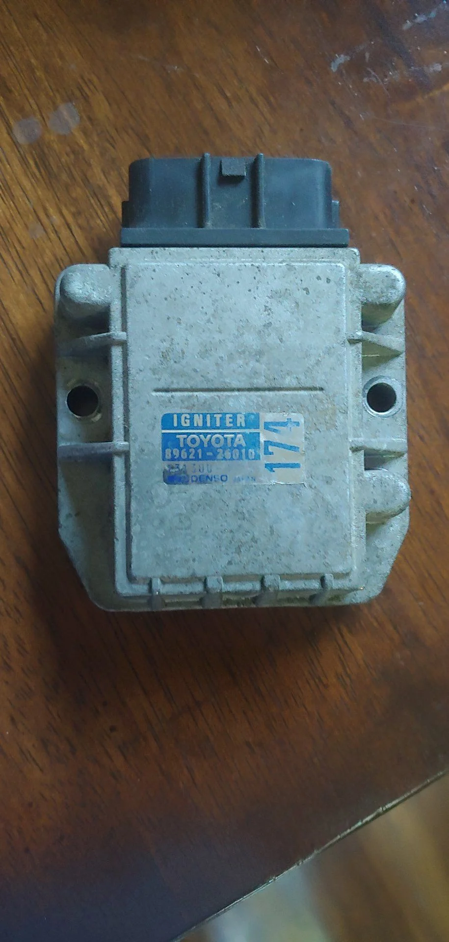

My rig died on me on a trail while on an incline. The symptom pointed to a fuel pump because it felt like fuel was not reaching the injectors. After getting it towed the EFI relay and a throttle sensor was replaced after a code was read.
I though it fixed the problem but a few days later the RPM started to jump erratically and stalls during stops and would sputter during acceleration.
I then replaced in order:
fusible link
Fuel pump
Fuel filter
Ignition coil
Distributor and cap
All these new parts did not fixed the issue. The injectors had been replaced in the past as a PM and spark plugs and cables are fairly new. What finally fixed the problem was a brand new ICM. I hope this will help others with a similar issue.

Sorry I guess the proper name to the part that fixed my issue is called "ignitor" PN 89621-26010
