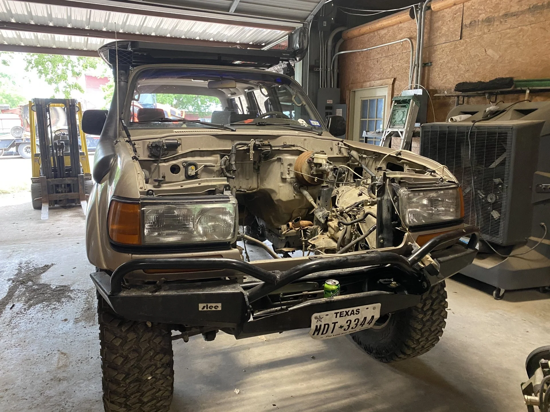

My dad and I recently started on a engine swap on a 92 FJ80. We were in need of more power and more fuel efficiency and the 3fe did not fit that bill. We will be swapping in a 5.3 vortec and 4l60e. The swap started last week but here are some pictures from a couple days of work.
This is the progress we made on the first day. Took everything out of the engine bay that won’t be getting pulled with the engine, and pulled both drive shafts.

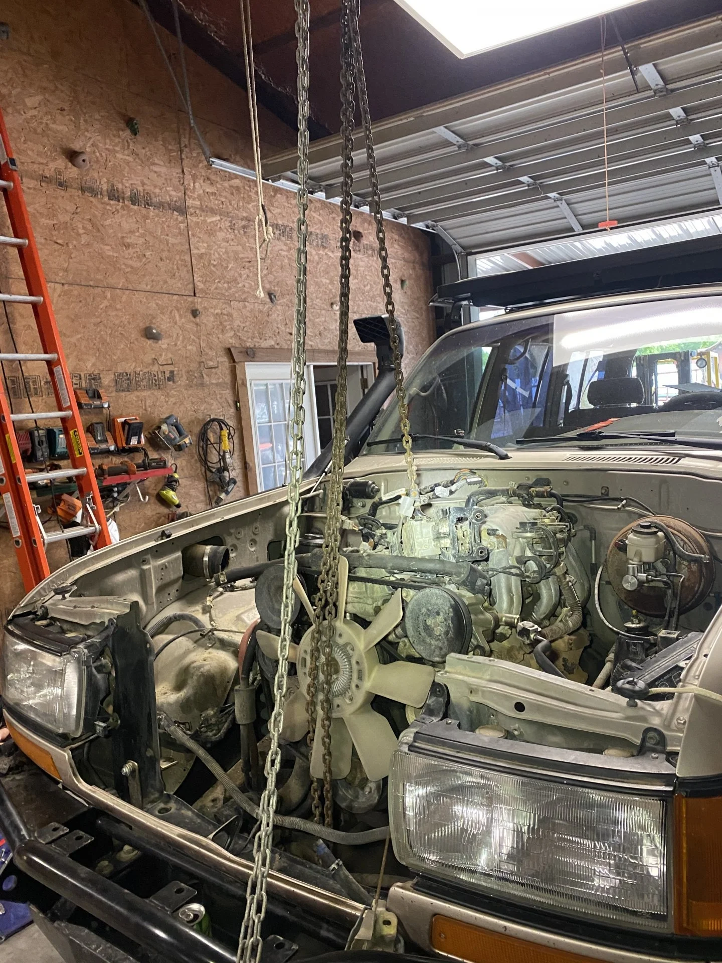

Removed the motor mounts and dropped the tcase, getting ready to pull the motor out.

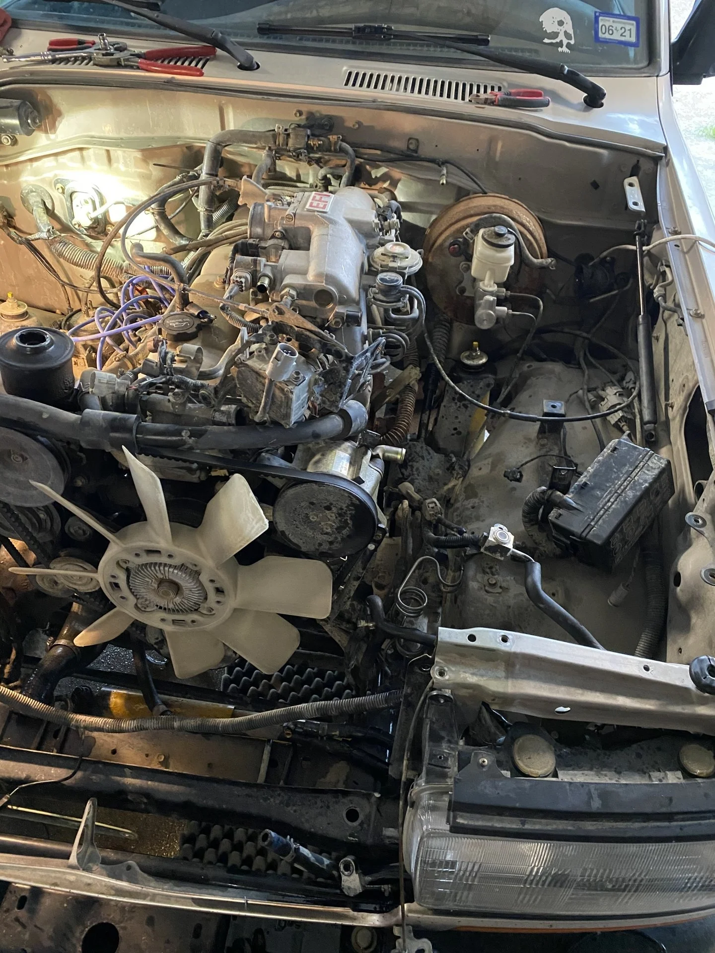

motor is out! We ended here for the day but next time will be cleaning the engine bay of nearly 30 years of leaks and overall use.

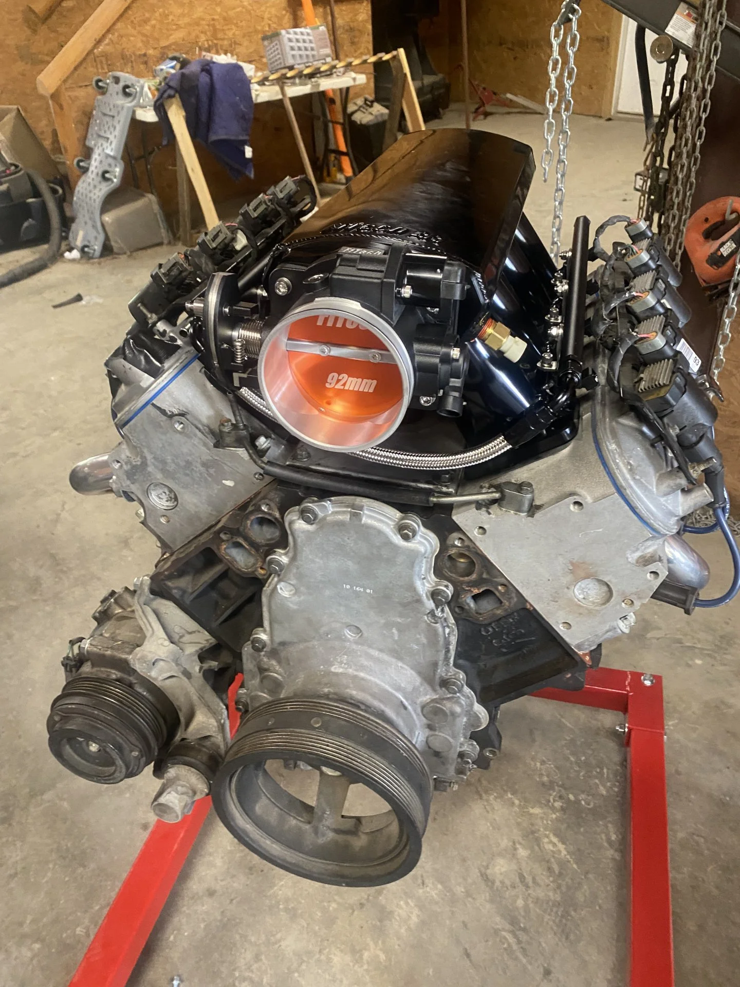

So we did a thing…
Kinda decided for the whole more power idea and picked up the FiTech EFI kit. Comes with a touch screen engine/transmission controller/tuner, gauges, ecu, wiring harness, and more.
So not only does it mean more power, but it comes with a wiring harness and ecu that makes it fully programmable.
The included wiring harness will take a big part out of the labor required for the swap and will also keep it tidy under the engine bay.
This kit is the 500hp variant. They also offer a 750hp kit.
may or may not have got a good enough picture of the engine bay squeaky clean so now it’s just a picture of the cool stuff.
