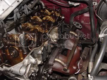

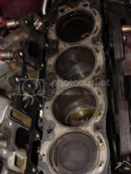

OK, got the old head off, I made the mistake of trying to remove, intake and head all at once (I read a post here somewhere, says you can ), Believe me you can't do it without a hoist. I will try to post another pic.

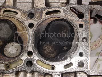

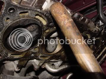

In this picture I am looking for a bent valve, or a problem on #1. (no compression)

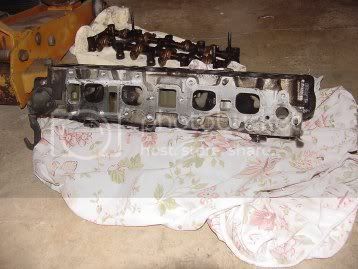

And here is the head laying in the floor.

Ok, only had one problem removing head (not counting the hidden allen head bolt) I rounded the head off on one of the head bolts, had to break out the sawzall, then put the trusty vise grips on it, came right out.
