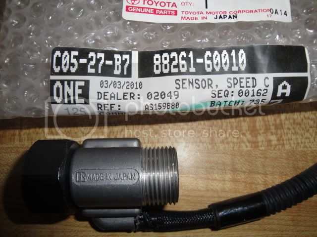

In the meantime, if you're antsy go ahead and pull the speed sensor; you'll likely find it fouled with gear oil, in which case you've found your problem.

i dont have blinking light above 25mph other than that everything is normal even speed sensor is clean not a single drop of oil on it .Is it still the speed sensor or actuator? is there a procedure to check actuator?

did pulled sensor apart and no oil inside no oil outside and same no blinkin light after 25 mph after claening

Failed speed sensor would usually be Cruise light ON when starting the test drive, and then staying illuminated (rather than flashing) when driving over 25mph.
Definitely worth pulling the sensor and bench testing it; that's the most common failure point on a 91-92.
