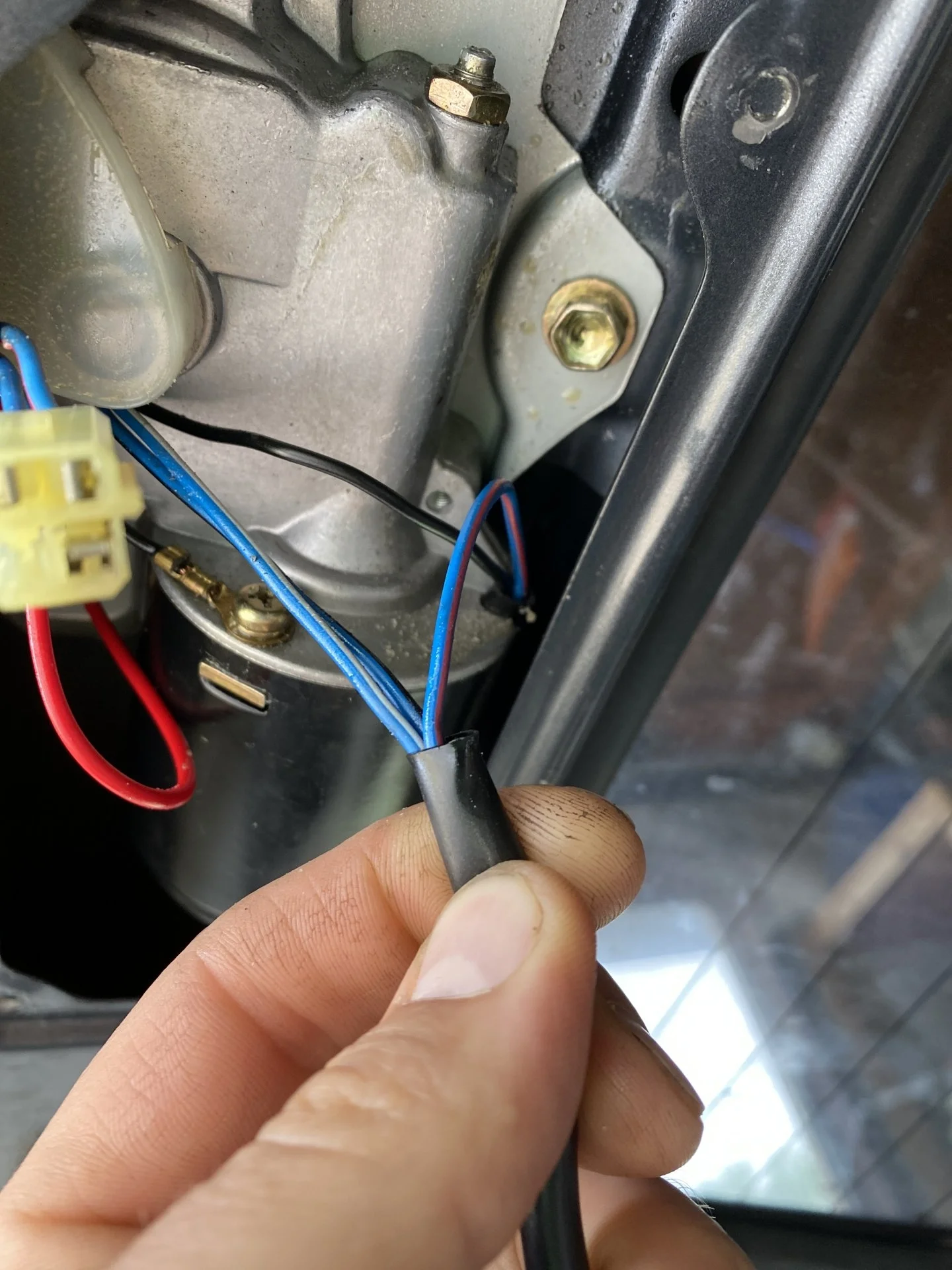

resurrection of an old thread. i’m trying to get my rear wipers working. 1989 fj62. there are three wires going to the motor a blue/red, a blue white and a blue black. there is a solid black screwed to the body of the motor i assume is ground. can anyone tell me what there three blue/? wires do? i’m trying to jump it to see if the motor is maybe not working but i can’t seem to get anything (which means the motor may be shot) but as i don’t know what i’m actually testing i don’t want to make that conclusion just yet
i have tried changing out my relay with an extra one i have and no joy. i also tried checking for power to the wires going into the fuse and only got .7 of a volt off one wire. not sure what that means.
fyi my fuse is fine
new update…i found the battery i was trying to jump the motor with was actually dead. a different battery and i have power at the motor with pos to blue red wire and grounding the screw. so motor is good. relay still unknown but i’ve tried two and neither work (both look clean and in good shape inside). fuse is good. any help as to how to trouble shoot the harness would be appreciated. it doesn’t sound like my washer motor is working either which i understand is on the same circuit
also i just tested continuity between wires at the relay and at the motor and all three are ok. so now it seems like it’s something between relay and switch or maybe i have two bad relays (but i don’t think so)

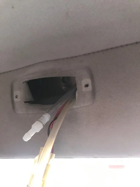

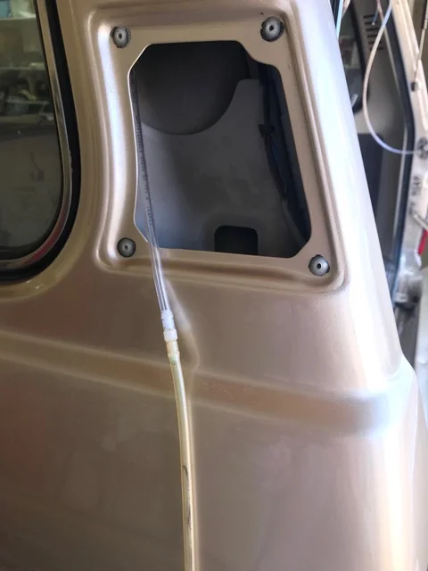

FYI...this is what I did to replace the washer tubing:
First I cut the tubing on the pump-side of the blue check-valve (passenger two-screw cover area of the lift gate). I gently removed the rubber boot between the car and lift gate on the passenger side and pulled wire and tubing out of the lift gate and separated the tubing from the wires which were wrapped with electrical tape (wire disconnect in same area as check valve). There is a white union behind the dome light and I used it to couple in the new 1/4" vinyl tubing (0.17" ID) that I got from Ace Hardware and pull it from the passenger side to the dome light. Use a stiff wire with a part loop to grab the tubing, Once a length of tubing was pulled from the passenger side and out of the dome light opening, I opened the drivers side rear vent and fished the old tubing with new tubing attached out of the vent. Connect new tubing to white union behind dome light...everywhere else...and done!
