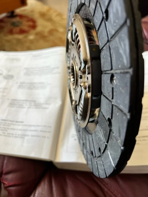

Adding to this post regarding clutch direction- I'm having trouble figuring out the correct orientation because the FSM appears to show the clutch in different positions on different pages. This is my first time, so I'm floundering. I messed up the clutch fork installation the first time, so I'm on tranny pull #2, and don't want to do it again any time soon... CL-11 shows the orientation one way and CL-13 appears to be shown the opposite direction.
If anyone can chime in definitively as to which end faces the flywheel (motor) side, I would be very thankful!
3.Slow with R150F transmission
I think the first picture is the side that goes to the flywheel.
