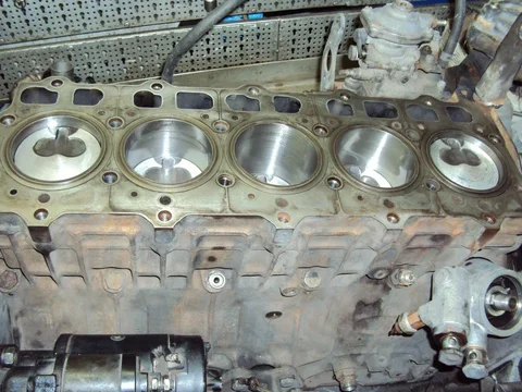

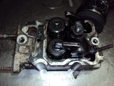

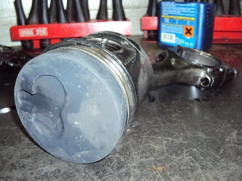

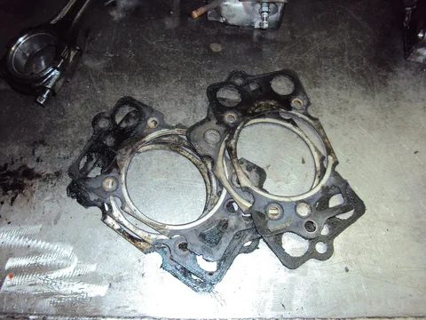

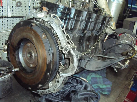

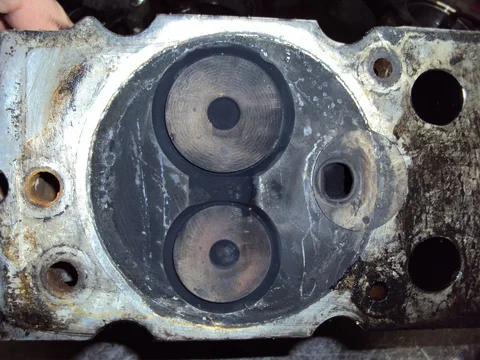

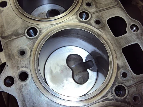

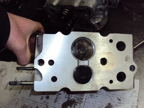

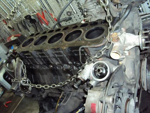

Around 300,000 km I made a revision to the engine : floor cleaning heads , new valve guides , valve seat grinding , new head gaskets , cleaning circuit cooling , cleaning the oil circuit , new main bearings and connecting rod bearings , piston rings , cylinder liners cleaning
Head gasket
piston disassembled
One of the 5 head
Head side piston before
After little grinding

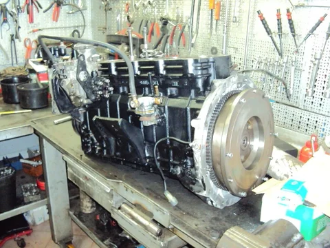

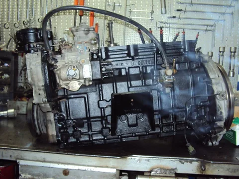

Engine block semi - naked
The other side
the 5 brothers are in!
detail
Black paint for the block, you can see mounted the VE Bosch injection pump
Another view
