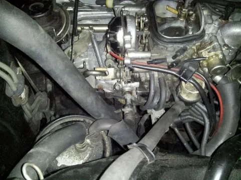

I did not touch the carburator or the linkage at it, I simply removed the intake and carb all in one piece. I may have jarred something while moving it around from spot to spot, I did place it on its side to drain degreaser out of the intake while cleaning but that's it. I've tried adjusting the idle screw but it seems to do nothing for decreasing the idle speed and the linkage has not changed in legth. and when I give it some slack it also does not affect the speed.
I am speculating I may have crossed a couple of the endless and useless vacuum hoses that are in here but am not sure (I thought I kept track pretty well), the Hanes manual is a pathetic joke and wouldn't even be useful as toilet paper.
So, has anyone encountered this and knows what I'm talking about or has a schematic of the vacuum hoses and the carburator. I seem to have one very small piece of linkage right beside where the throttle cable connects that is just sitting there not connected. Like I said, the origins of this engine are a mystery and I have no clue who has pissed around with it, so I am assuming everything is incorrect. I can post photos if it helps.
