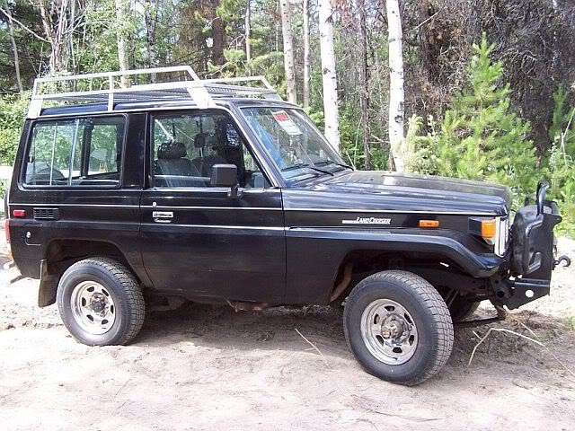

Look how much the springs are sagging, and the angle on the shackles is pretty bad too. Here's a link for pics.

The stock "huge" bumper and PTO do not really count - they're very light.

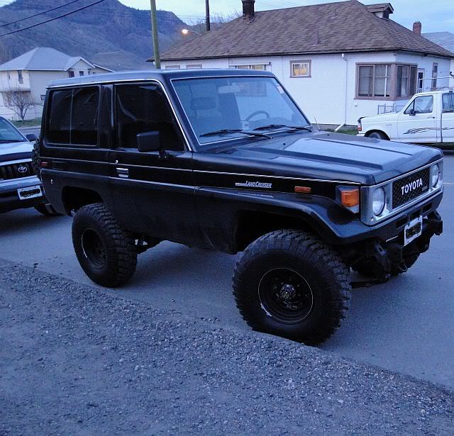

Thanks for all the help guys. I have narrowed down a stock set of springs and works, and also I've priced out on OME set. Can anyone post before and after pics of a stock to OME Lift? Im running bfg all terrains 31X10.5X15, was wondering if a 2inch lift from now (from what I've heard will lift my truck 5-6 inches seeing that my springs are all shot) will make my tires look quite small. Before and After pics please.

This is a little different from what you are looking at, but here are some before and after pics of my 70 from stock to a Belton lift (3.5" I believe?). I also put on 33x10.5 tires, from the stock 235's....
