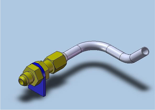

What I like to do with tube to hose transitions is to use a bulkhead union to connect them, and put the union in a tab or hole in something. In this case I'd weld the tab to a semi-circular piece of steel that a hose clamp will hold to the link's tube. Like this, only the the blue tab would be welded to the curved piece of steel that the hose clamp would sit on top of.
For what that's worth anyway.....
I have a bulkhead T in a weld on tab I fabricated at the top near my upper links. I bought a few straight bulkhead fittings as well just for the purpose you mentioned. You might have pointed me in this direction earlier in my build. Same with the reusable hose ends. I appreciate the advice. 👍
@ntsqd I just re-read your post. To put bulkhead fittings ON the link, I'd have to have an angle tab with a hole so I could clamp it to the tube. That way I can adjust the link if needed and keep my hard line where I want it. ( Just like you said)
I put the bulkhead T and union at the other hard lines end and welded the tab like your pic. Hoping the clamps on the tube will work. If not, I'll have to go a different direction like you mentioned.
