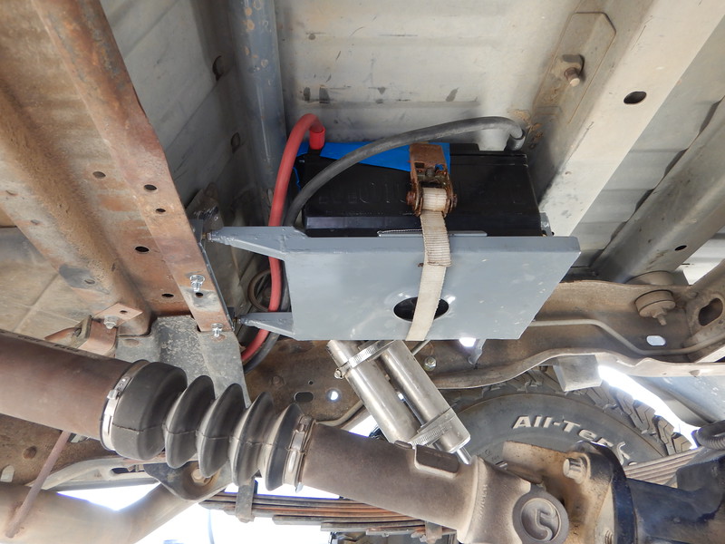

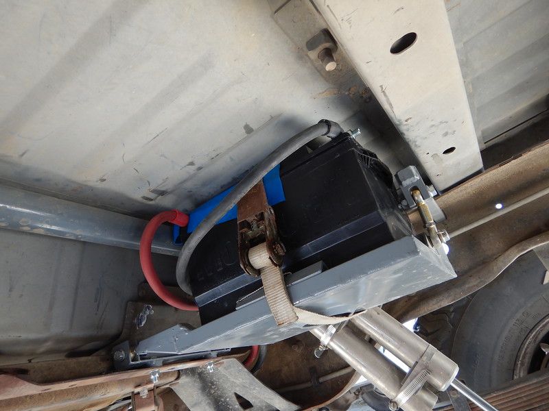

Wait, I sort of did for the 'house' battery. Not under a Toyota, but a Ford. With it's C-channel frame I knew that the frame would flex and the bracket needed to allow for that or it would be breaking parts. I tucked it up tight enough to the floor that I have to remove one of the "shackle" bolts to R&R the battery. The blue plastic is part of a Delo 400 gallon jug and it's there just in case something goes T-U. The ratchet strap is secondary retainer. I wasn't 120% convinced that my clamp (visible under where the strap is doubled) was always going to work.
Pretty cool design. I like the rod ends to swing it down and isolate flex.
