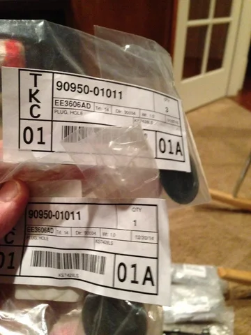

For those who may have removed the rear heater (under the passenger side front seat). What did you use to plug the resulting holes in the floorboard? Specific part numbers or references? I'm guess there might be some specific rubber or plastic type body plugs to use?
I know this wide open for off-color comments/feedback :) but really...what works?
This is what you want. Cheap part too....
Part # 90950-01011. You'll want 4 to plug it from both underneath and inside.
thanks... I'm looking to not have a water fountain on the next river/creek crossing, I'll order a few tomorrow.
