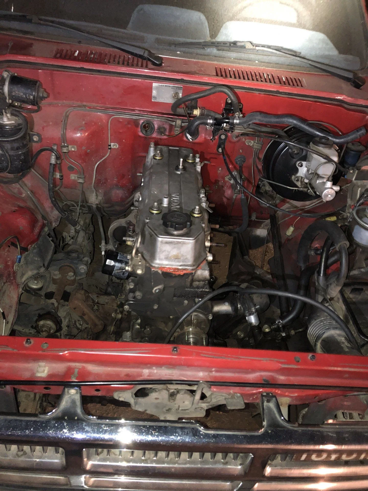

Seeing how I know my way around a 22re pretty well and having decent connections everywhere, I agreed to take on the project while he is out of state working. Started this week with a few hours here and there after work and finally got the engine pulled today.

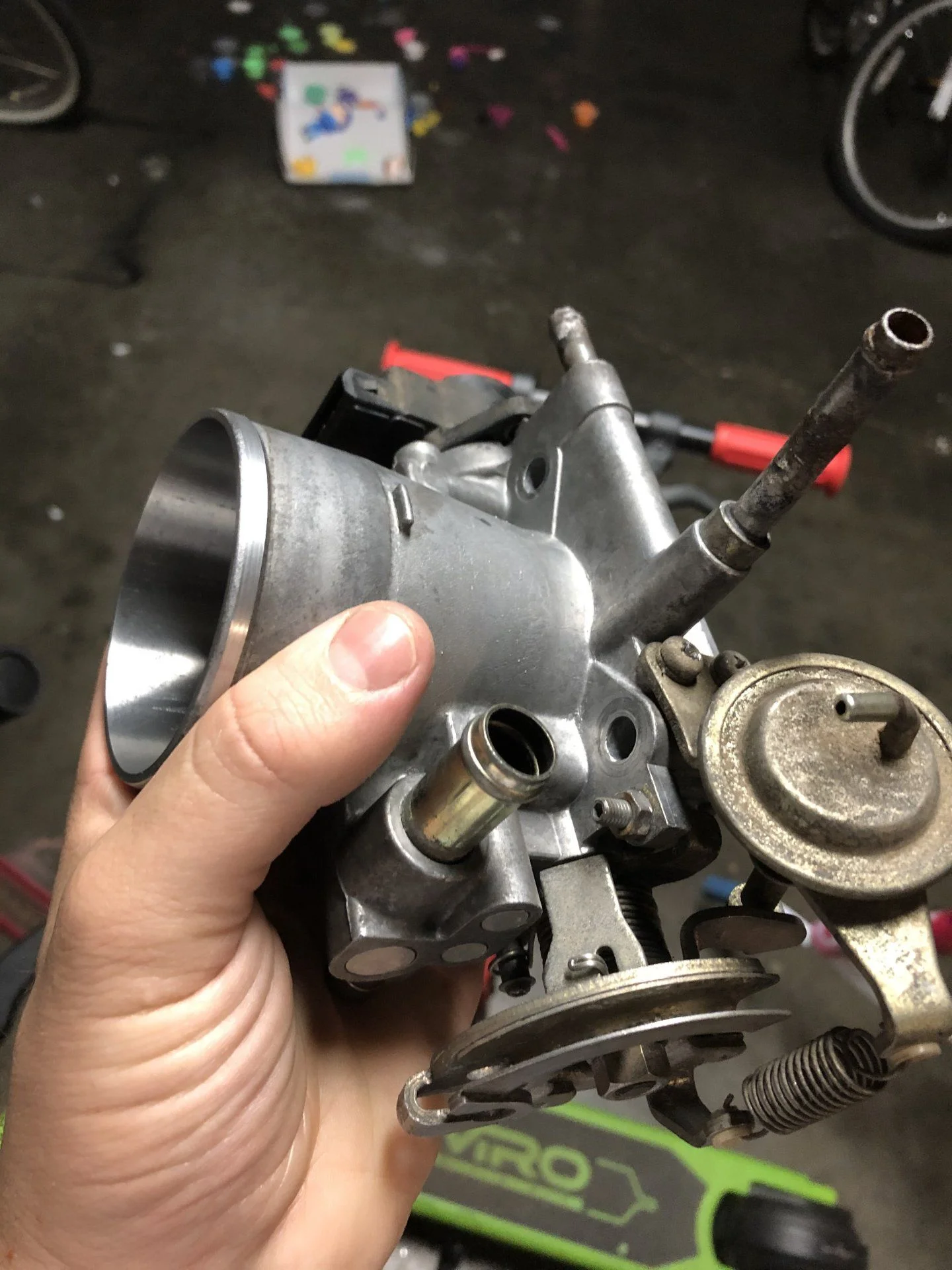

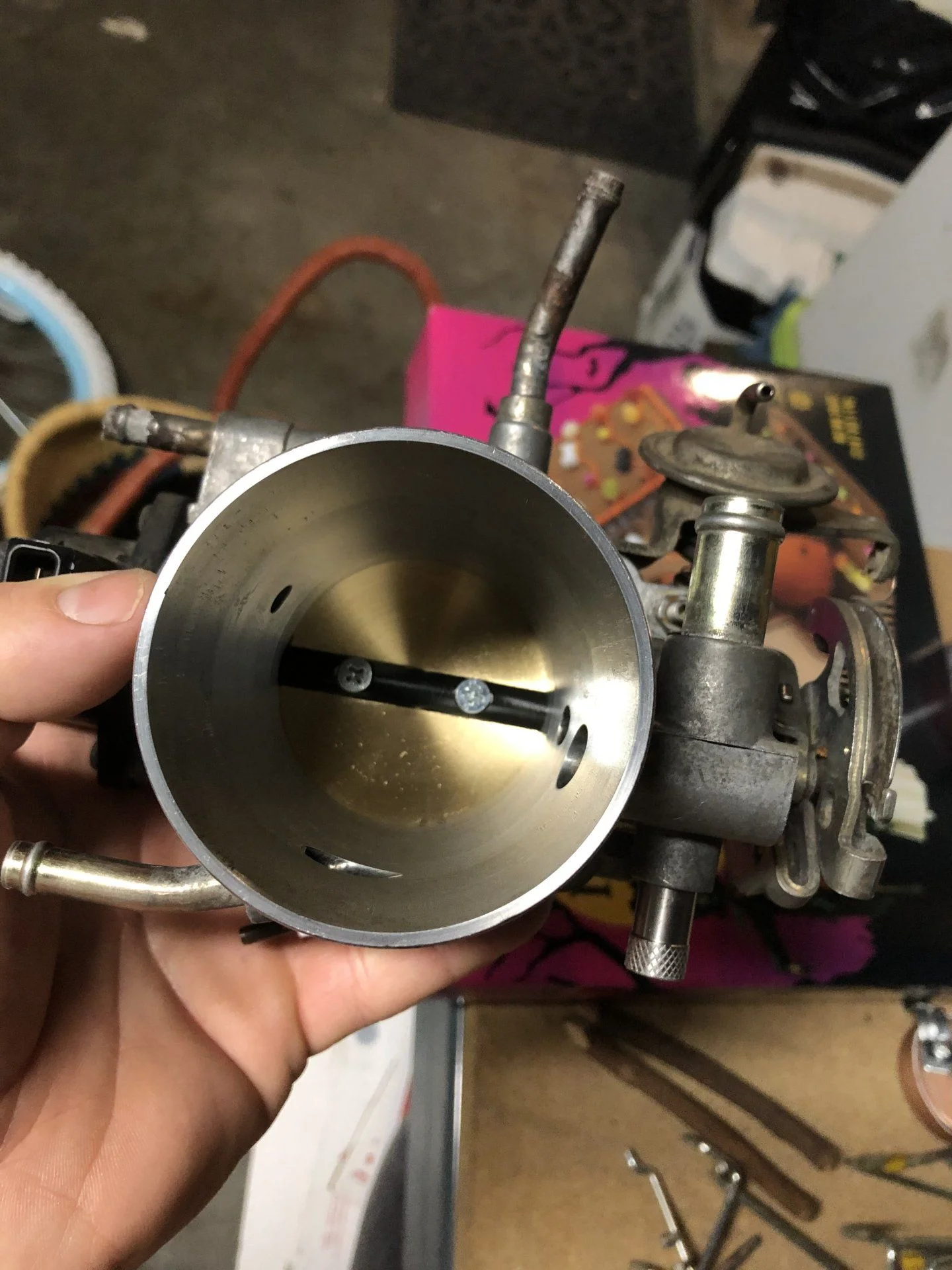

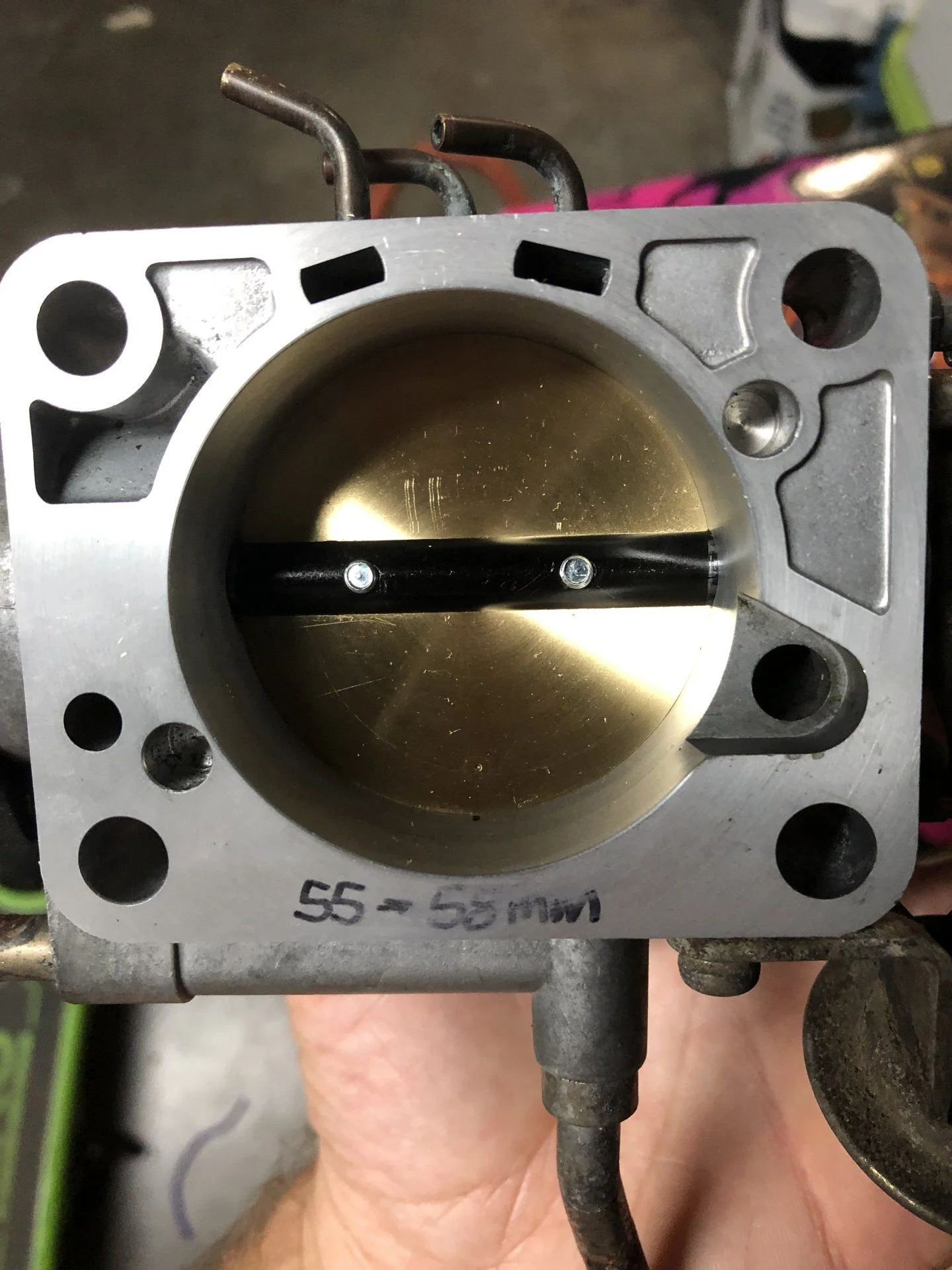

Throttle body has been sent out to Florida to be bored out and cleaned up. Injectors have also been sent out to be rebuilt and gone though. The head on this rig has been done within the last few years so I’m not going to waste money on it. I’ll have it checked for warpage and maybe decked a little if necessary. Need to throw this engine up on a stand this week and start breaking it down. My machinist has agreed to push me to the front of his line if only give him the lower block. I’ll try and take as many pictures as possible so this entire process is a bit more entertaining.
You pulled the intake before the engine? I have always taken them out while still on. It's much easier to remove once the engine is on the stand. Just curious...
Diesel swap time :)
But then, I'd have a petty 22R over the lousy 3Y and 4Y / 4YE engines we got in Australia.
KLF, 100% agree with you there. The only reason I pulled the intake was because I was wrenching solo for a few days. While waiting for an extra set of hands to pull that engine (and since I had already set aside the hours to prep the bay for pulling), I decided to just keep on pulling parts to capitalize on time. Plus my snap on electric ratchet makes taking things apart a dream. Trying to have as much fun as possible. Something about building an engine for someone else is far less stressful than your own...

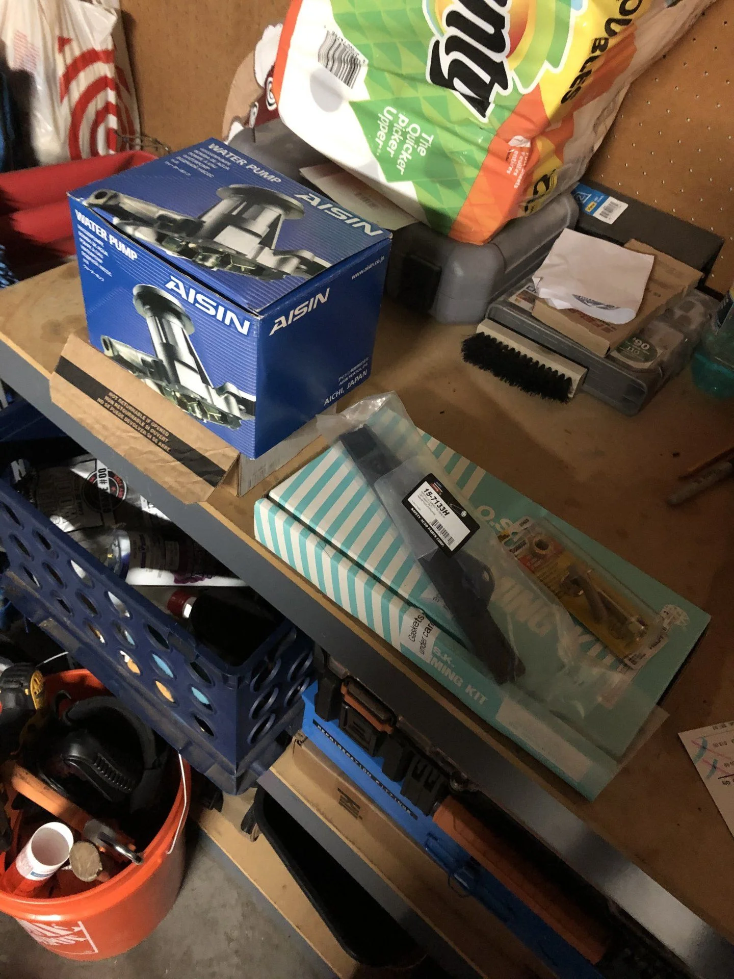

Got some parts in the mail today. Love getting Toyota parts in the mail, even if they aren’t for me...

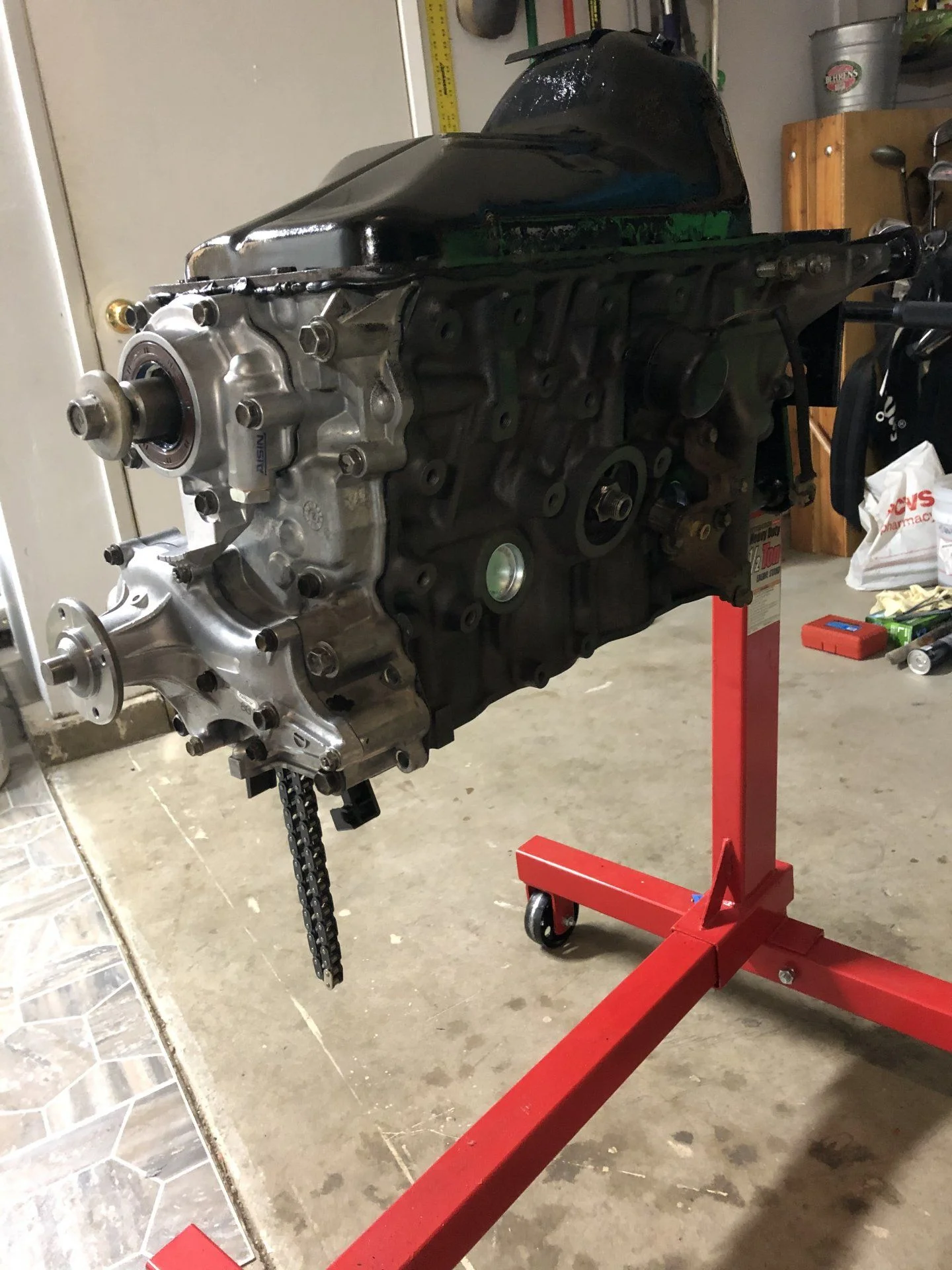

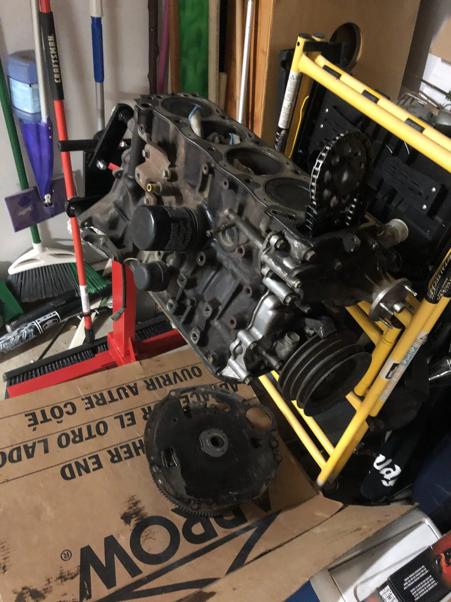

More progress tonight. Prematurely gave up my engine hoist so I had to rip all the weight off this 22re and lift the thing up onto the engine stand. Doing this entire build at his parents place so I don’t have the luxury of my usual resources. Taking this engine to the machinist on Friday and going to enjoy 6 weeks of relaxation.

This is in my future, and I’ve got a couple questions:
Why bore the throttle body, and what shop in FLA is doing it?
Who is rebuilding the injectors, and what’re the pros and cons of rebuilding vs. buying?

Big bore throttle body equals more air delivery. LCE wants $250 plus core for their big bore TB. I found a company called
max bore in Florida. He does really good work. Completely rebuilds the TB and custom builds a new butterfly. Runs $150. Had my TB done by him and was very happy with snappy throttle response. Injector rebuilding is nice because he balances them for you so your engines idles and revs super smooth. Again, had my last set of injectors done by Dr. Injector out of Rancho Cordova, CA and was very happy with the quality and service. He gives you back your injectors with specific cylinders for each injector to go in.

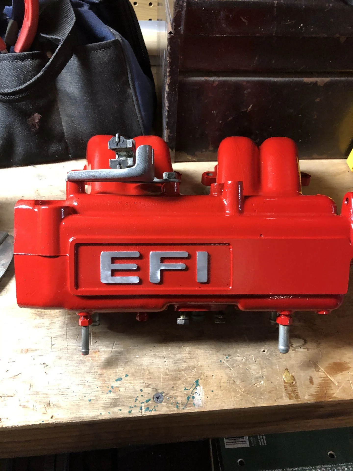

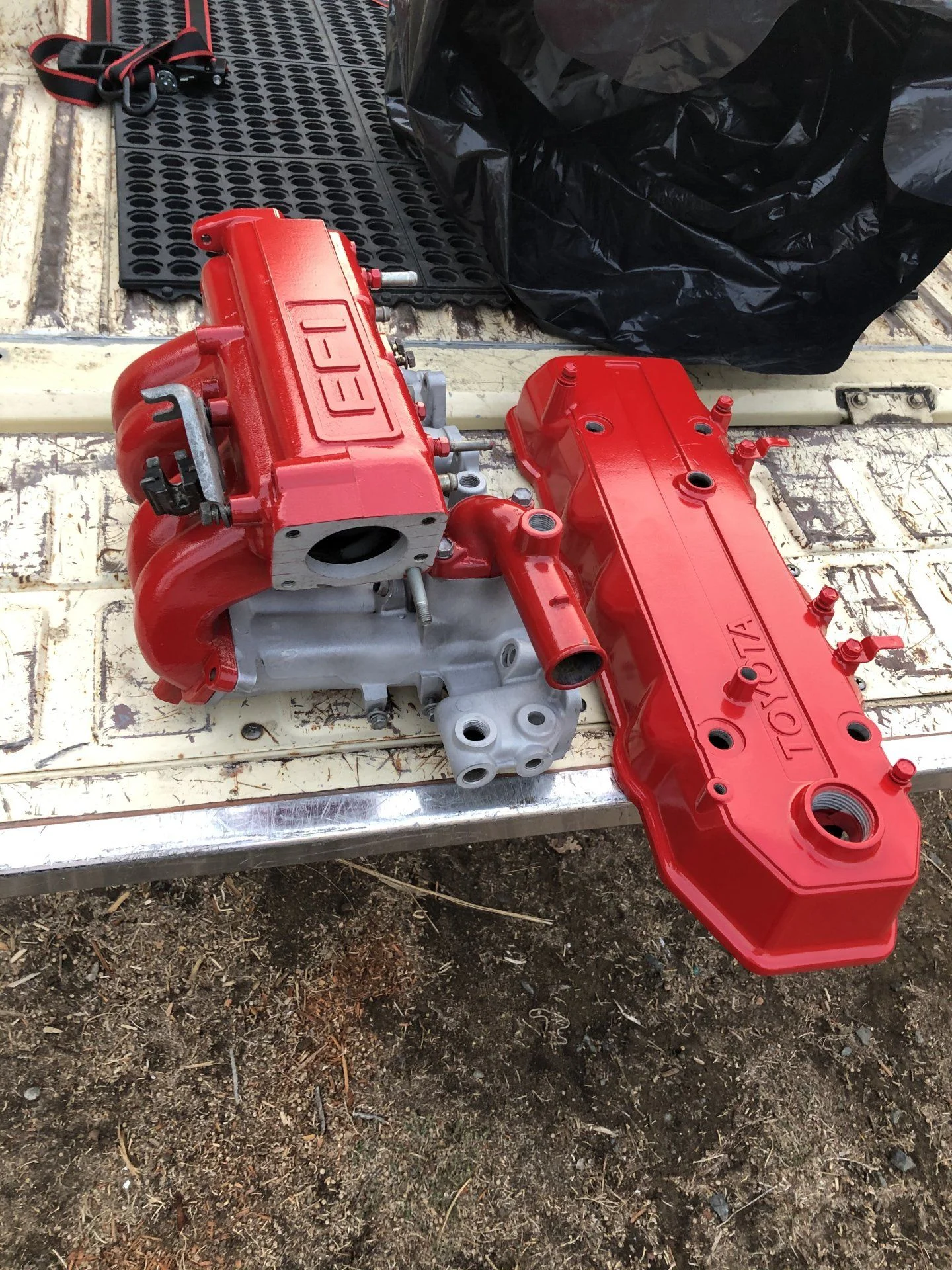

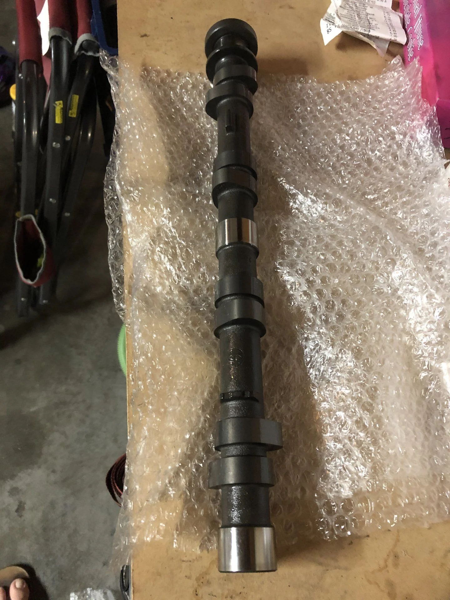

Speaking of said things... got my cam and TB back today. Both look great. Very happy with how this build is going so far. This weekend I plan on taking the upper intake and valve cover to my shop to powder coat them. Gonna do a bright red on both then sand down the lettering to polished aluminum. It’s gonna be awesome.

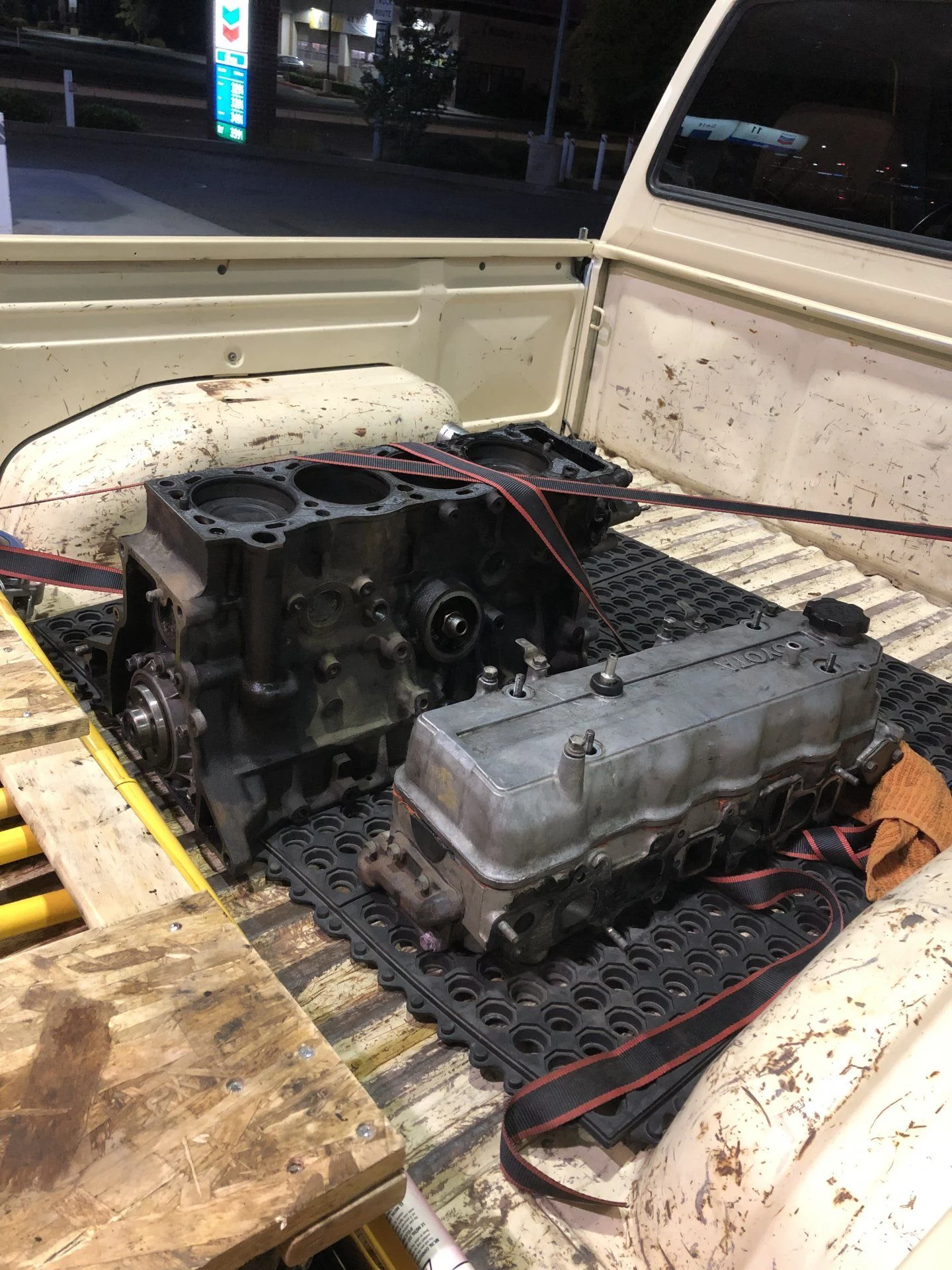

Finally got the lower block back from the machinist the other day. Completely forgot to take pictures but I did remember to get a photo of the pieces I powder coated for my buddy. Can’t wait for the engine to start going back together. This is the fun part

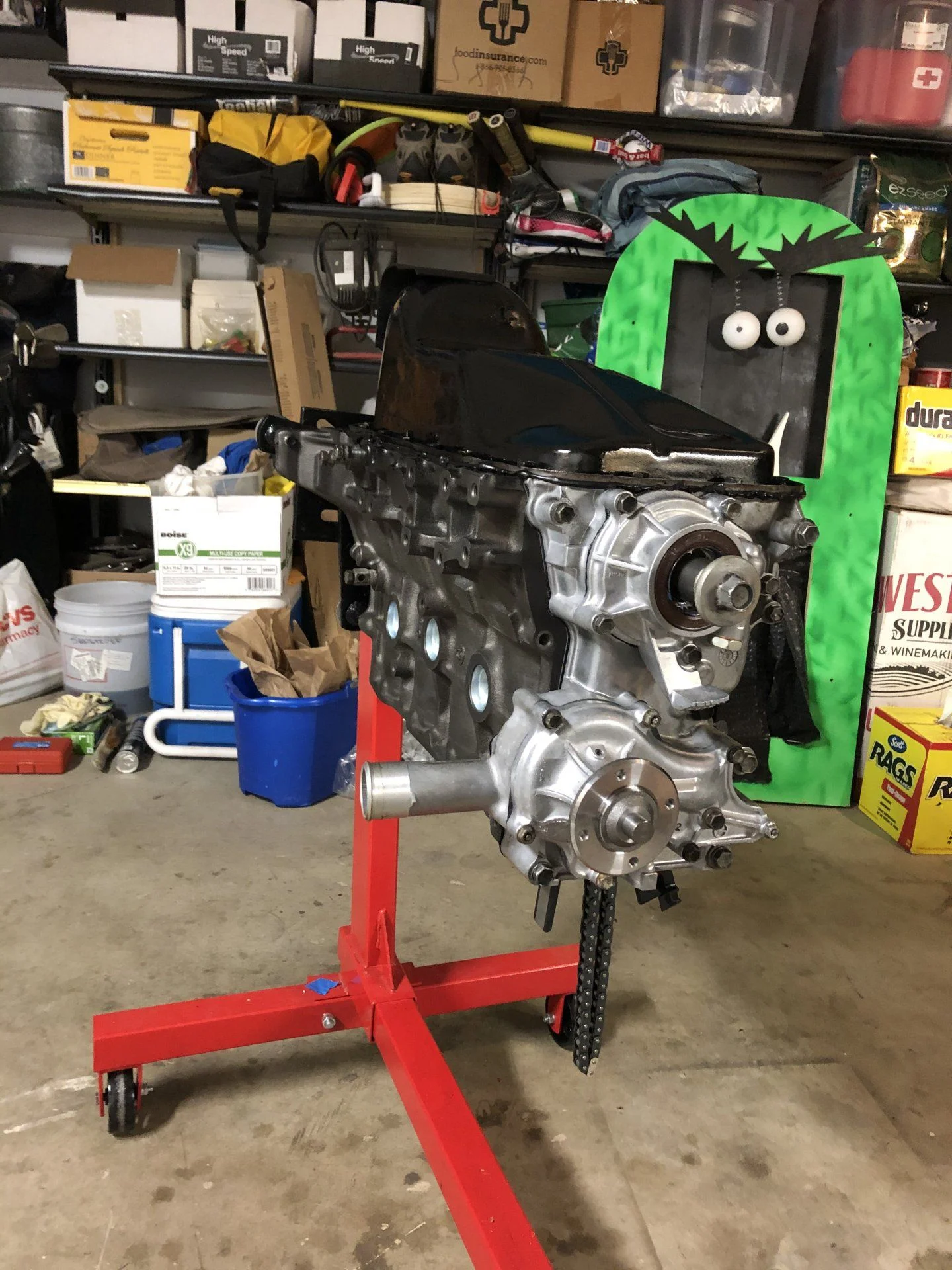

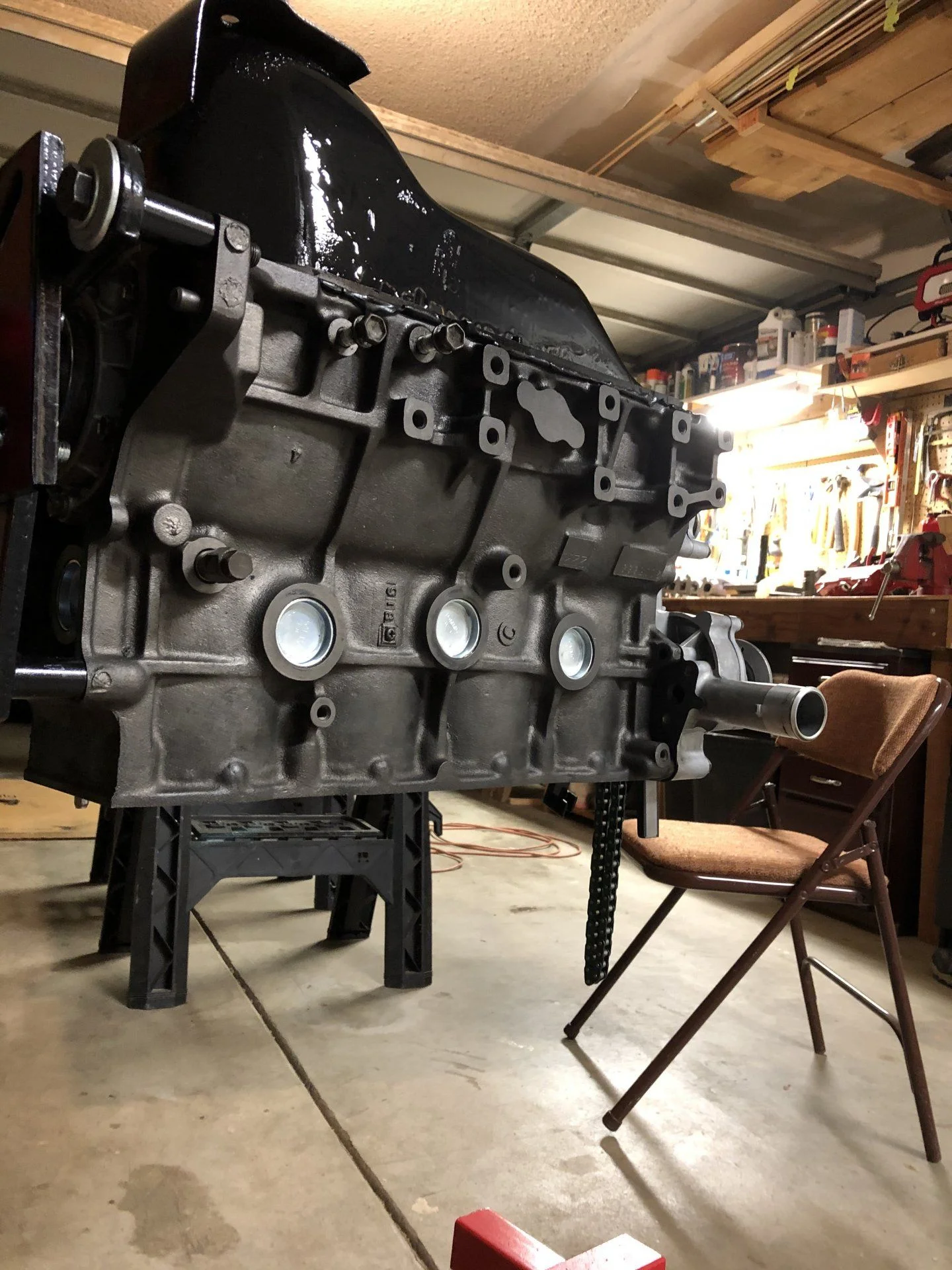

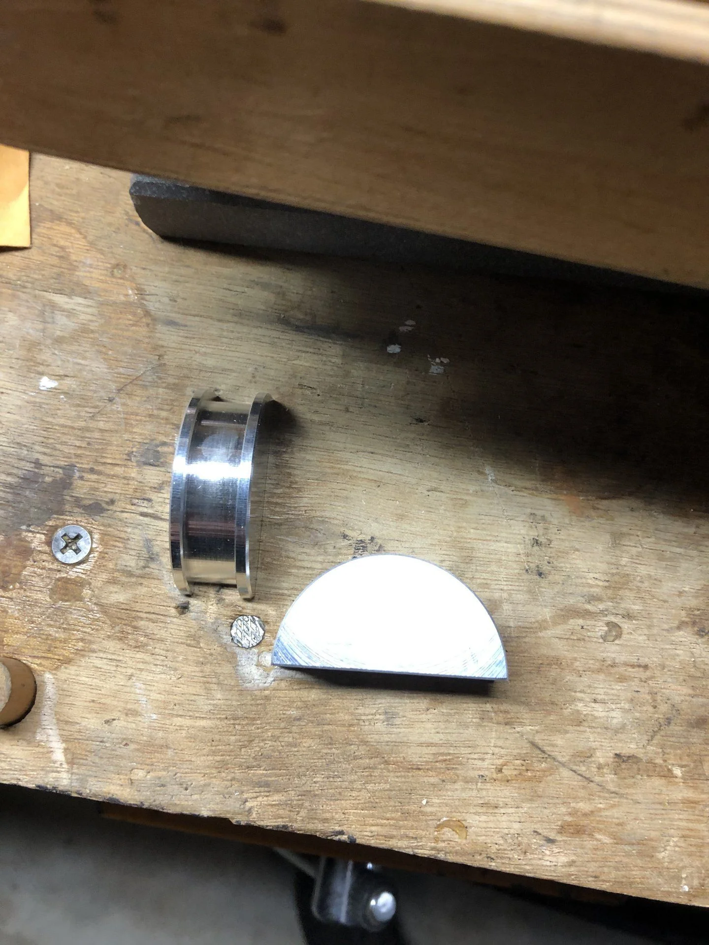

Got some pictures of the block tonight. Head should be back early next week but got done what I could for now. Decided to remove the powder from the EFI logo on the plenum. Turned out pretty good. Also picked up some aluminum half moons from 22re performance.
