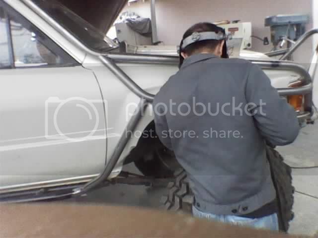

I built this cage out of 1.75" DOM tubing .120 wall.
thats pretty awesome.
any in action pics?
Looks nice. You TIG'ing that?

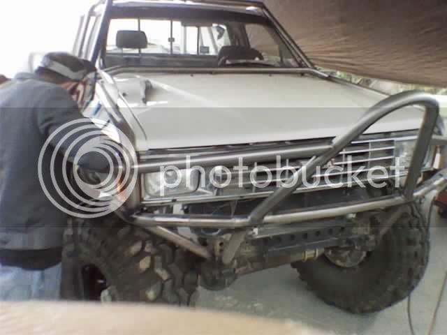

I'd be a little worried about how close some of the tubes are to the sheetmetal. I think you'll be surprised how much the body flexes around in serious flex situations, it may rub/grind.
How you gonna paint it? Heck, you could probably just put a coat of wax on it.
Yup TIG welded, Well the owner of the truck wanted the tubing close to the body so that's what I gave him, I masked the body and painted the cage black no over spray. As far as rubing and grinding, the guy doesnt care he wanted to be protected since he had a couple of close calls with his previous vehicles.
Holy Constipation Batman! You TIGed that whole thing!?!?
Remind me to pray to you tonight.:eek:
LMAO, it was windy on the final day of welding I was about to kill someone but there was no one around. I hate the :censor: wind.
