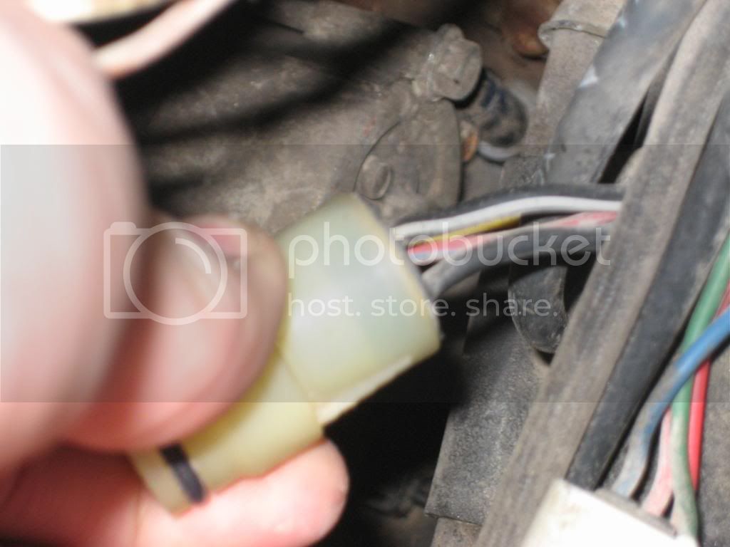

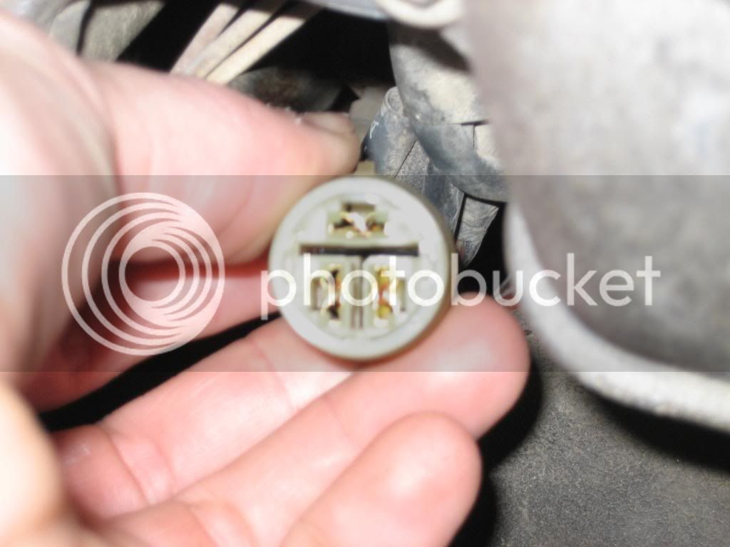

1. Have this done out in the garage, Gotta put pants on and get a pic.
cross the 2 heavy black wires 2 vetical terminals (1 black, 1 black w/white tracer)
