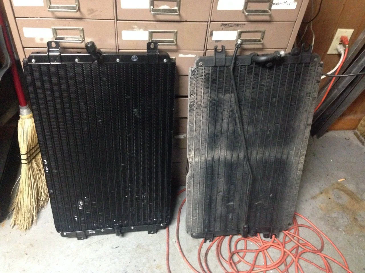

Early on the left, later on the right
img_7816-jpg.1044404
I called Coolstream today and they said that i needed Denso 477-0154 for my cruiser but after looking at my actual condenser, it looks like the picture on the left in "SpikeStrips" post. Is the picture on the left Denso 477-0155?
477-0155 appears to be discontinued for pre - 4/85 trucks with AC.
