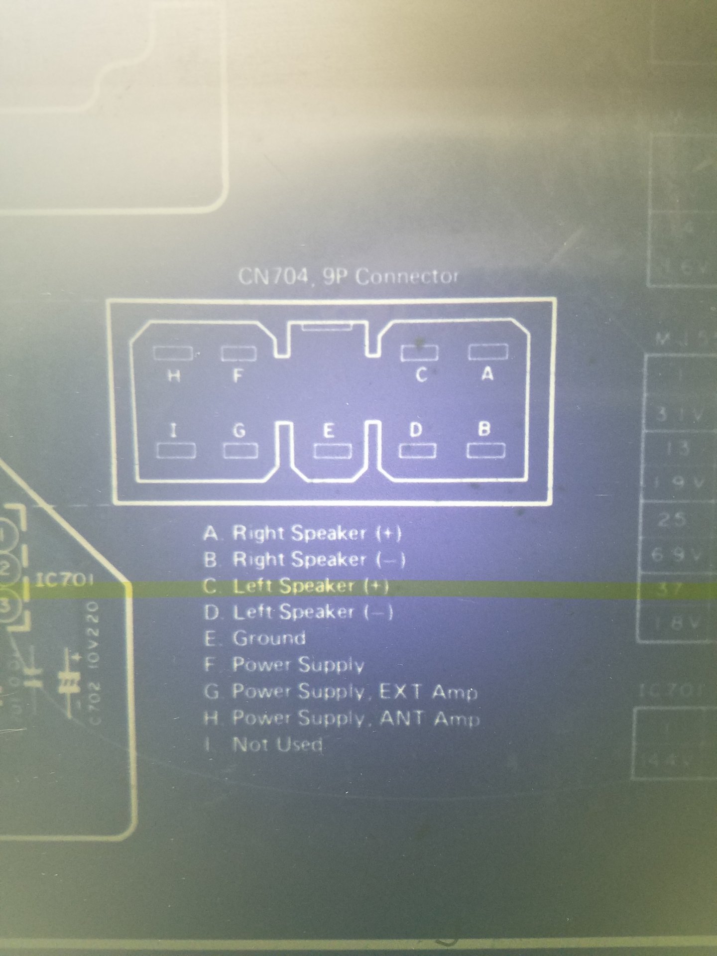

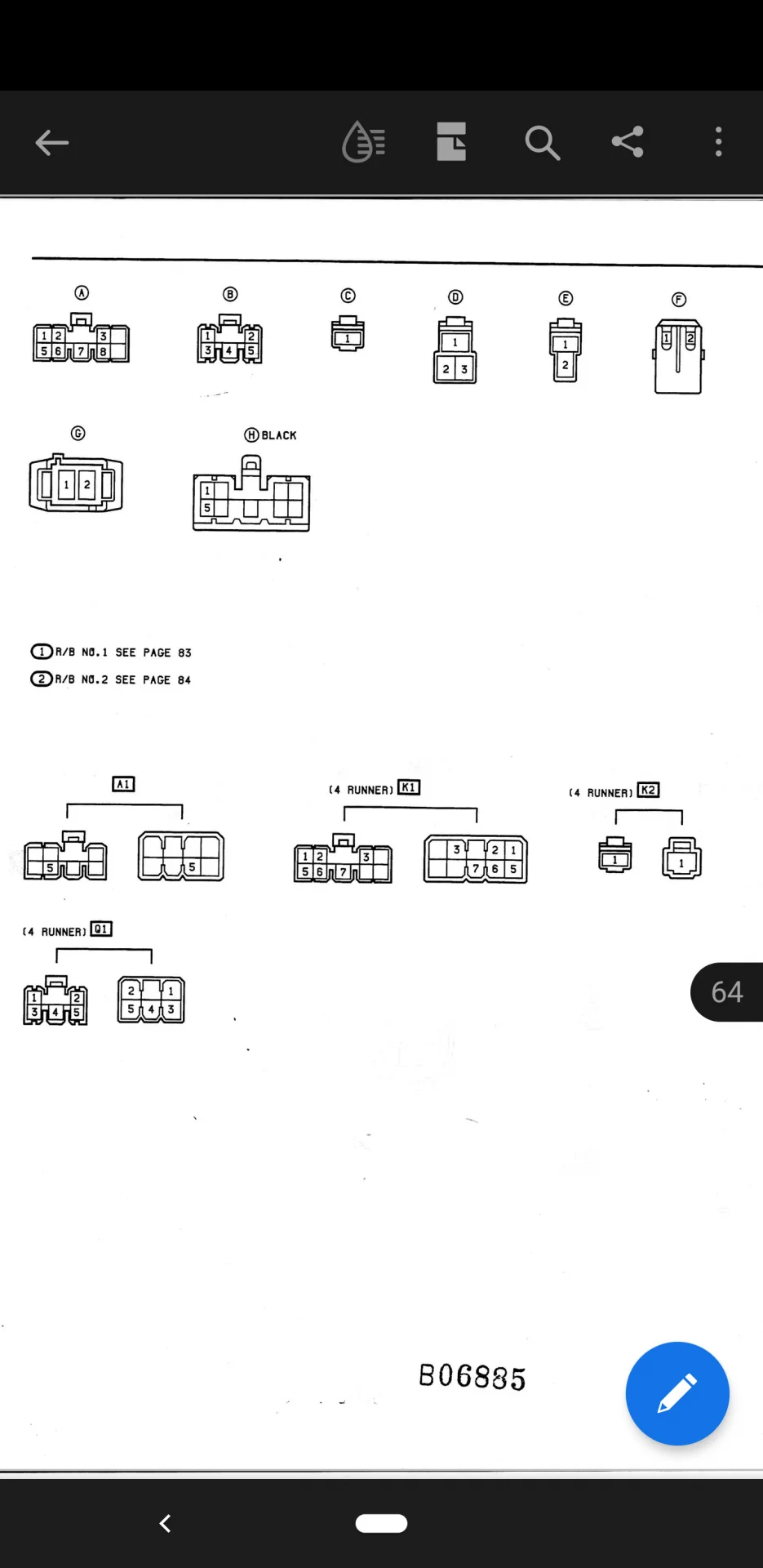

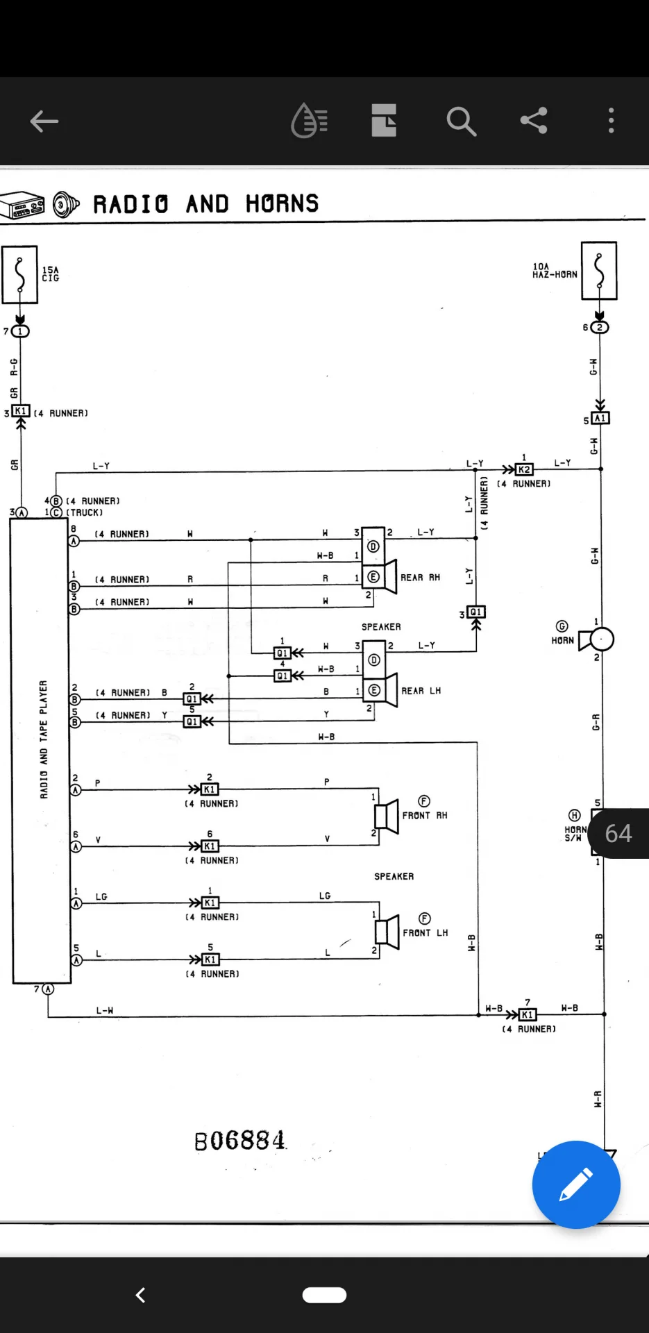

I have an 86120-17050 radio used in the 84-86 pickup. I have spent some time searching but cannot find a pinout for this thing. I have the wiring diagram but am missing the connector diagram. It has a single 9 pin connector but only 8 are used. Can someone please snap a couple pictures of one for me. Thank you.
Here.

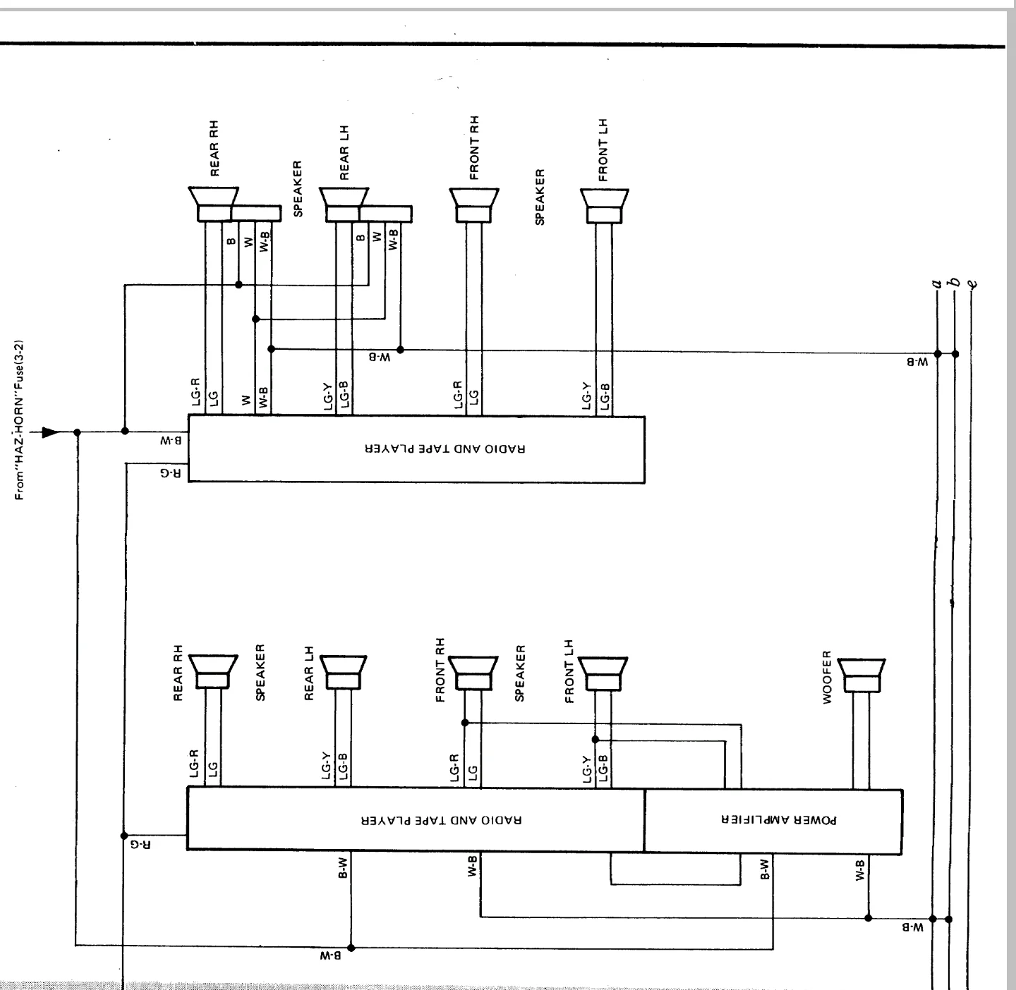

Thanks for posting. That is not quite what I have. Based on testing, I get this (looking at wire side of the plug):
+12 LCH+ RCH+
NC GND LCH- RCH-
It appears to be a single plug system with 4 channels.
According to the manual, this is true for 86120-17050, 89120 and 89124
