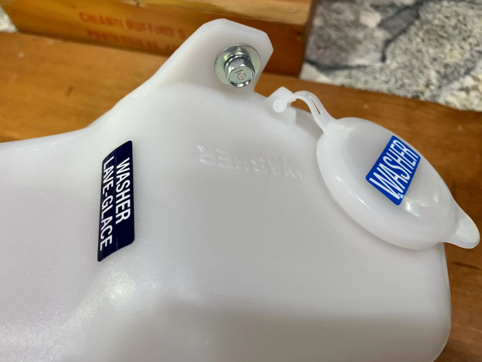

Reviving an old thread, I'm at the tail end of installing my new washer bottle as my BJ60 also came with no washer bottle. Wasn't so bad during the summer but now that winter is here it's a getting pretty brutal. Anyway I have the exact same plug in the posted pic above, I just have a single strand of wire harness but it's the only empty plug and it's right below my washer bottle - so safe to say that it's the same plug. My rookie question is can I just use two male spade connectors on the OEM wire harness plug? Or should I change out the old plug? My first thought is it doesn't matter as long as I get my ground and positive wire in the right connectors in the plug, but I know next to nothing about electrical so looking for some input before I start causing fires
Are you sure you are looking at the location of the windshield washer bottle (near the location of the antenna) and not the headlight washer bottle? But anyway, both the motors for the washer pumps seem to need two wires. One comes from the fused power source and the other goes to the switch on the steering wheel stalk. The circuit is grounded after the stalk. Can you post a picture of the plug and where it is located?
This is right beside the antenna using one of the bolt holes that the oem bottle using. I thought the oem washer pump had the male end of that plug right beside the new bottle, it seemed way to convenient to not be for the pump. It is two wire but I also wasn't sure which one goes to the fuse and the other to the stock or if it mattered how I wired it
