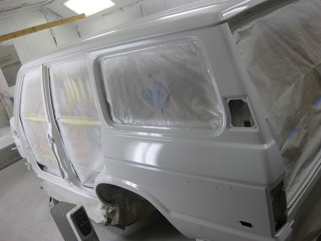

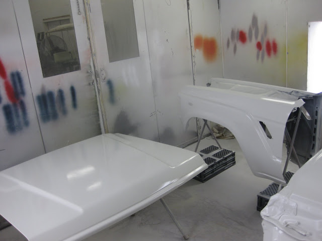

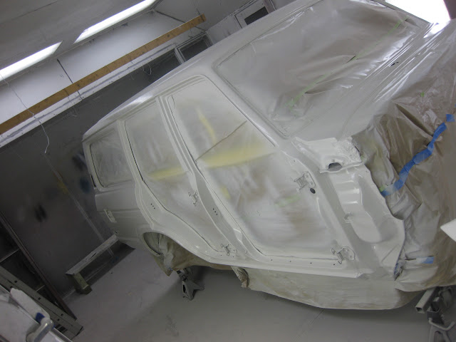

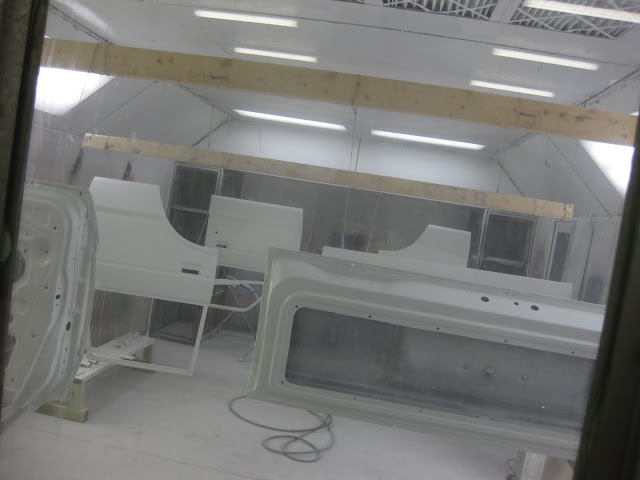

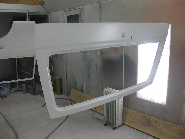

Alright, quick update & then time to go to sleep.
Got some more sealer today - PPG DPLF; stuff shot wonderfully. Laid it on the doors, tailgate, & hatch. Let it flash for a few hours while I started sanding the body/fenders/hood.
Started shooting base at about 9:00. Couple quick pics. Base went down great; starting to look like a real truck!
I'll shoot clear on all this stuff in the morning. Let it flash off, unhang it all, finish sanding the body, fenders, & hood, seal it all, base it all, and hopefully clear it tomorrow night!:p Wish me luck. Very well may be our last warm day tomorrow & I've got to go back to work Thursday.
:beer:

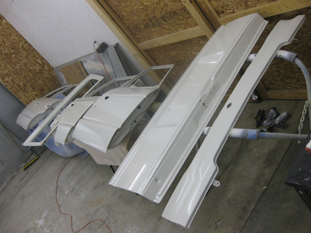

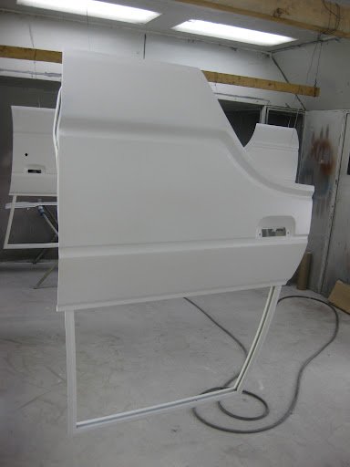

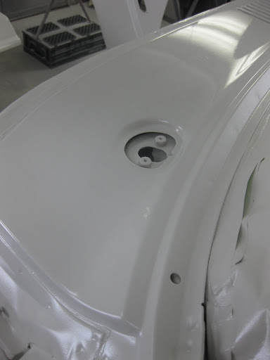

Here are some pics after base & clear. Ran into some difficulties with base that I was luckily able to work around. Here are some pics:
I'll post more in the sunlight & after I get her back home.
Time to start reassembly! :beer:
