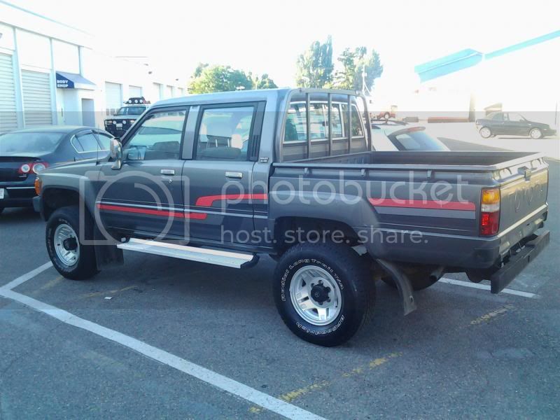

Here is how the truck looks.
I think it looks good as is, and would run it that way with 31's. Do you haul good sized loads regularly, and experience too much sag in those conditions? NW offroad has 2 inch lift springs, including an option for rear overloads for those looking for more weight carrying capacity. You could also have Alcan make a custom set of springs for you.
