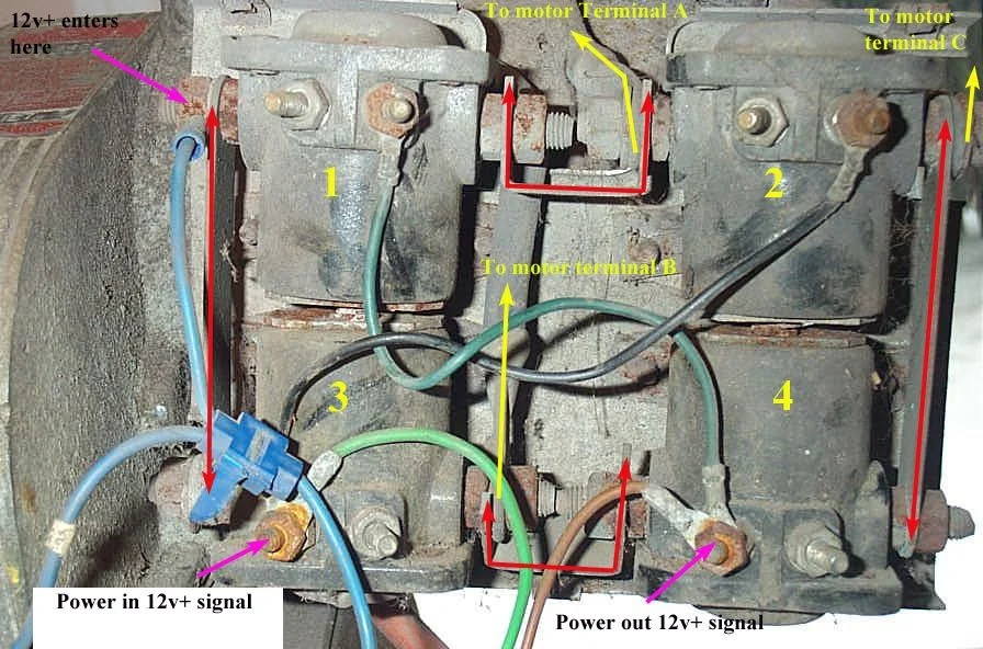

So last year I found that my switch spooled out when I selected "in," and it spooled in when I selected "out." So in addition to replacing some seals since it was leaking I attempted to correct the wiring.
My solenoids were wired up just as in the picture. (Stolen from here) So I figured I could simply switch the brown wire coming from the switch and going to solenoid 4 with the green wire coming from the switch going to solenoid 3.
Seemed to do the trick with no load. But, once I started to spool up my cable I noticed the winch spooling in with the switch pressed in either direction.
I'm going to try getting at it again today and just switch the wires back to see if I have bi directional capability, even if it's the wrong direction. Any other thoughts?

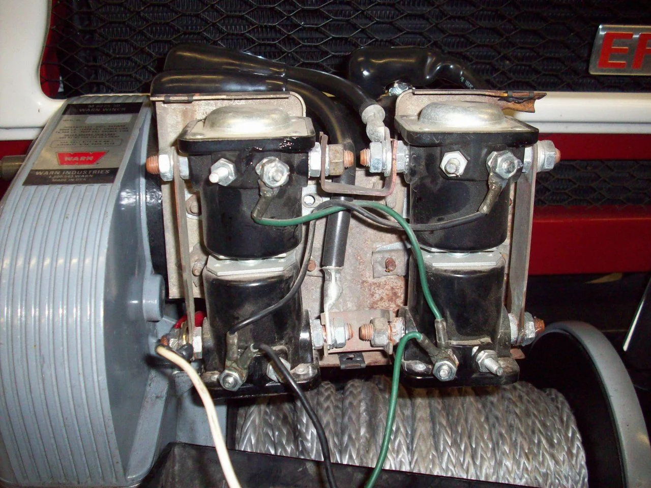

I hear what you're saying, but I can see the drum spinning the same direction regardless of the switch setting. So it's not the line getting stuck. I forgot to add, I went ahead and switched the wires back and it still only spools in. At least I would have expected it to only spool out. Here's a pick of my actual wiring after I switched the black and green back. Open to any and all thoughts.
Bad solenoid(s).
Yep! Upon further investigation, the PO rebuilt with starter solenoids. So now I need to find the no longer available 2040 solenoid. Does anyone have a part number for a suitable replacement. An Albright is too much work to get done correctly, before I'm headed to Tornado Alley's Fall Crawl.
