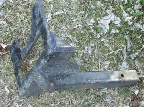

You can have the mount that I built, it's made from heavy plate I will weigh it and take a couple of pictures.

Ok tomorrow around five I will take some pics and weigh it and post them up here asap. To bad I'd meat you in Omak...we go there usually when we are "over the line"...yup only 45 minutes further.
Here you go greenweenie40,
Weighs 15-20lbs (my scale is for bigger stuff but I think thats close).
I will PM you.
