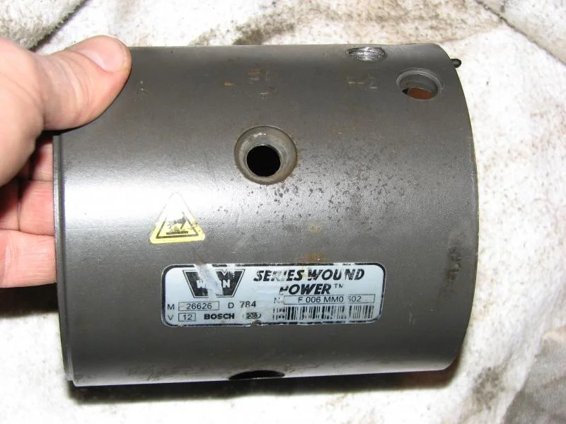

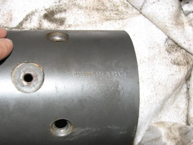

Motor seems to be a Bosch that is made in Brazil.

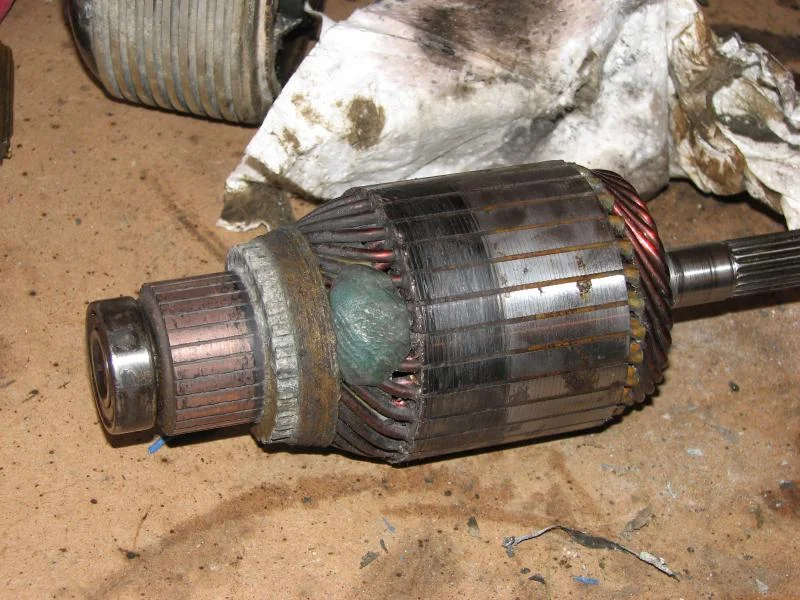

The rotor looks to be in decent shape other than some scuffing where it rubbing against a couple of the steel pieces that core the field coils. I thought this would be due to corrosion behind the steel pieces, but there wasn't any of significance to see once things were torn down.

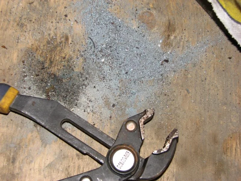

Just some of the loose crap that I was able to knock out before tearing it down.
The rotor came out easily with the ugly bearing stuck to the shaft (I understand earlier motors have a bushing here?). The bearing in the winch case was driven out with a brass drift through the opening for the free wheel clutch.

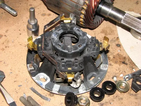

The two long bolts that run through the motor were carefully backed out, since they were crusty themselves, it took patience to get them out. The end cap was knocked off, then the brush assembly was removed after a bit of a soak, and pulling out the one small Phillips screw that holds it to the motor case. This assembly seems to be composed of an aluminum base structure with plastic molded over it.

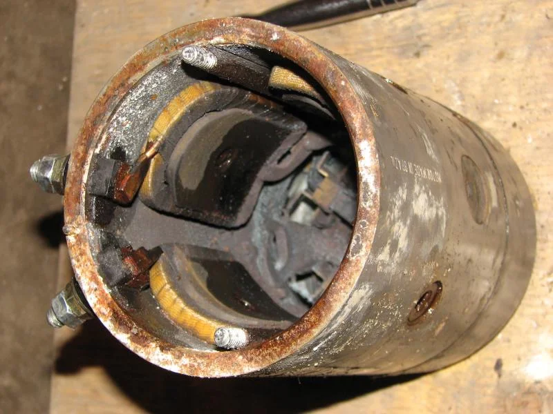

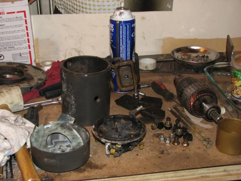

Here's how it looks at this point.

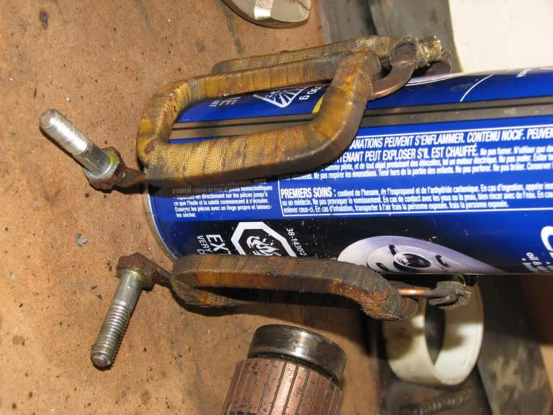

Field coil assembly after a wash down with brake cleaner.

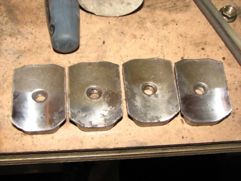

Steel pieces that retain the coils (and strengthen the magnetic field?) after cleaning up. The spots that were interfering with the rotor have been cleaned/ground back with a flapper wheel and drill. The rest will get a bit of a polish yet...

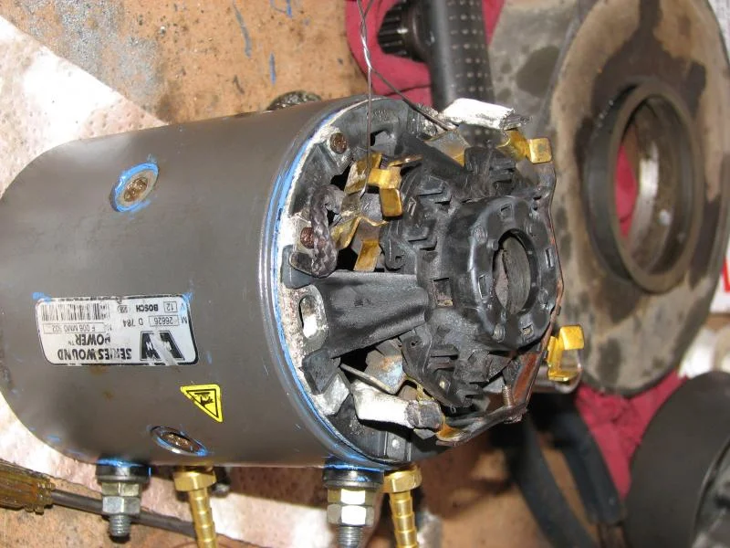

A pic of the brush assembly.

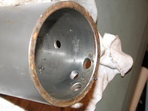

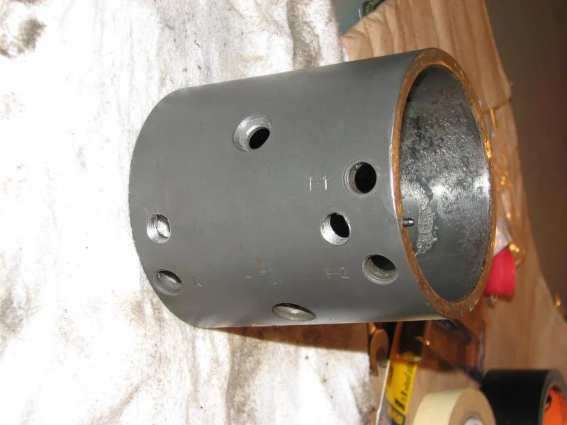

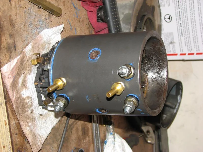

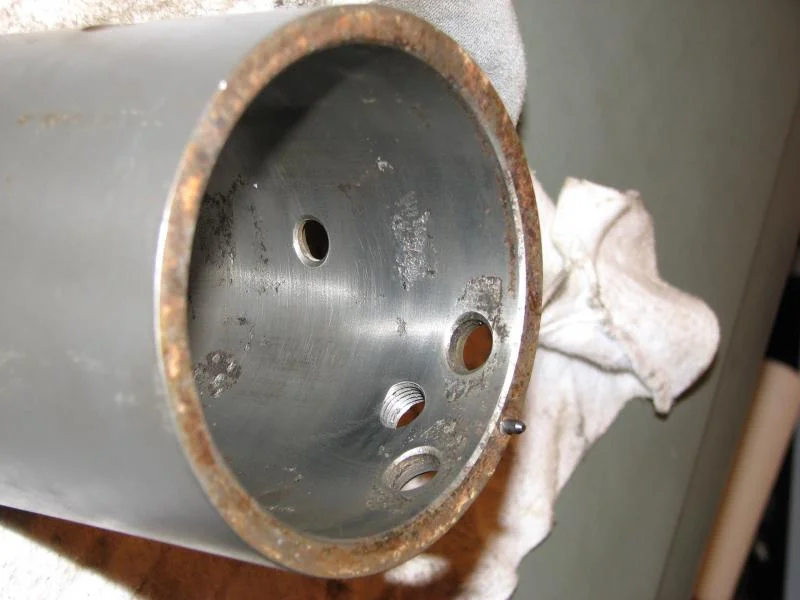

The case cleaned up inside (flapper wheel again) with two new openings drilled and tapped to accept hose barbs.
That's where I'm at right now, time to start reassembling.

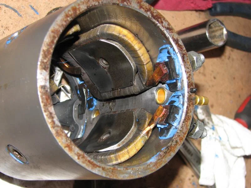

Field coils, brush assembly and related paraphernalia put back in. Breather barbs loosely in place (I'll cut them down some before sealing them in place. Liberal use of blue gasket maker to keep the outside world out and inside world in. I wiped anything I was worried about corroding again with a bit of ATF.... hope that was a good choice.

All back together, wired up, hit the switch and........ :hhmm:
Could see sparks inside through the vent holes. Turns weakly in the unspool direction, won't turn at all in the spool direction. This is with the free wheel clutch disengaged. :bang: Guess I'll check with the multi meter to see if there is a short I can identify and if not call it dead.
Okay, after going back out, I figured out that my ground bolt was just too corroded to do the trick, so I swapped in a fresh one (need to pick up a stainless). Still much the same, but not as weak.
Hmmm, I used to have to jiggle the remote connector to get it to spool sometimes. Sure enough, now it spools and unspools. But, when I hit the switch some times (I'm assuming some positions of the motor) all I get is one of the relays clicking in and out really fast. I assume that is an internal short?
When I was reinstalling the rotor, one of the brushes chipped off the face and left a rough surface... could this be the cause?
I'm curious if I can source a Bosch motor direct from Brazil? I don't know that mine is the same, but it should fit. :meh:
I believe you can swap a newer style motor into an older 8274, but need to change out the gear that rides on the motor shaft with it to go from a keyed shaft to a splined shaft. IIRC awl_teq shows this in his rebuild thread... You can get a Warn replacement motor off of Amazon for <$200 (not sure if they have the gear on there too though), and knock offs for cheaper. From what I've read here some of the knock offs don't last even a year.
After throwing the battery charger on the truck and running the motor a bit more, it seems to be getting better. It doesn't seem to be hitting the "dead spot" as much, runs stronger in unspool direction than spool direction (maybe I need to clean all the contacts in the solenoid pack again...). If I have time before I head back to Manitoba in the next couple days I'll do that and wire it up with the heavy leads (I've been using fairly light booster cables to test) and and see if it seems ready to spool the cable back on.
All done up with clean tight connections and the proper heavy leads it seems to be good.
