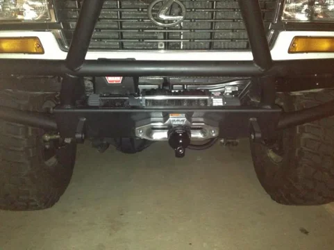

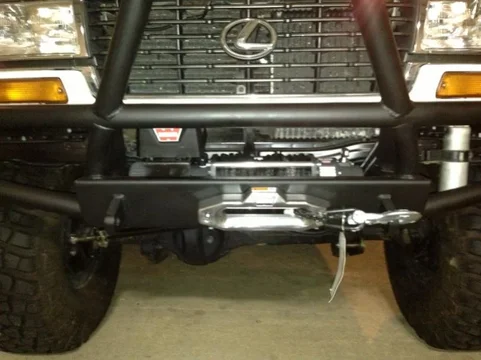

What's different in the pics?

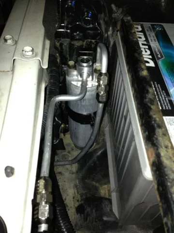

Will update with part numbers for the dryer that worked, but bought a JDM relocate kit in Classifieds.
Went to a local shop to have evacuated (intended to do it myself ) but the owner expressed concerns over the JDM joints ability to seal and offered to weld instead. Had them do, with intention of cutting the fittings off and welding.
Came back an hour later and they'd installed with fittings, stating the welder never returned from lunch. Haha.
Anyhow, guy said that it wouldn't be too bad a job for a competent shop ( I asked his opinion of kit) and that it could be done pretty easily, under the expense of the JDM, if the later model dryers would fit in box. ( Going to check in a few ).
Asked him how much, and he said it'd be a $150 job for just the line work, add evac and recharge to that, plus a new OE dryer. ( Dryers are $58.00)
Again, that's IF the later years fit in the battery box, otherwise the fittings couldn't be reused
Don't subject yourself to.
Interesting. I've got 300k on all the original A/C components. No issues ever. It was evacuated and recharged once in its life when the motor was out....shoot. Ok make that twice :bang:
The JDM kit I have uses a fitting ( tech called it by name, but don't remember what it was. Says "FujiKing" (?) on side ) that compresses against a fixed center, unlike the OEs I saw come off.
I do have all the lines from my 97 OE if someone wants to mock up. One is cut , but fittings are good.
Will stick the 97 dryer in box in a second.

Wish you would have had that in Clayton!
That's the reason it's on there, I can't lie.
I wasn't planning on running one, at all, but told myself the first time I held up the trail, I'd succumb.
Well, I held up the trail. Now that I have, I'll never need. Hahaha.
