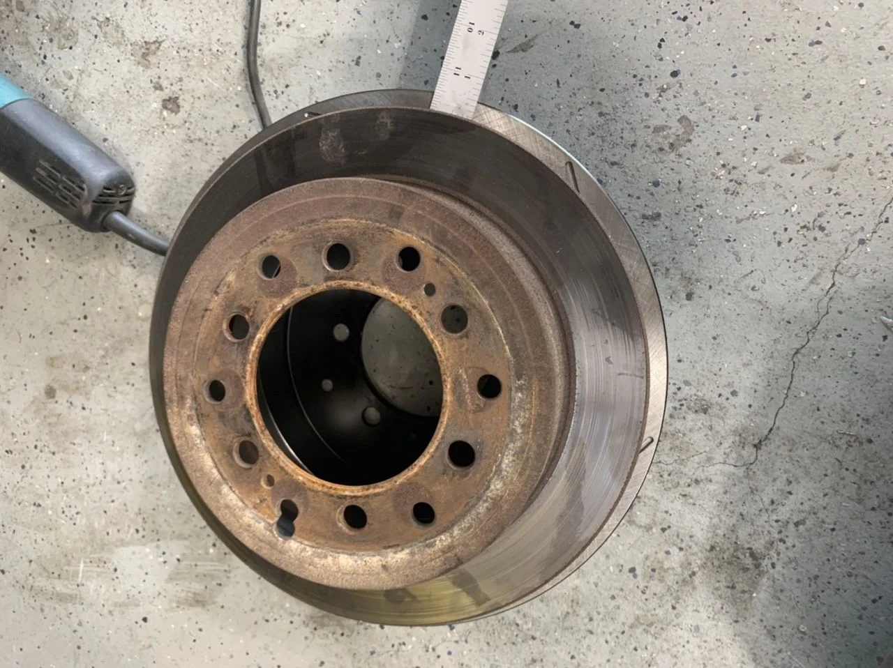

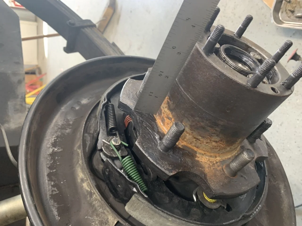

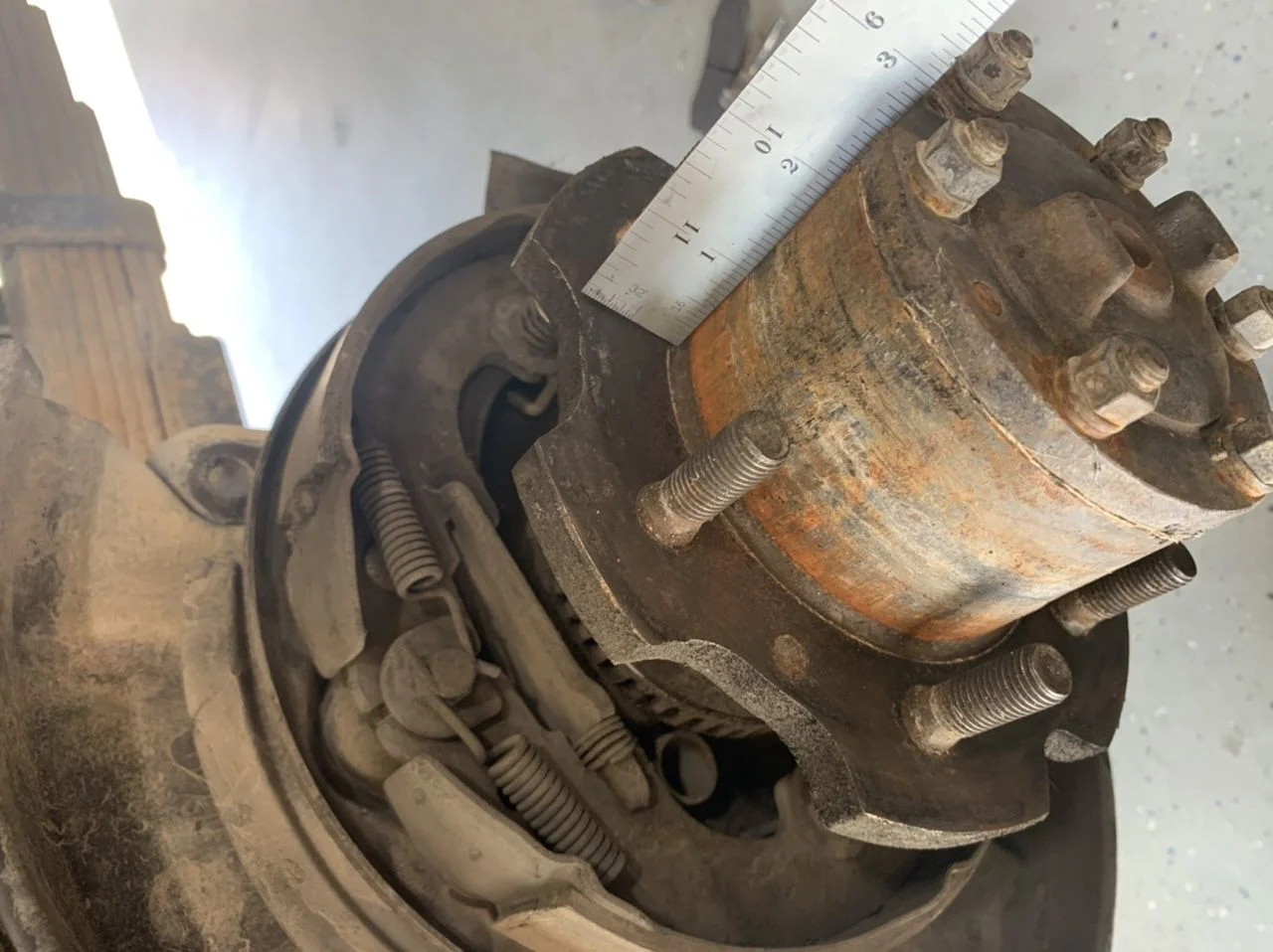

Anyone have a pair? Converting my 70 to the bigger 80 brakes, hoping the hubs were the same but they are not. See some photos for comparison anyone that’s interested in doing the same thing. Discs are about 1” bigger but body is deeper, which is why the hubs won’t work. Requires 80 series backing plates too.
When you select the 80 rotors, mske sure you get the '96 or above, with new calipers. They are a bit bigger as nd way better at stopping.
yep those are the ones i got, actually 93-97 are the bigger style.
