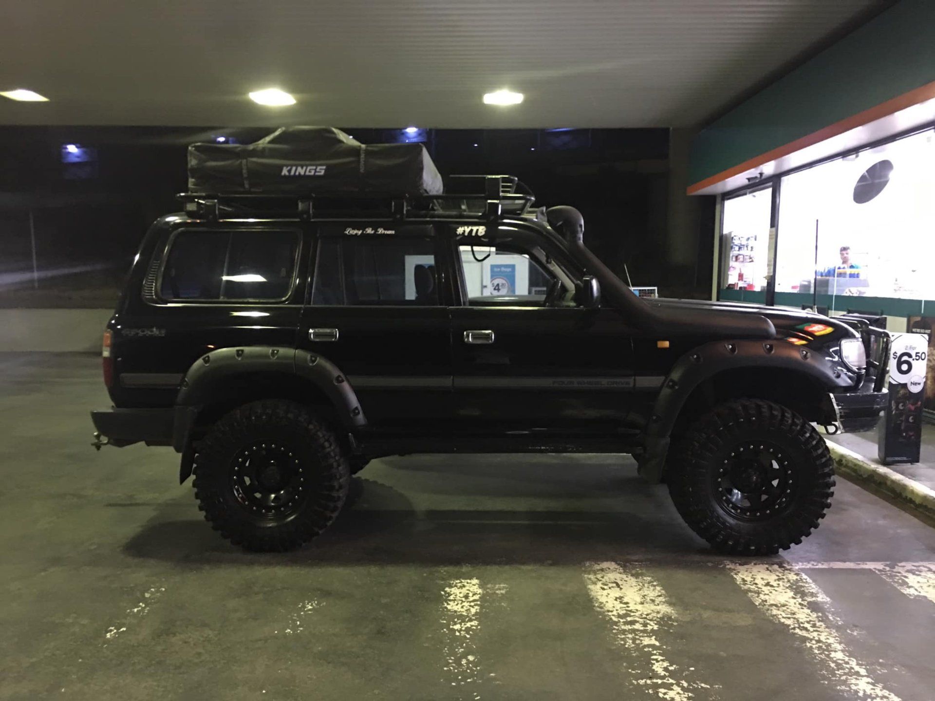

here a pick of my 80

That's a pretty vague set of symptoms - essentially a harsh ride. I suggest you bring it to a 4WD specialist and ask if someone has 15 minutes to take it for a drive and see what's going on. One comment is that it looks like your tires are at a very high pressure and if so there is no suspension in the world that will ride smoothly with rock hard tires. Other than that, I'd just be guessing. But if you can get someone capable of feeling what is going on into the driver's seat you will get good advice.

Yea, kinda hard to tell from the description but it looks like you don't have anything installed to move the rear panhard bracket back to closer in the intended angle?
Mud vendor DeltaVS makes a bracket specifically for this.
I'm running very old OME suspension with also about 4 inches of lift and while I was skeptical that the bracket would help, or perhaps more importantly be worth the coin, after install my rig drives incredibly better over similar terrain. Def worth it!
The stance on your rig looks pretty spot on IMO. I don't know enough about the inner workings on shocks but I'd expect some droop somewhere if they or the springs were totally shot.

Dobinson's Flexi coils are actually a fairly soft spring, and what I would have recommended if you had asked 'What should I buy?' before lifting your truck- if you were running a light load. That does not look to be the case. I suspect the upper wraps of your coils are touching, which would result in you not getting all the benefits of 'dual rate' coil springs. Still, I would try some other approaches before changing out your springs.
