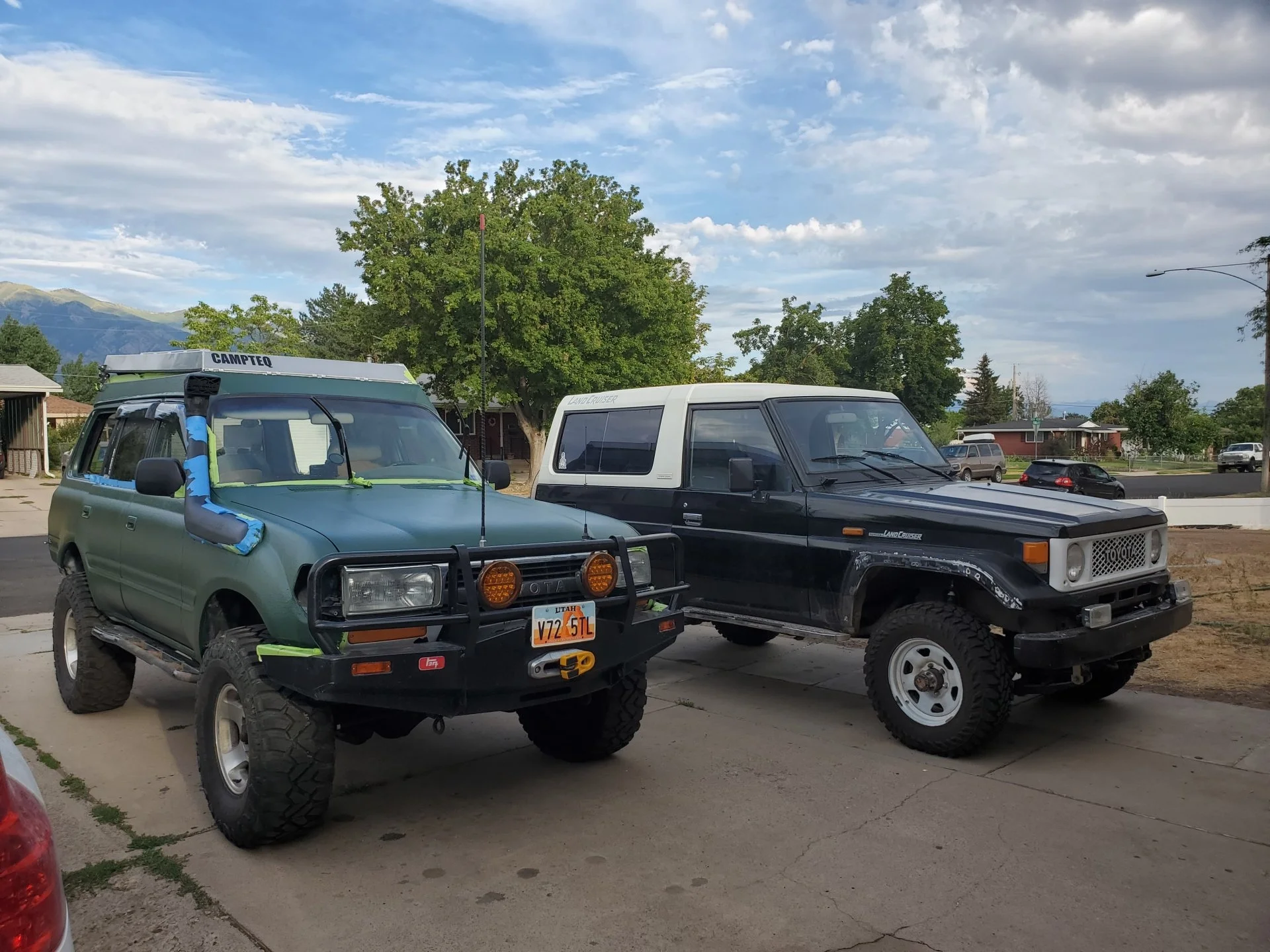

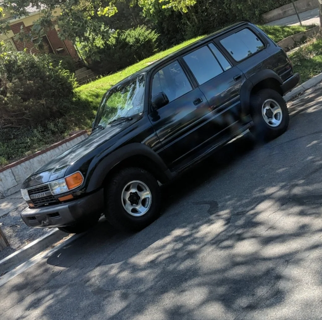

So I thought I'd finally start a build thread of sorts to document some of the updates I've made to my 80 series. Originally (at least within my possession) it started out as a bone stock car with a recently done head gasket. According to the previous owner at least.
This is what it looked like the day I got it home.
Fast forward a few years and after many hours of grazed knuckles and curse words along with some amazing trips where the reliability hasn't wavered we are here:
I tend to have a habit of changing things when I finally get it to start working but oh well. Now that I have a good idea of where I'd like to go with the cruiser I'm confident enough to actually share a little bit about where I'm hoping to go with it from here.

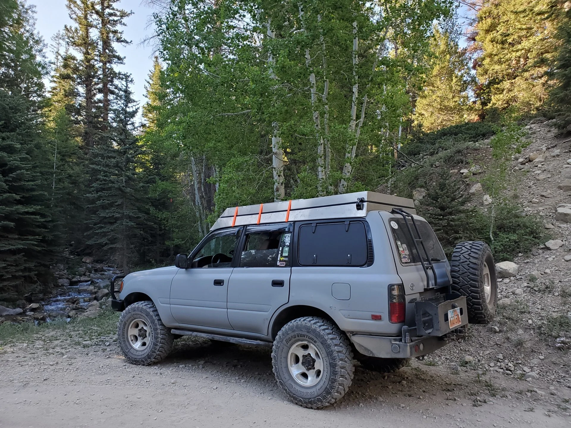

I've always had it in my mind that I was going to chop the rear off and build a camper or something along those lines. The other option was to go with a poptop roof to create some more living space and not have to chop my car in half. Luckily some stars aligned and I was able to drive down to Colorado to pick up a Campteq. So we'll pretty much start the build thread from here.

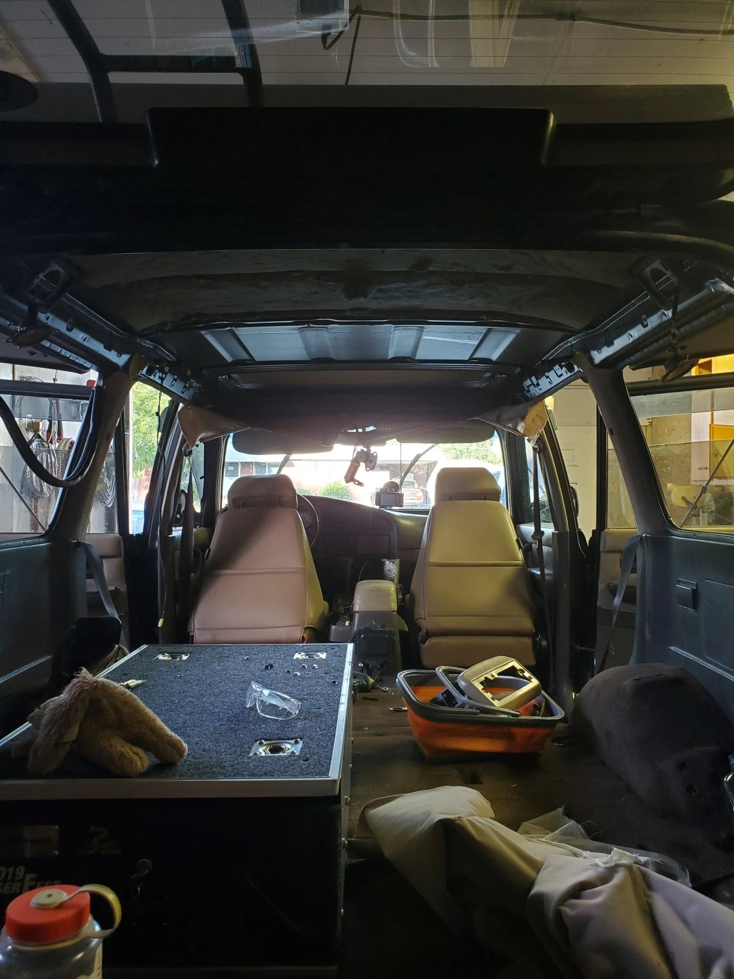

Got the interior mostly gutted. Couple more things to pull out. Eventually I'll be building a full interior with cabinets and whatnot to create a comfortable living space.
My dog was helping with this stage hence the stuffed animal.

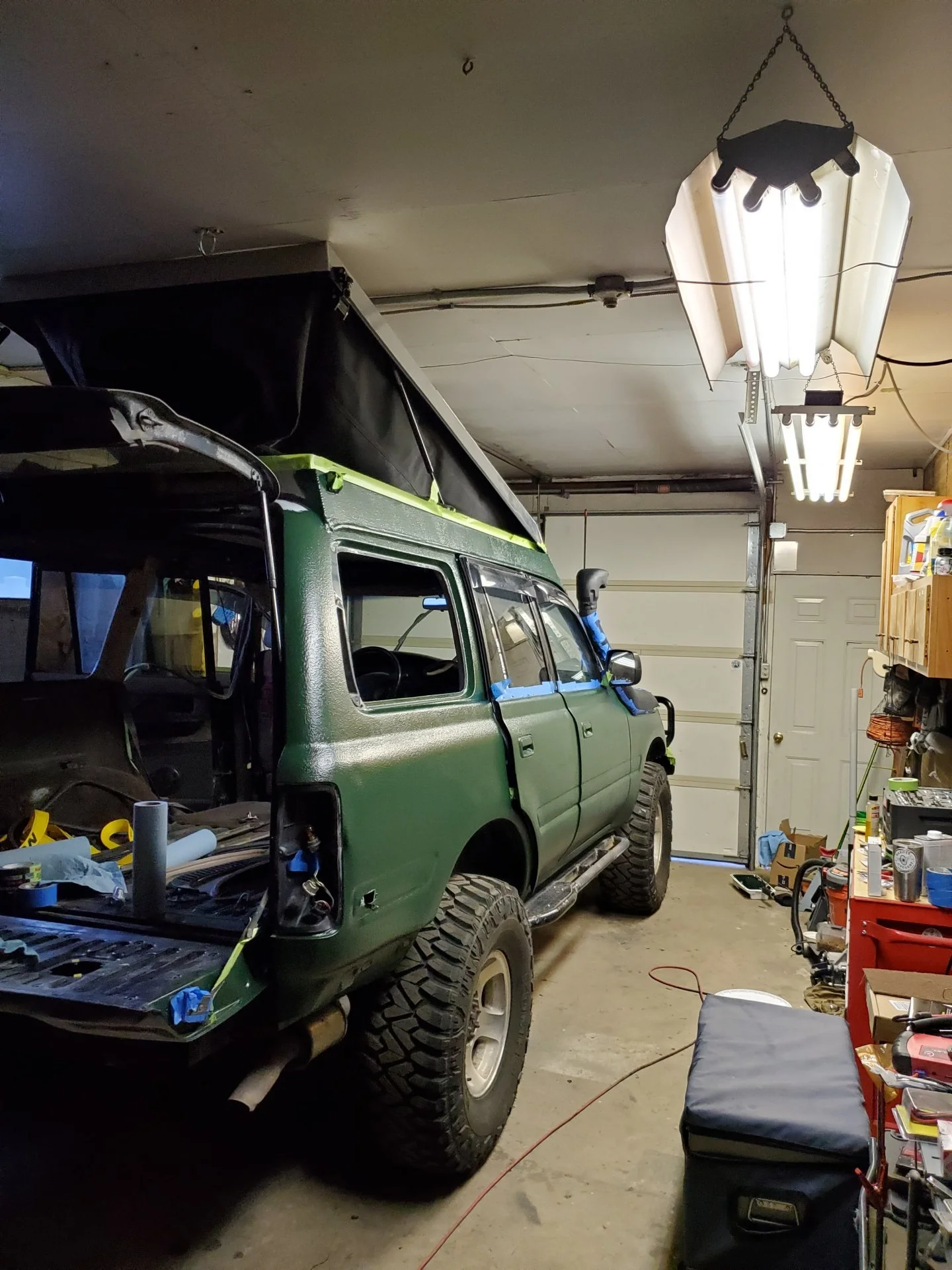

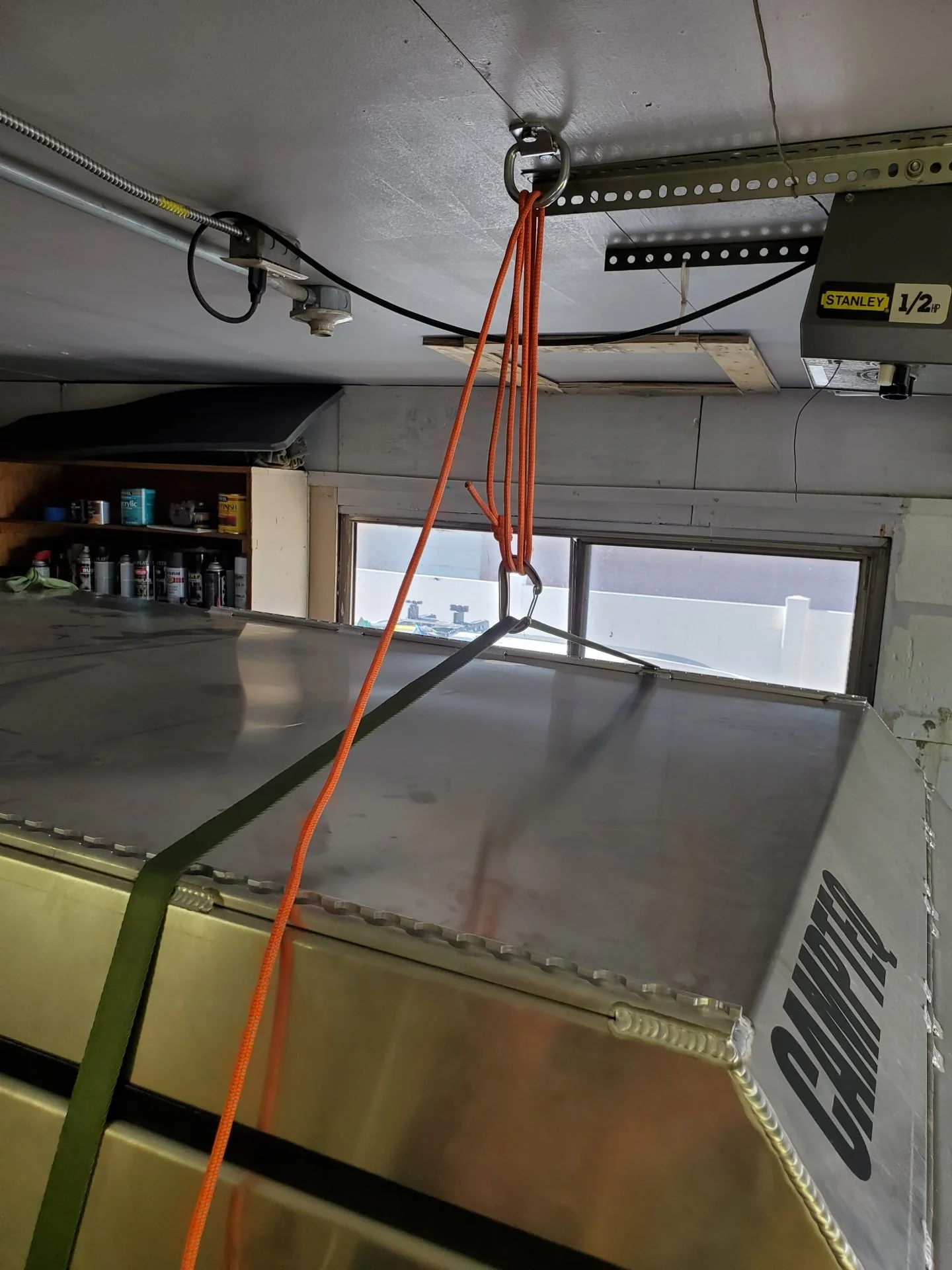

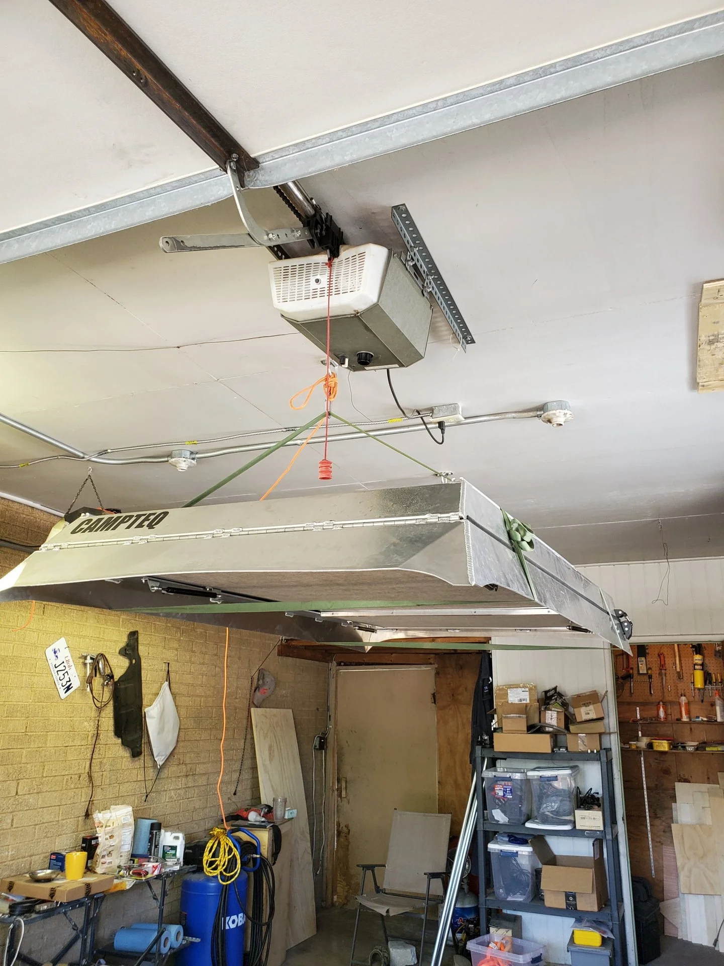

Here we have to top all rigged up up out of the way in the shop. Been working alone so I've had to get crafty using some work related techniques.
A more detailed shot on my lifting technique used to position the top.

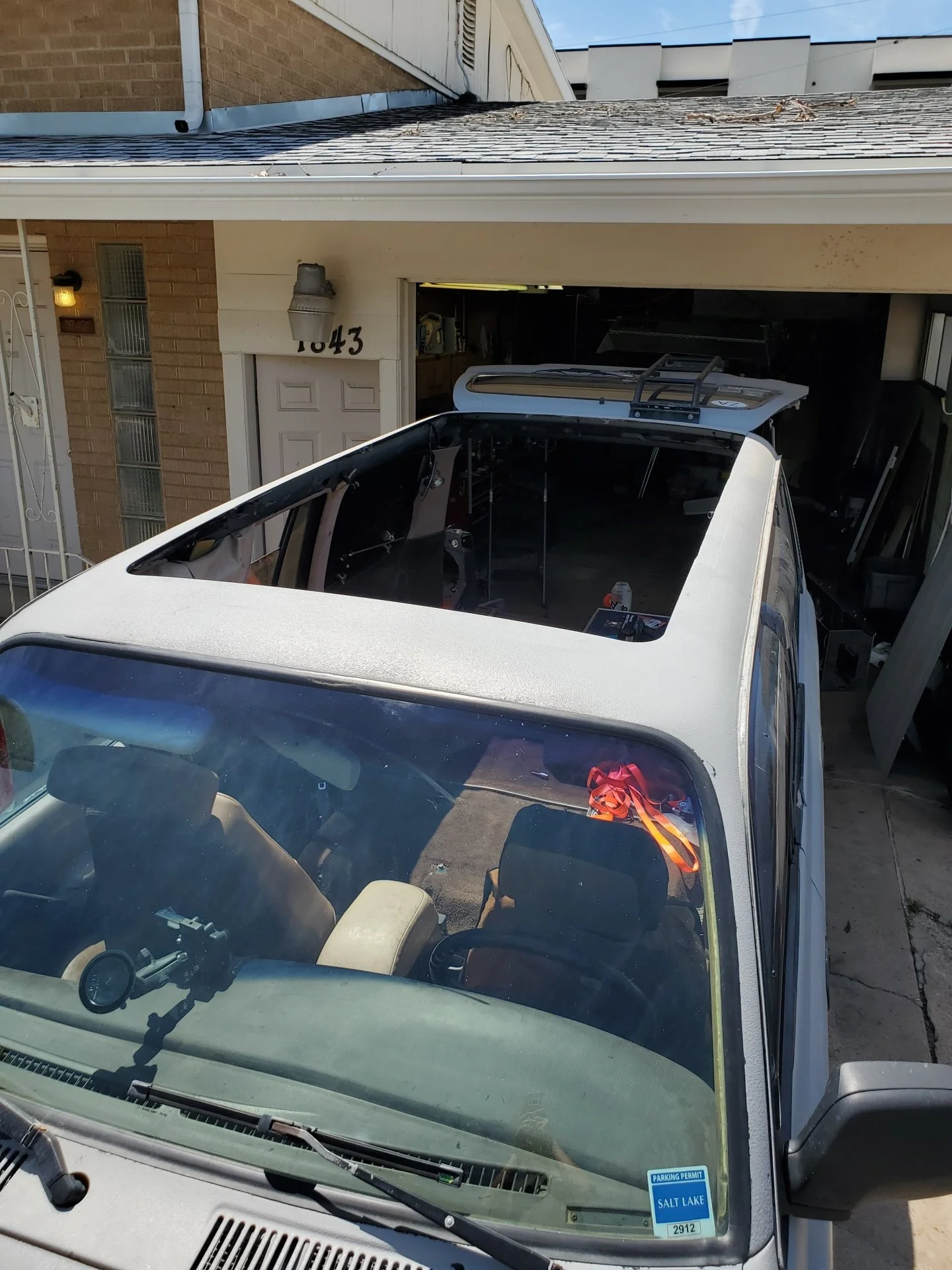

Got the hole cut in the roof. Pretty straightforward. I opted to just extend the line out from the sunroof. Seems like it will mate up well with the top. The hardest part was removing the sunroof. luckily I was able to employ a little help from my brother for this.
I also ended up just removing the headliner altogether and I'll come up with a plan on how to finish that once it's glued on. For now we move forward.
Here is what it looks like with the sleeping platforms folded up. Plenty space for a party. This feature is one of my favourites.

Got the roof and top primed and then had some free time after dinner so we decided to go ahead and glue it down.
Just waiting for it to cure and then I'll get stuck into cleaning it up and then the roof install is done.
Next up will be redoing the bedline in Monstaliners jungle love green.
Started the painting portion of the project. Not quite done yet but it's looking decent so far. Solidly gassed myself out inside my shop.
I used Monstaliner Jungle Love bedliner and rolled it on this time. A little less prep-work needed and it went on nice and thick.
Definitely not perfect but it's no show truck so I'm happy.

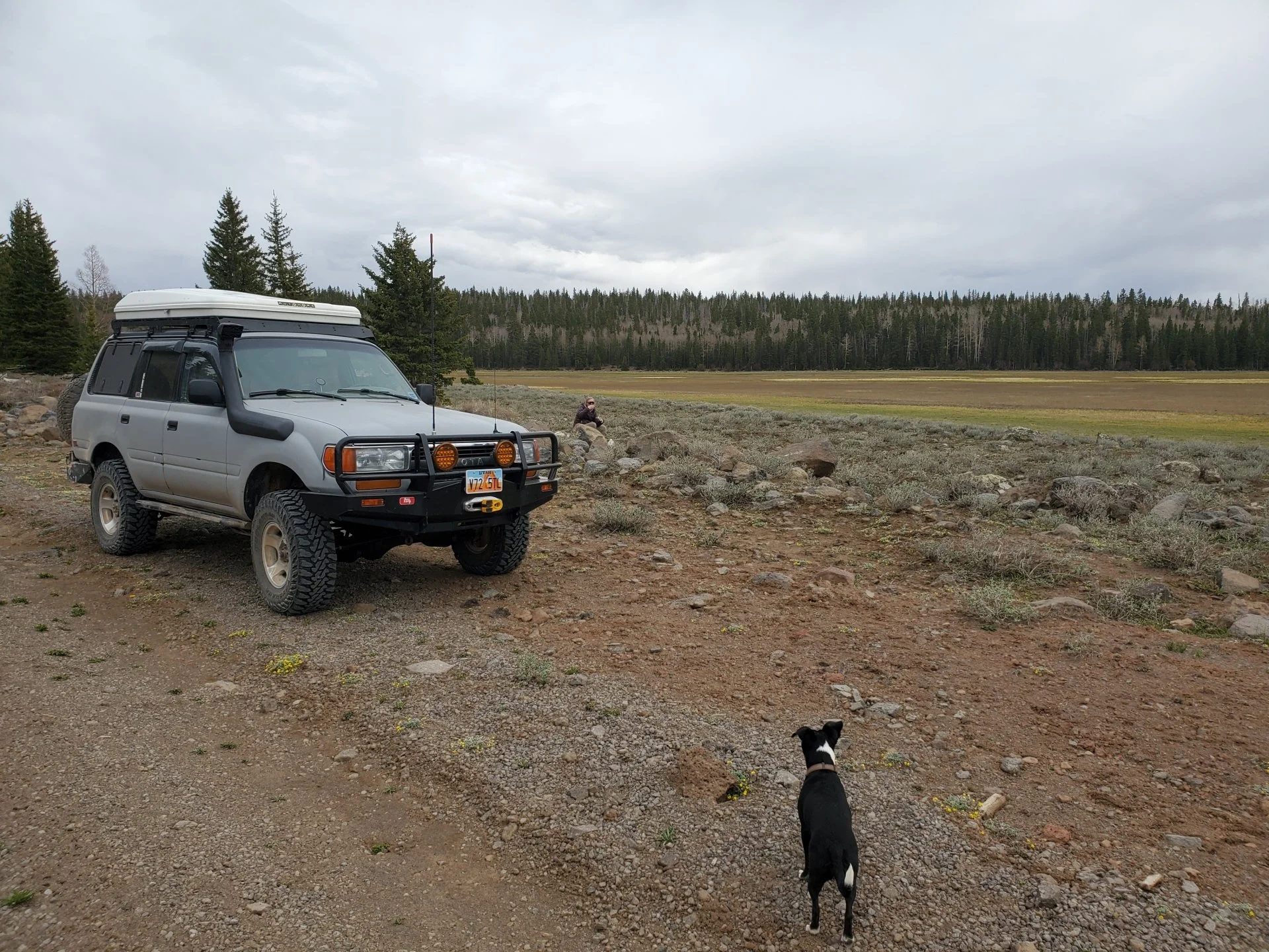

Got some good beta testing in at Solid axle summit. Car works well and feels nice and light. Obviously I'm still lacking a rear bumper which is just sitting in my garage for now.
Areas to focus on next are the interior and then diagnosing some maintenance issues.

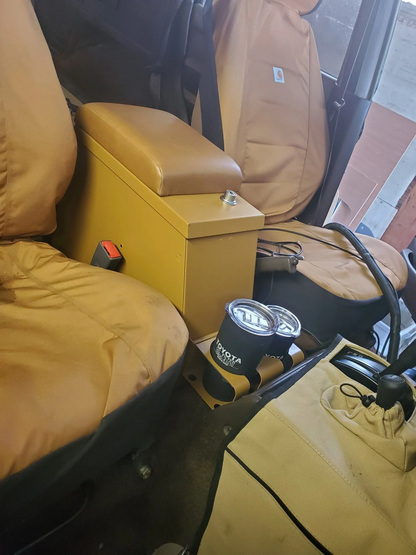

Installed a Tuffy center console. Model number 012-04.
Pretty straightforward install. Used the writeup here on Mud for some guidelines.
Feels nice and solid and fits my goodies that I'm trying to avoid having snatched.

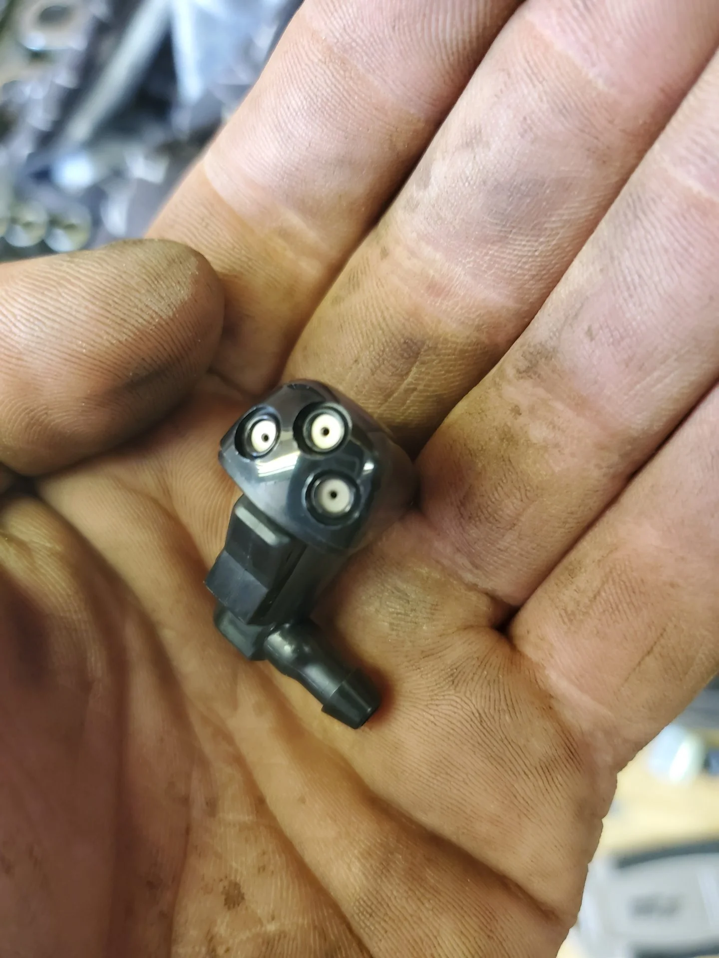

Also got distracted and installed Rav4 3 jet washer nozzles.
Part number: 85381-42070

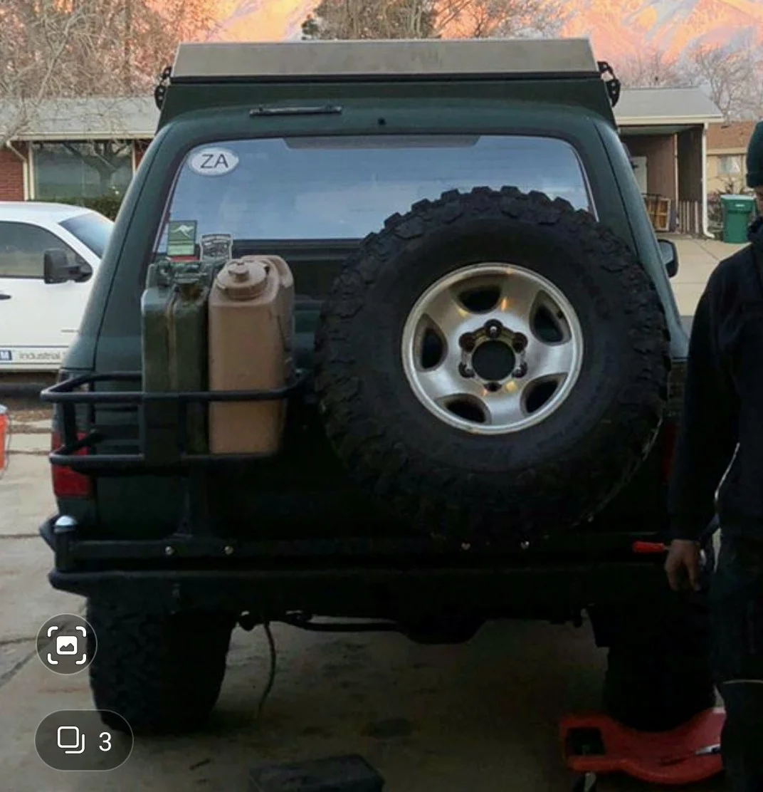

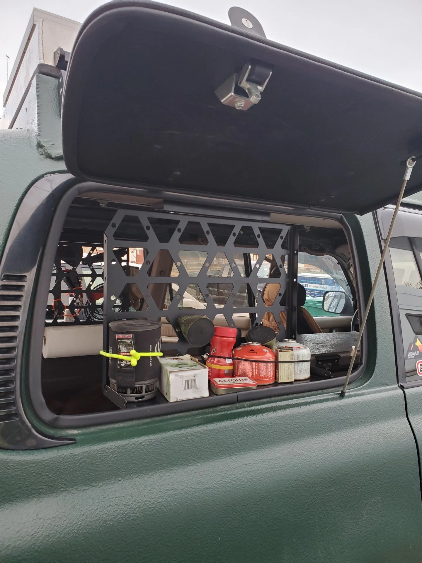

Installed Delta's rear window racks and put together a coffee/drinks shop on the one side and then quick access recovery and vehicle related gear on the other side. So far I'm liking them set up like this. I may end up building my electrical/charging station onto one side.
Next up was the 4x4Labs rear bumper which my buddy kindly welded together in exchange for some parts and beer.
We'll probably add a receiver hitch to the swingout for the bicycles.
Now I finally have a place outside the vehicle to keep the tyre, water and spare fuel.

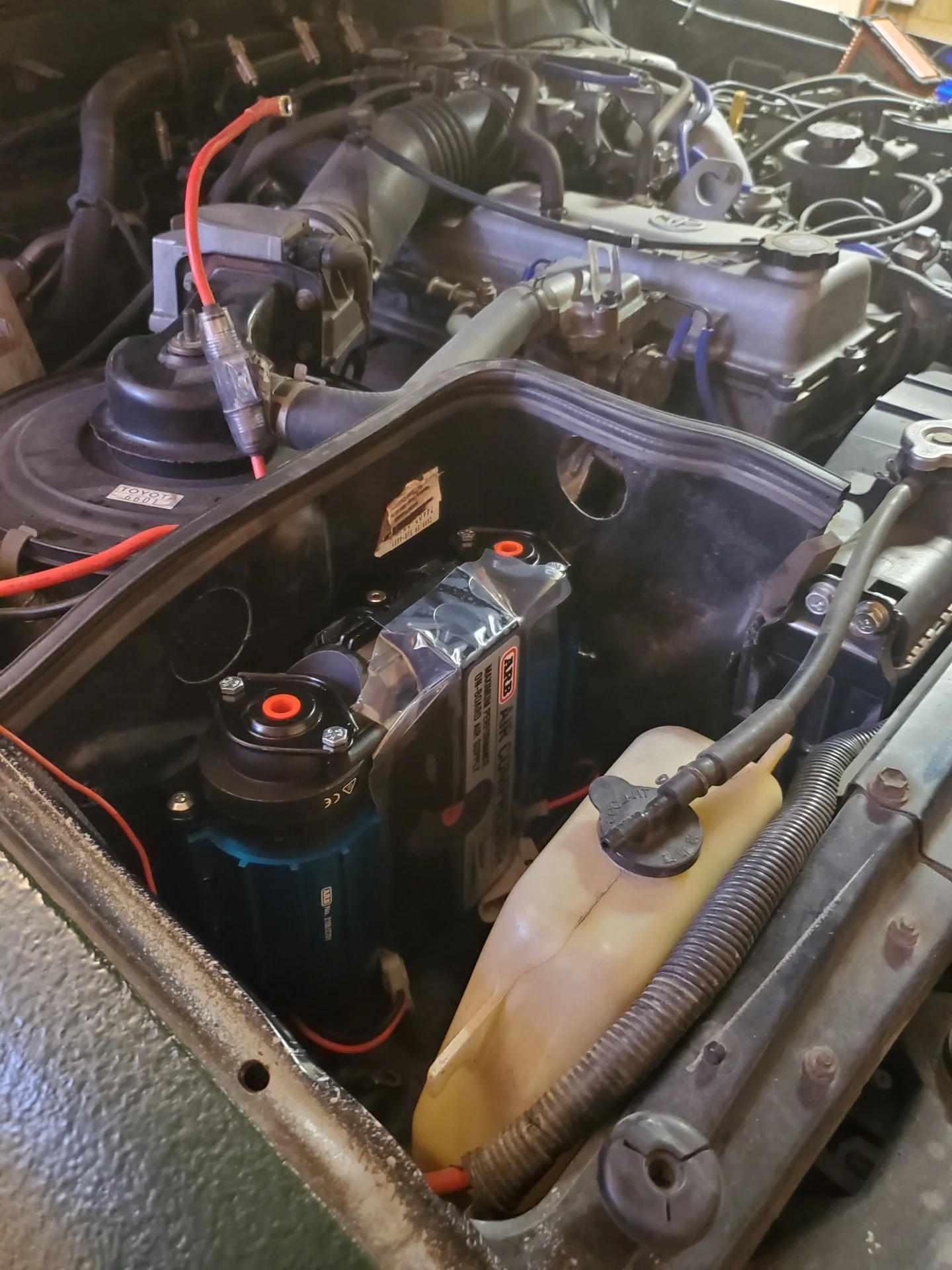

One last thing I've been tinkering with lately is mounting my compressor. I removed the second battery in the front which will go in the back instead so now I have a nice big spot in the engine bay to mount it. Does anyone know of a bracket out there there that I could use to mount it?
If there isn't anything already made I'll most likely just take it to a local fab shop to have something put together.
Here's an example of what I'm picturing for the compressor:
