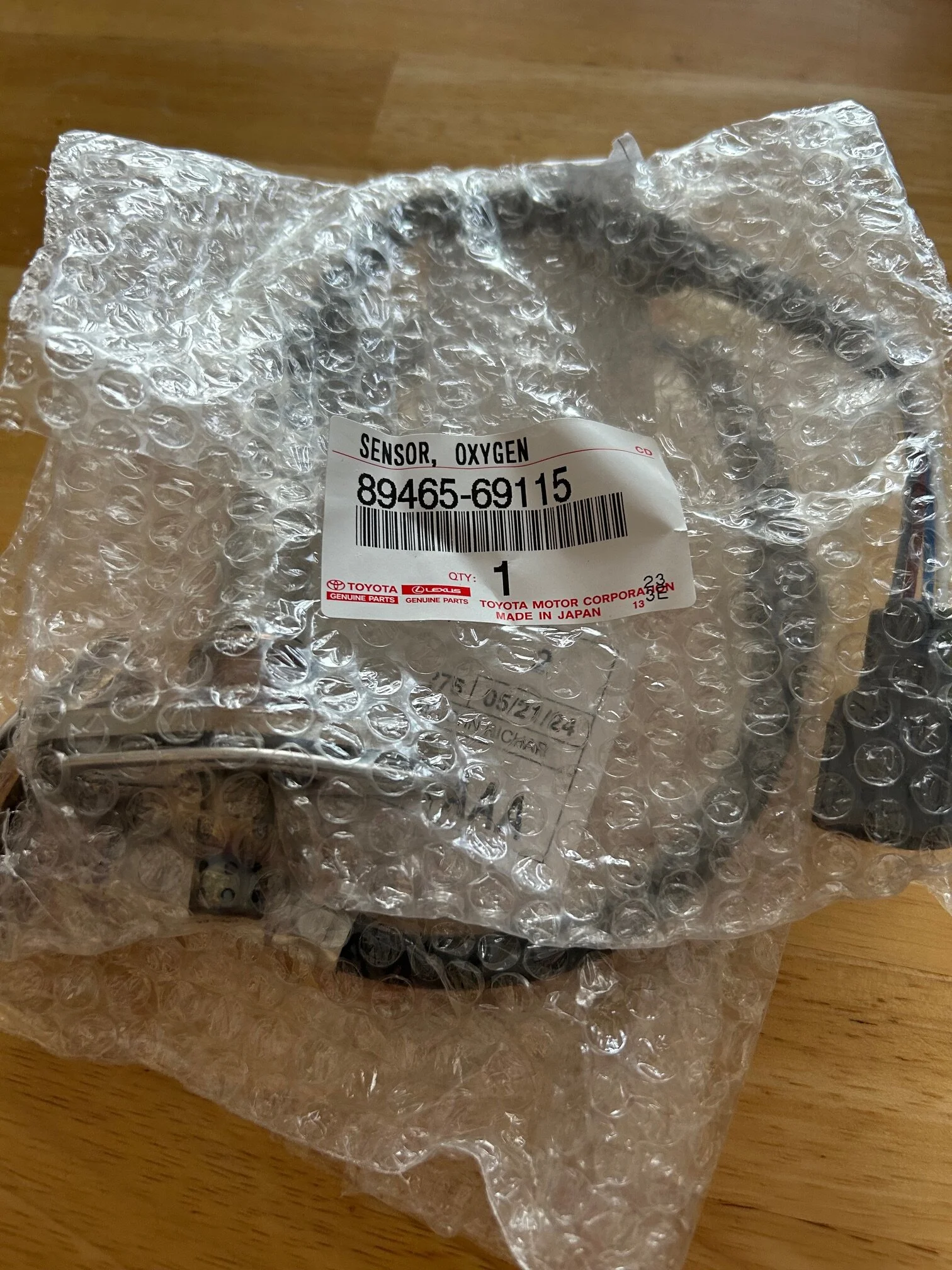

The two new ones I put in (part number 89465-69115) are not OEM/compatible? Would hate to toss more money on parts until I check out the other tips in the discussion.

Absolutely get that. Firing the parts cannon willy nilly isn’t advisable. BUT, if your issue ends up being related to the O2 sensors, I would stick with OEM. I’ve read of too many failures where aftermarket sensors are concerned. They (oem sensors) are still out there and available.

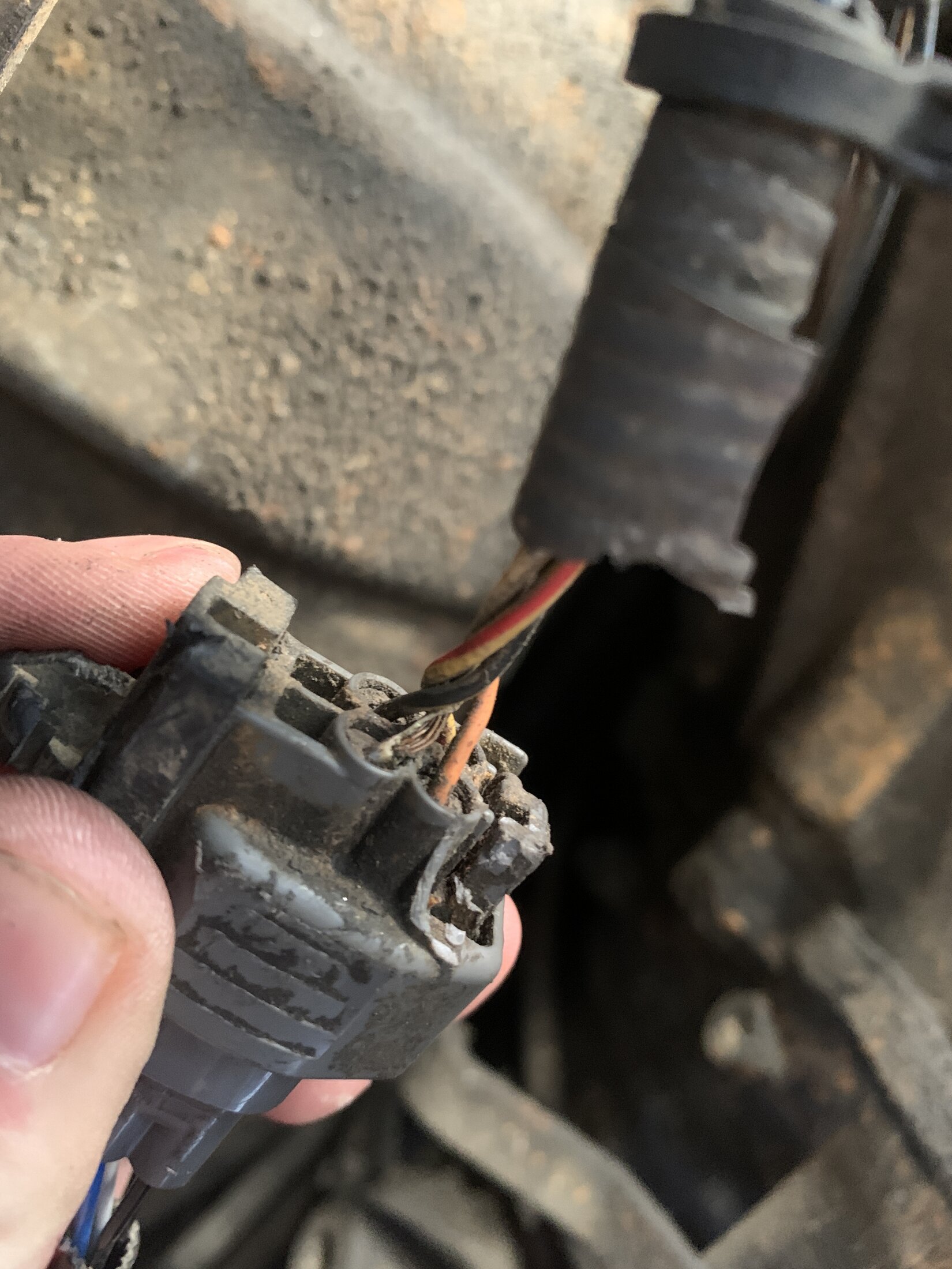

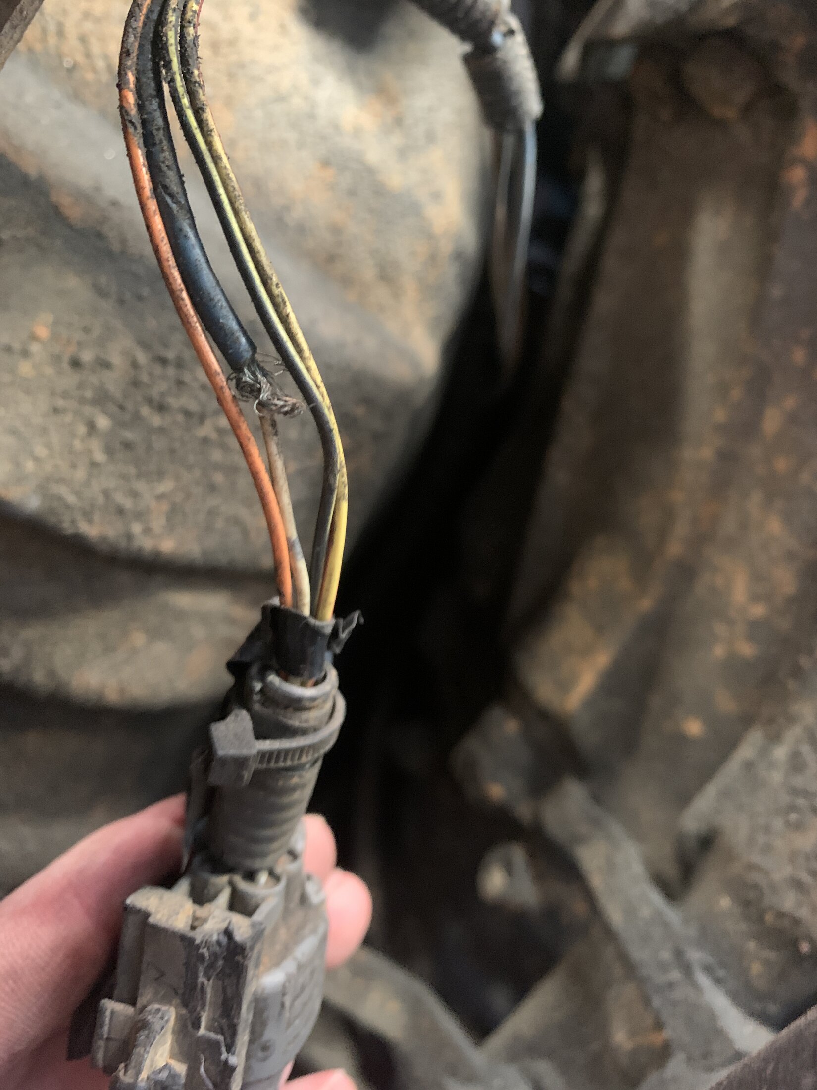

I think I have honed in on the issue. The connection wires for the O2 sensor are as shows, open wires frayed. Next question would be does anyone know where to get a new set of wires/connection? View attachment 3845571View attachment 3845572

If only one of the wires is frayed, I would strip back the covering, solder in new wire and heat shrink a new cover on to it. Those wires have quite a bit of "play".

That sounds like the better idea! Thanks!
look on the plastic housing for the connector number, seach for it in the wiring repair manual listed in the resources section of this forum and then find the corresponding repair wire to order from your dealer. or try Ballenger motorsport

Which 02 sensor has these damaged wires? Curious how that could have happened?
On the sensor closer to the driver side, I had a similar thought as to how it could have happened. The covering over the wires has fell apart so I’m assuming a rock or some sort of debris whacked it good.
Copy that, I ordered a whole new connection housing and wires due to how rough it’s looking.
Just following up on the fix for my original issue!
I bought oem o2 sensors from toyota, they only had the passenger side sensor available so I bought two of them. after replacing them the idle issue is fully resolved.

I would double check your O2 sensors. I went through 2 sets of Denso 95 spec an NTK that was supposed to be for a 93-94 and it still ran poorly. I ended up buying NTK sensors off Amazon that fixed my problem. Check the O2 sensor voltages and make sure they are switching properly.
just wanted to add 2 NTK 24080 o2 sensors worked for me. Plug and play. I had a code 21 with awful misfire and sluggish accel that was getting worse. The CEL went away after replacing the forward one. It still ran poor so replaced aft one as well. Now it runs better than I can remember. I also have them in the PAIR ports and still have a stock EGR set up
