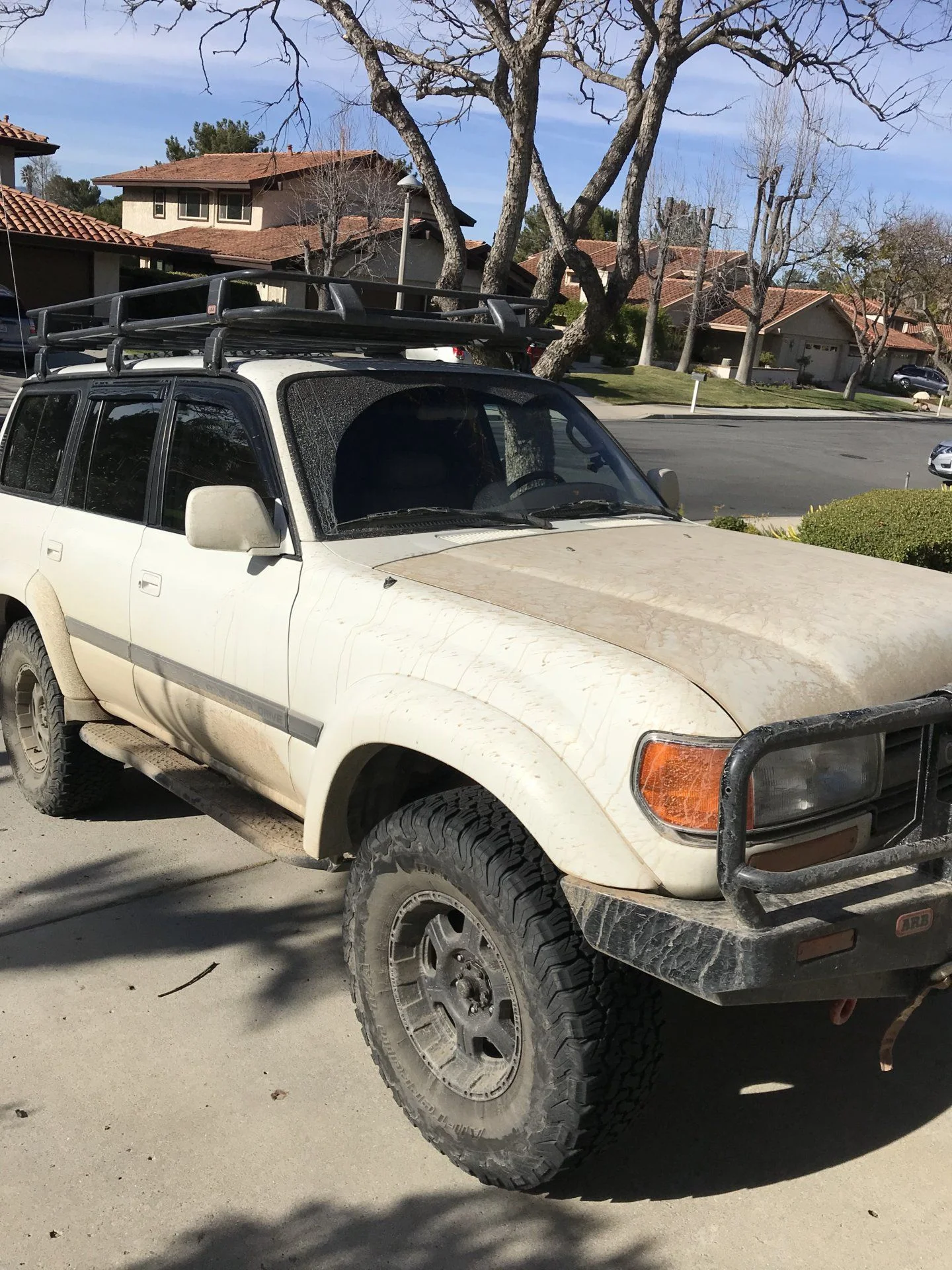

I have a 1997 80 series with an ARB bumper and a warn zeon 12k winch. The previous owner chopped some metal on the bumper to make the winch mount. He flat mounted basically laying on its back. I am not sure about the mount job. As well the bumper had an issue and ARB sent me a new one and i want to mount the winch to the new bumper the best way possible.
