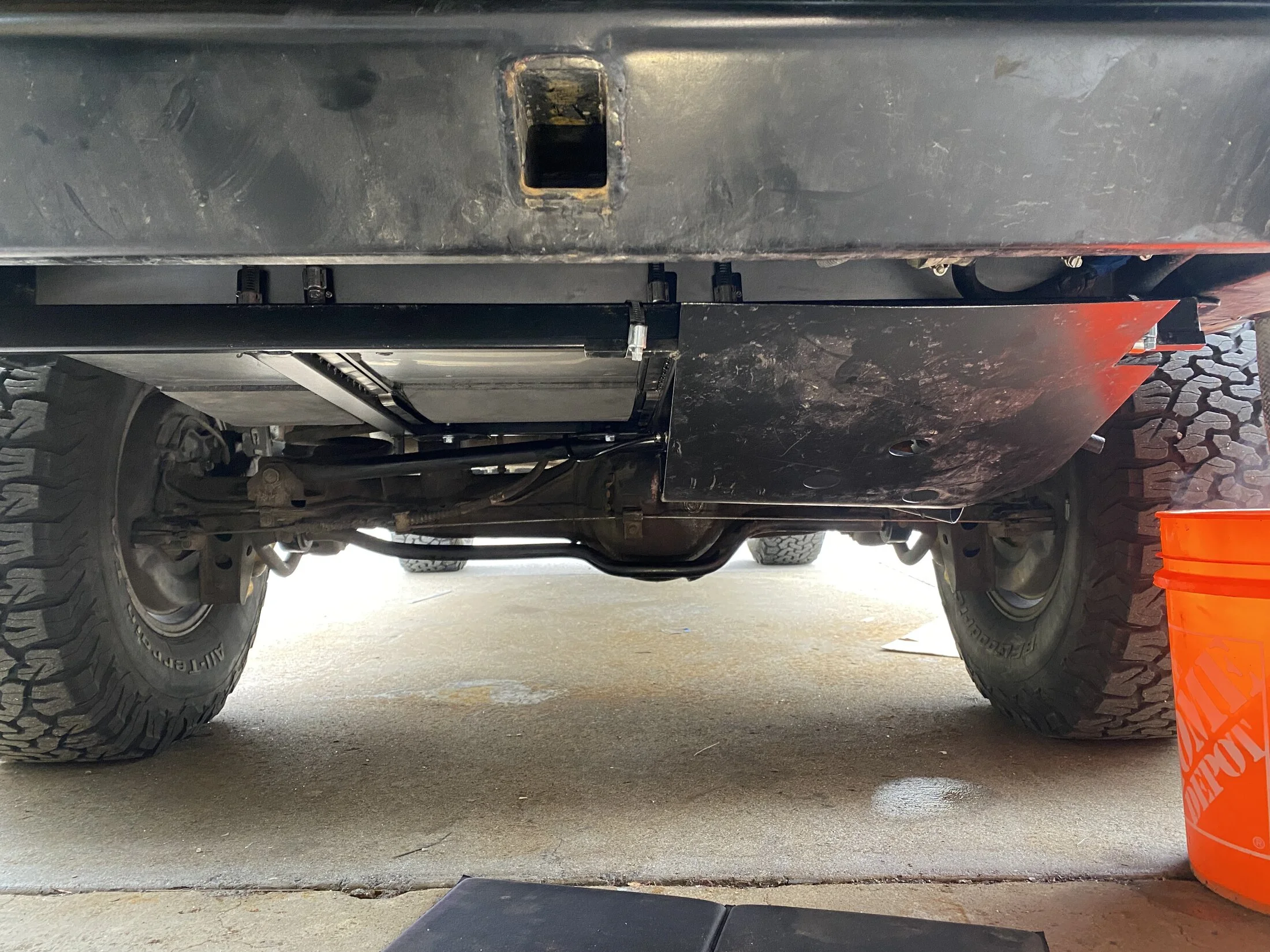

It is getting it from the piping that connected to the rear heater that was under the passenger seat. I replaced it with a heat exchanger that sits above the transfer case. Minimal changes to the stock rig.

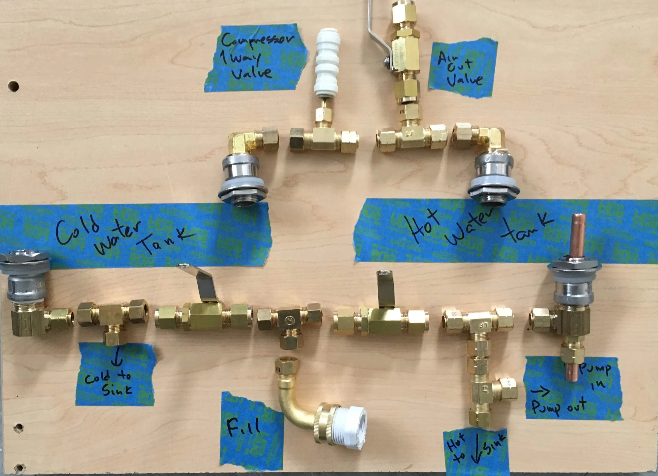

By the way, this is how the water system works...
This is the old fittings with PVC tanks. Currently it's all welded 304.
